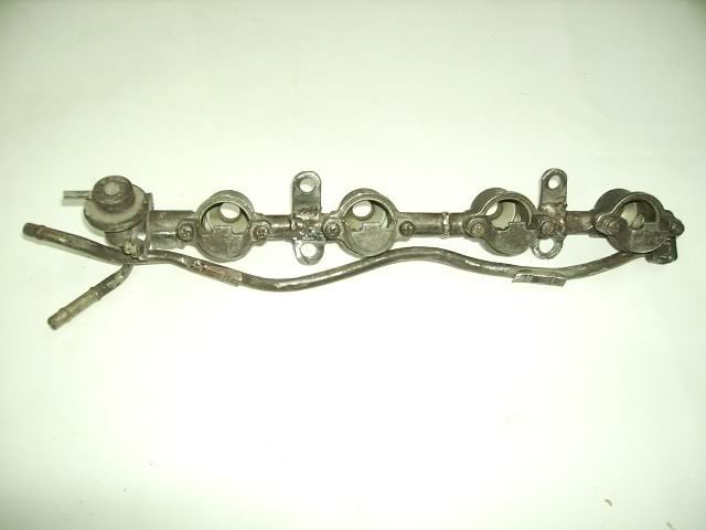

Yes, 370cc injectors from SR20DET engine, same as Pollyp injectors, are enough for 290hp... :laugh:
I got these injectors like 1 and 1/2 years ago, only now i have the fuel rail done. :eek:
