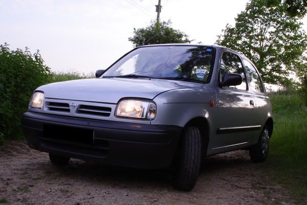

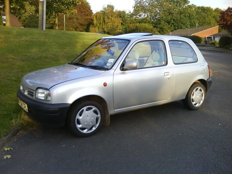

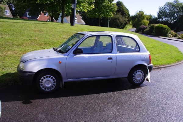

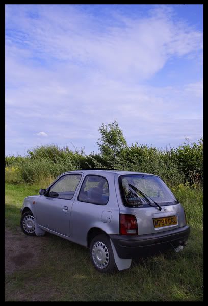

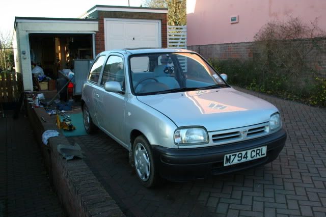

Standard car, back in March:
Good old reflector!!

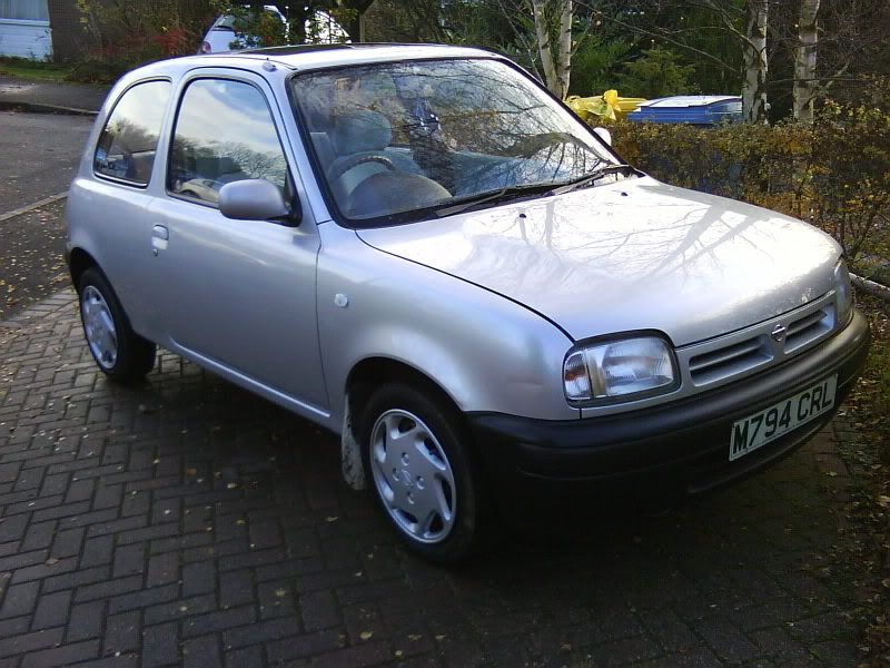

De-bumpstripped and mudflaps added
Sub and rear 6.5" speakers installed. Front door speakers replaced to match rear.

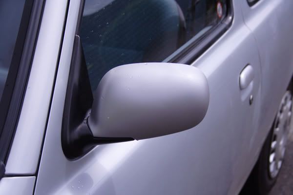

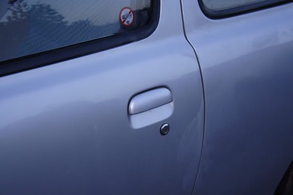

Colour coded door handles, mirrors and boot handle

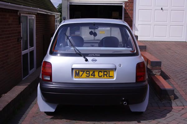

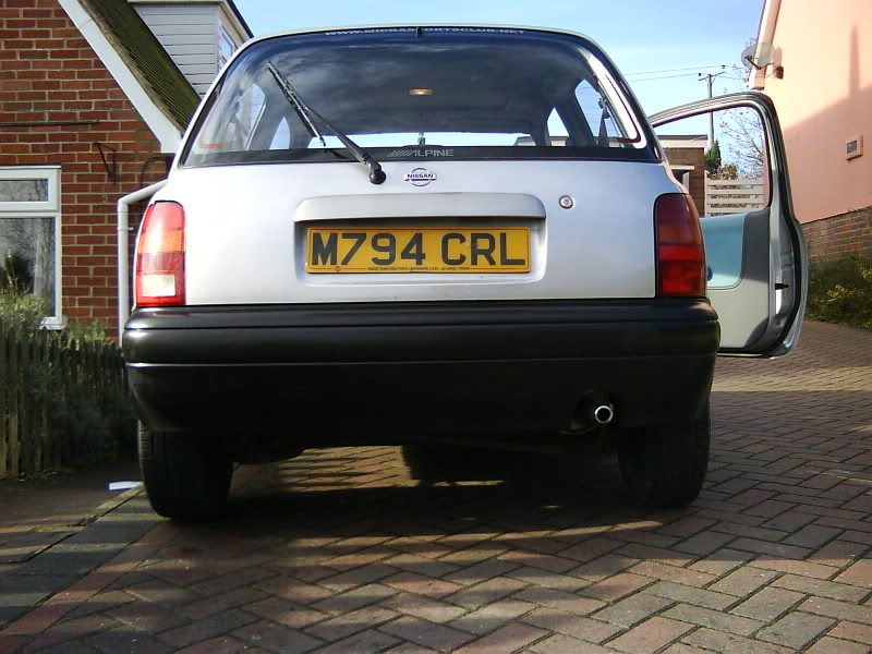

Reflector removed (accidentally!) and mudflaps trimmed!
Stickers removed

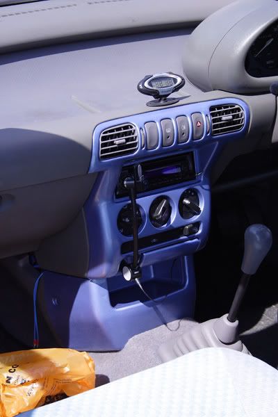

Dash centre sprayed Ford Paris Blue, as well as inside door handles and bits in footwells.

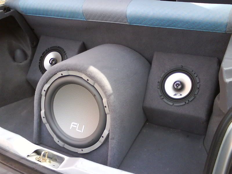

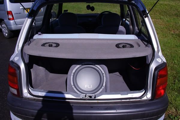

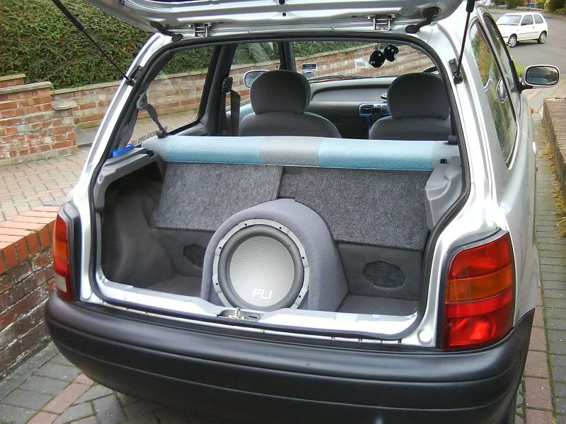

Made speaker boxes for rear speakers, which increased sound quality tenfold! Went to the scrappy and stripped carpet off of the rear seats of 2 micras to make them match! :D There's still space for a pair of 6x9s and 2 amps if needed.
And thats the story so far!
Next job is to convert parcel shelf to stealth shelf! :D
Cheers :D Took me all day to make those speaker boxes. The only thoughts about it (probably it's positioning) is that when you stand directly behind it with the boot open, the small speakers sound really tinny. If you stand just to one side however it sounds pretty nicely balanced. Is that just the way I've positioned them, as they're kind of aiming up? I put them like that so it sounds better in the car, rather than listening to them with the boot open.
Also, any pointers where to get some cheapish acoustic carpet? Halfords looked fairly expensive, although I'm not shocked.

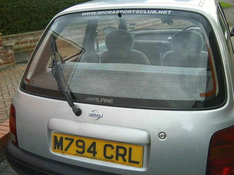

I'll answer some of my own questions... the tinny sound I think was because of the sound bouncing off of the rear window. I put the parcel shelf in and it made a big difference!
Also, found some cheaper acoustic carpet on eBay, 7.30 inc postage for 1.5mx95cm - perfect for my parcel shelf :D Might need a new shelf though, as it split in a couple of places while I was making holes in it :(
Tom
My acoustic carpet came today, so now I have a parcel shelf again! I was nervous parking the car in town without a shelf, but all is well now :D

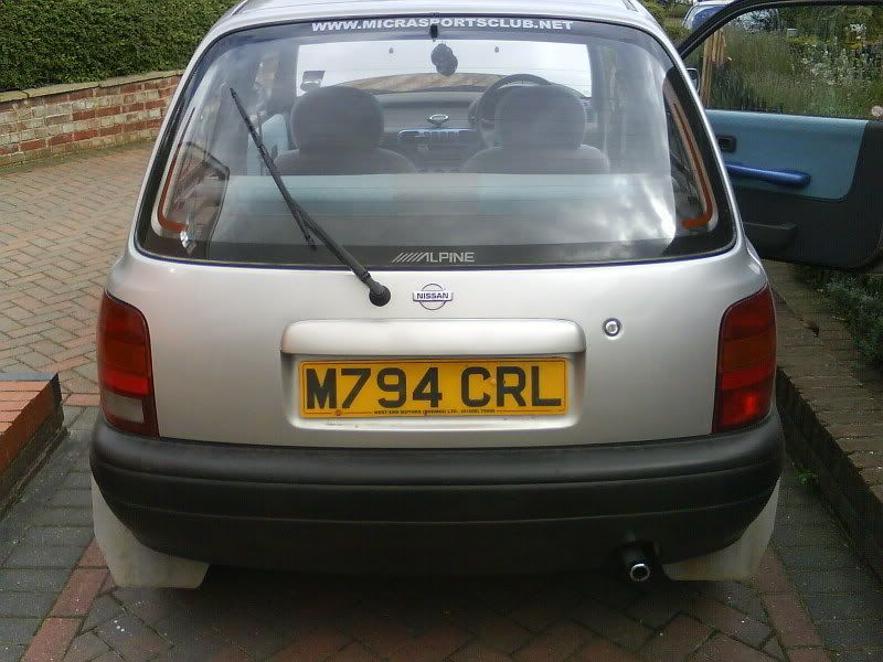

Oh and I've removed the rear flaps! Tried to trim one of them a bit more, just to make it slightly more discreet, but messed it up so ripped the other one off as well!
With those speaker boxes I have made, would I get a better sound if they were totally enclosed, or is it OK that the underside is open and sitting on the boot floor? At the moment there's just the four sides and the top with the speaker sitting in, bottom is open.

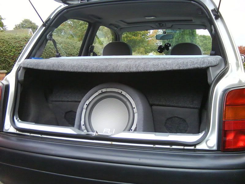

Ive now made the speaker boxes into actual boxes now instead of just "stands". :)
Used up some leftover carpet and plywood and made a couple of new panels to make the boot area look a bit neater. IMO it looks a lot tidier and hides me bad upholstering on the speaker boxes! I plan to do the sides at some point, and also make a mount for the amp when I get it. Also want to re-cover the speakerboxes in the acoustic carpet I used for the shelf and panels, so it looks like a solid box, not showing the speaker hole.
(edit: looking at those pictures its a bit wonky on the right! won't take much to straighten that side out. )

Finally I think I've worked out why my speakers were being so temperamental and distorting. I was re-wiring the rear speakers today, and suddenly I was able to put it up to maximum without any distortion! Had a massive adrenaline rush, how sad! lol
Aaaanyway, I think the problem was where I had connected the Nissan rear speaker wiring to my new speakers. I had put both positive and both negative wires together in 2 little connector boxes and then split each of them again to go to the speakers. Now what I've done is run each wire through it's own connector box and to the speakers. If that's an obvious mistake I'm sorry!

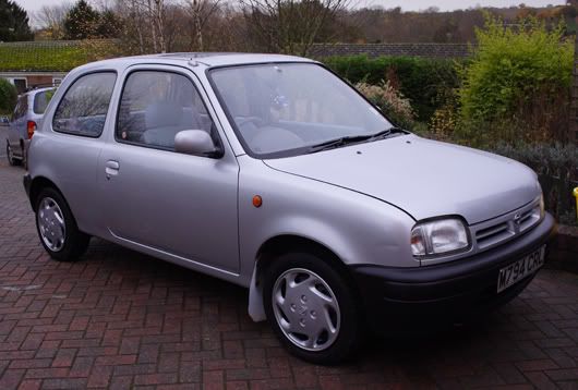

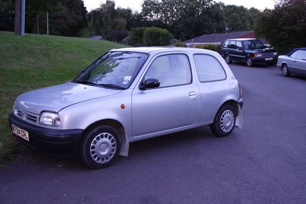

OK I've managed to nick my mum's wheels at last! lol They're 10mm fatter, and much better quality tyres than I had before, as I went and bought economy. Is nice to have proper Nissan trims too, rather than Halfords
boot install look good is that it now for the boot ? you planning on getting any alloys.
n im still going to recommend u the open mouth grill i love it i think it makes the front end look sooo much better
Still need to board the sides of the boot, possibly the bottom too, not sure yet. You can count on mods like alloys and grills by may next year when the insurance drops!! LOL. Maybe sooner though, as the insurance went down by £20 per month since im no longer a student.

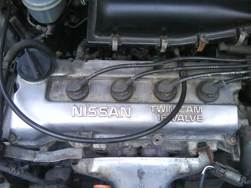

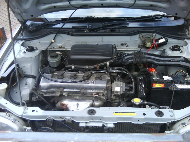

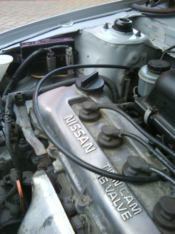

Had a go at the engine bay today. Not quite finished cleaning it, but nearly there. It was filthy before.
Also started to clean up the rocker cover. I'm fed up of it being all nasty. If I remove it from the car to do, will I need to get a new gasket before I put it back, or can I get away with the one I have already?

Loving what you've done with the car, Engine bay wow wee that's clean I have been put to shame, lol.

nah you dont need to replace the rocker gasket..its advised you do everytime you take the cover off, but its not needed unless the old one is snapped or leaks already.

My Rock Cover has been off 1001 times as you can imagine lolol!! and I have never replaced the gasket, the oil there is no pressured, only splash so as long as there are no nicks I would keep the old one. Just Remeber to check round the gasket after a week's worth of driving to make sure its not weaping.

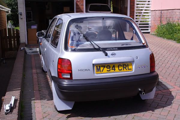

This isn't really an update, just another picture of the car as it stands at the moment. I have sprayed a few more bits inside though, but don't have pictures as yet
I start my new job on Saturday in an Aquatics shop to back up my business I'm setting up (I did fish at college) so it should soon be time to start up some half-decent mods. On the list of things to do is an open-mouth (hopefully Xmas-time), Lowering 35mm, Wheel spacers, Splitters, Removing rear seats, Tints (to hide audio and aquarium equipment), false floor (to stand aquariums on while transporting), and possibly my business logo on the rear side windows.
I'd like silver bumpers too, but don't feel confident enough to do it myself yet
That's plenty to keep me busy and skint for a few years :D

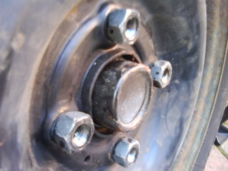

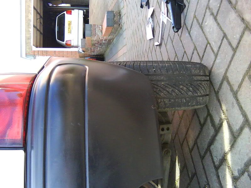

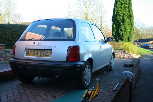

Bought some 10mm spacers today, and just fitted them on the rear wheels.
Before:
After: (on other side obviously)
I know this isn't a very good picture, but it's only my phone!
One question I have though is are these safe if the knuts are like this:
They have plenty of grip on the threads, but they look a bit short to me now. Any thoughts? Also, are these MOT-safe?

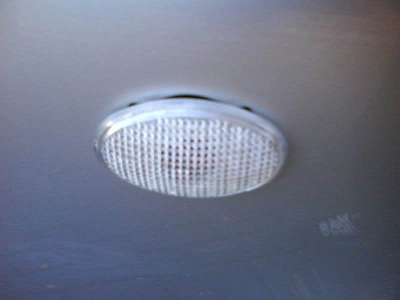

New Side Repeaters today as well :D Only just cover the old hole though. I might put a line of clear silicone around the edge of them at some point just to seal them better and hide the edges of the hole.

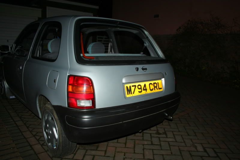

Removed the rear wiper this evening. I bought a set of grommets, all of which were too small. I've just reversed the standard rubber seal and put a smaller grommet in there for now, but will get a bigger one and colour code it on saturday or monday.
Sorry about the picture, it was dark!
Tom

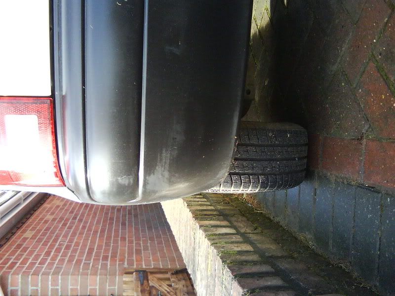

Right I've put the new springs on. Really wasn't all that hard, the worst bit is getting the old bolts undone that have 13 years of rust sealing them together!
Not noticed a massive difference visually, but they seem a bit stiffer when driving.
Also, the side I did first is maybe 1cm lower than the later side. Is that just the springs adjusting? I've heard they take time to settle, but wondered if it was still the same with second hand springs?
I've also switched the water squirter to work off the rear jet as it won't be needed now, and now just need to re-plumb the front ones in so I can have a clean window again :D
May get pics up later and see if I can see how much it's dropped from an earlier pic. Should have done a before and after really.
