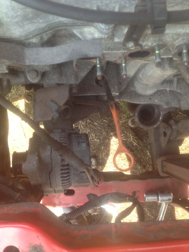

You can see the gap which I need belt for and bracket that's where I want my alternator to be so turbo fits

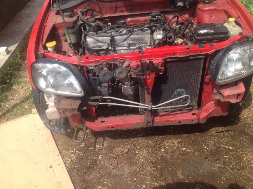

my turbo is laid out hung below the mani,
cold side towards radiator,
hot side towards alternator,
using aircon version alternator brackets which lifts the alternator higher up to clear the turbo elbow,
additional upper bracket to move the alternator clear of the turbo and held static,
using an aircon version belt tensioner between crank pulley & alternator to apply tension,
finally I had to test afew alternator belts to get the right length to fit correctly.

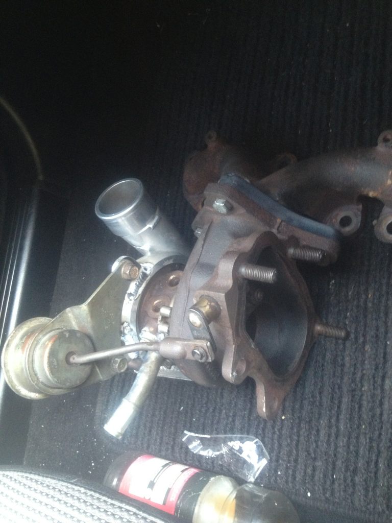

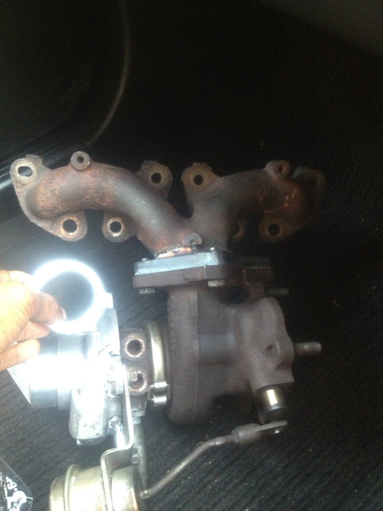

you did,nt "test fit" it like i advised, before welding the flange and actuator mounts then mate ;)

Polly it's touching the block under the dipstick , it's my turbo housing plate which it hits that block needs 1 inch cut that's all polly, and my car is t reg no air con, I can pull alternator down and make bracket to fit? Then I need a custom longer bent?
and that exhaust elbow will have to be custom made eh
Thanks for telling me before frank I should have marked it with black ink rather then took a guess and welded it
i cant see any elbow flanges on ebay atm mate, there are some scooby elbow,s, but they point towards the bonnet tho :)
bonnet exit screamer maybe ? :cool:
and just bust that alloy webbing off eh, it does,nt do much
