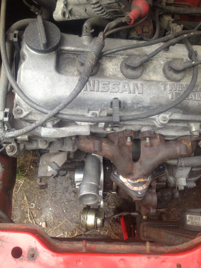

Here my mani that I made
Even after making this manifold, and test fitting and measuring, I found that I needed to tweek some (with big trusty hammer) stuff for the turbo to fit

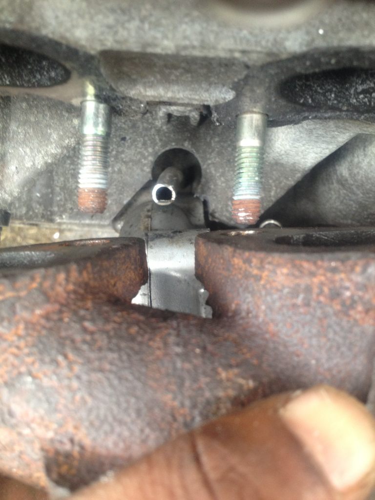

Polly it's touching the block under the dipstick , it's my turbo housing plate which it hits that block needs 1 inch cut that's all polly, and my car is t reg no air con, I can pull alternator down and make bracket to fit? Then I need a custom longer bent?
polly I grinded it as u can see and now it sits fine but what do I do abt the elbow fitting ? and wiring a s14 maf
Azzydot, F--K me man didnt you measure here and there for the turbo clearance, i mean its all too close to the block!!, does the dipstick fit properly, i.e. does it foul anywhere on the turbo, what about the elbow, is it gonna be fouling too? id say forget about the S14a maf for now and get everything to fit up without fouling and worry about minor things later! looks like your trubo is water cooled, is there space for any banjo water connectors to fit to the cartridge housing of the turbo to help cool it? also oil pipes from cartridge to the oil sump?
J
No frank did tell me to check and tig it in place but I didn't just welded it and now I had to cut 1 inch for turbo to fit in place, can that cause any damage to turbo ?
well no damage, but in the long run bad running for turbo in the sence that the cold side is very close to the block meaning that cold will turn hot, the block gets really hot doesnt it? so aluminium get hot quick! so where as you need cold air flowing from intercooler to throttlebody it may not be that cold thus losing power? correct me if im wrong !

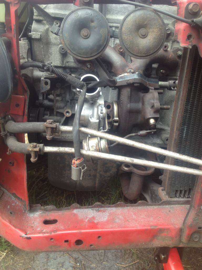

Just had another look Azzydot, you have the turbo in that position, and the alternator is in the way, i cant see how your gonna fit an airfilter to it let alone the alternator being there.......
Double check for its clearance

ok, like i did, just sit in front of the car and measure out distances for the intercooler pipes and how you want to route it and what size airfilter is sufficient enought to fit in the tight space and get whats needed, these are obstacles your going thru which i had majorly with my intercooler piping and ive overcomed that so its rough patches at the moment! lol :) the brackets, the ones i use are aircondition brackets which raises my alternator higher and works wonders, i reckon those are your best bet!!! i know it maybe expensive but go to Nissans dealers and get some quotes on the brackets and tensioner!!

Yes that's what am doing am gona take rad off so it's more easy and put alternater on today so I can see what is what, am thinking of t30r turbo set up next
My model is 1.3 no aircon and I can push it lower for turbo to clear it, then I need a longer belt and a custom bracket ? unless there is other way
ohh sorry stani yours is different but turbo is same ? Did u have longer belts and altnater brackets ? Any pics
Yeah just the turbo that are the same, your altenator looks like it has no chance of fitting. I packed my top mount by about an inch and used a longer belt

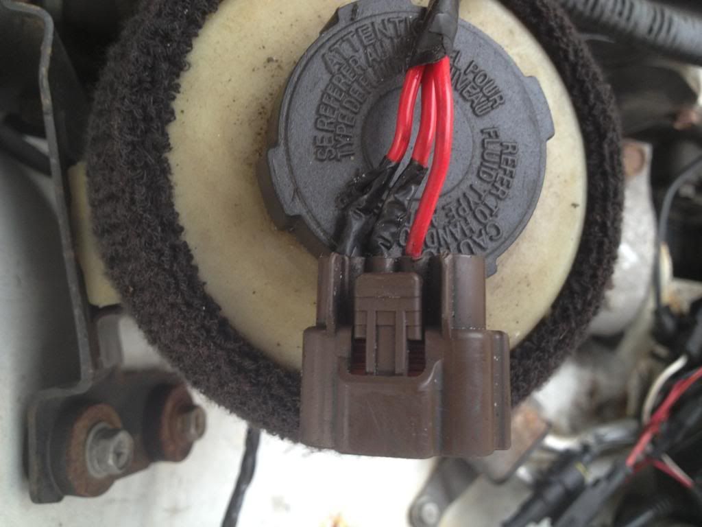

Stani, i am still waiting for the 200sx S14a MAF wiring diagram to the throttlebody plug!!! :D
Well thats because i forgot....
So ive just done it there lol
In the above pic you can see where ive put the wires leaving #4 empty:
#1- Green
#2- Black/White
#3- Green/White
Azzydot, go and check this link below, the right hand side picture has the brackets for the alternator that has A/C you can compare both pictures!! go donw the page and there are part numbers to the bits needed, jot them down and call up Nissan and find out some prices!! that should help you if you go into any complications to the alternator section of your car!

using the aircon bracket to lift the alternator wont help tho J, he,s already had to cut the block away behind it (for clearance)

the numbers 1, 2, 3 are from the 200SX maf or the micra maf?
like :
Micra T/B plug number 1 - 200sx Maf - Green
Micra T/B Plug number 2 - 200sx Maf - Black/White
Micra T/B Plug number 3 - 200sx Maf - Green/White
am sure that is right above stani?

Its really simple, the plug in the picture is the 200sx one. If you look at the way the plug is facing in pic ive used the 3 right hand pins. So put in 3 long enough wires, furthest to the left goes to the green wire on the micra plug, middle goes to the black/white and furthest to the right goes to the green/white
SHWEEEEEET, got it, didn realise the numbering to what plug!! but understood!! CHEEEERS Mate!!! will make up a lead tommorow, just to get it all ready!!
