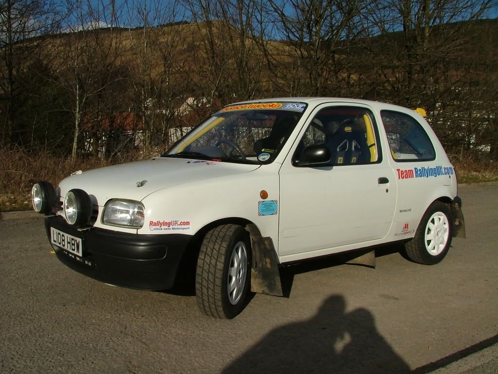

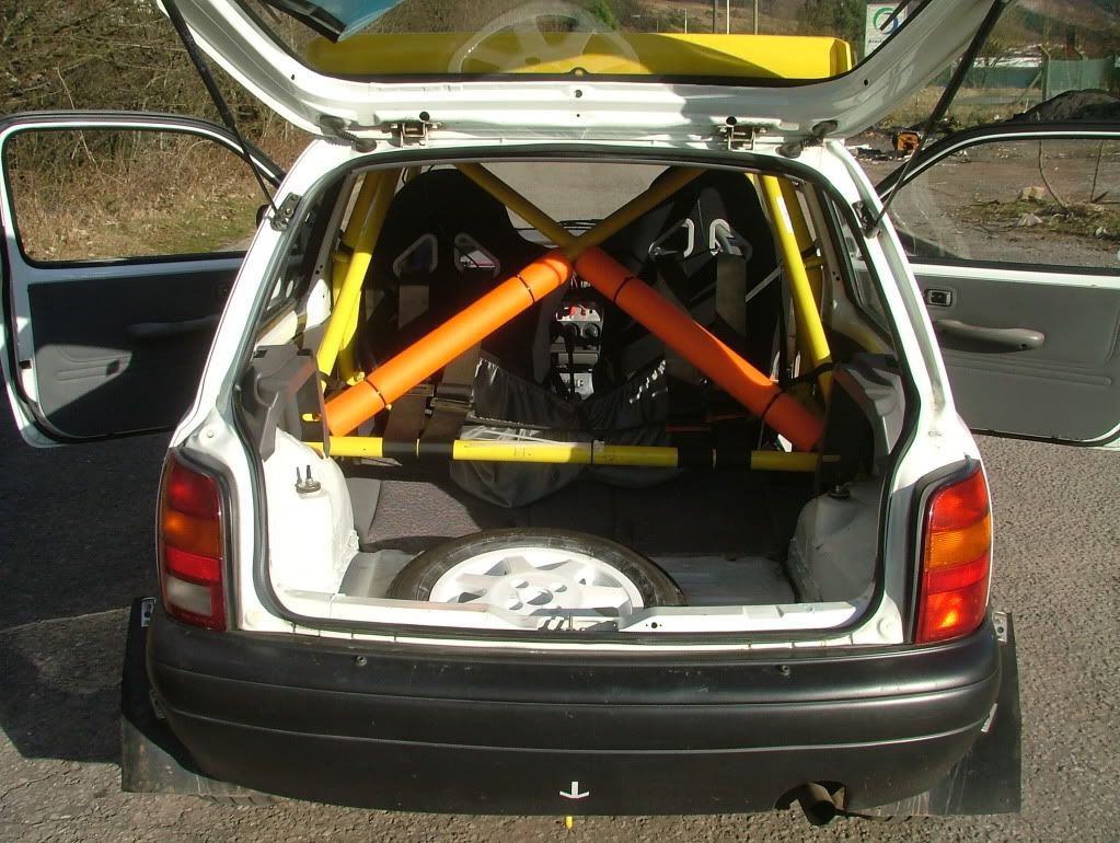

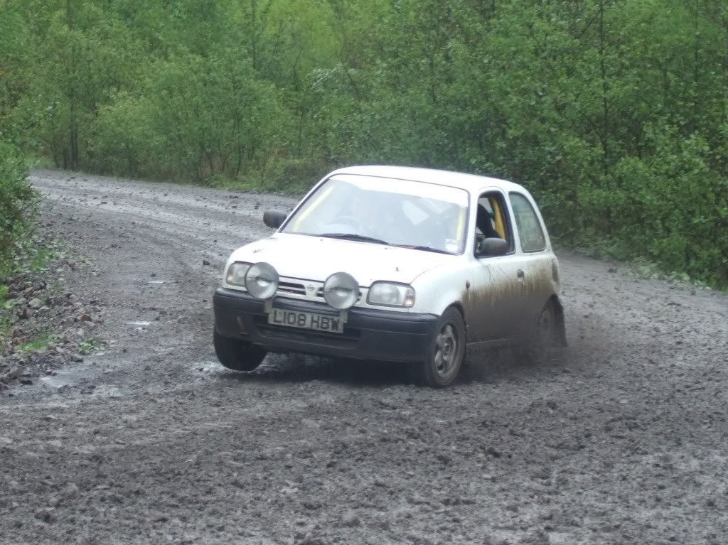

some photos of my rally car.
thanks mate.

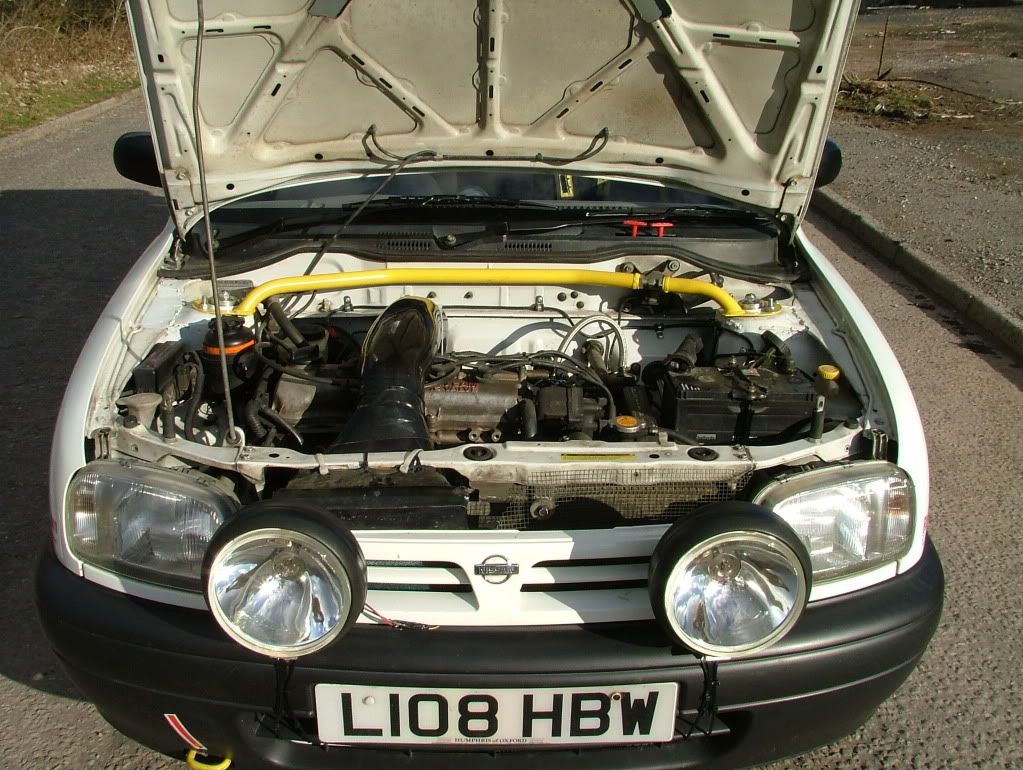

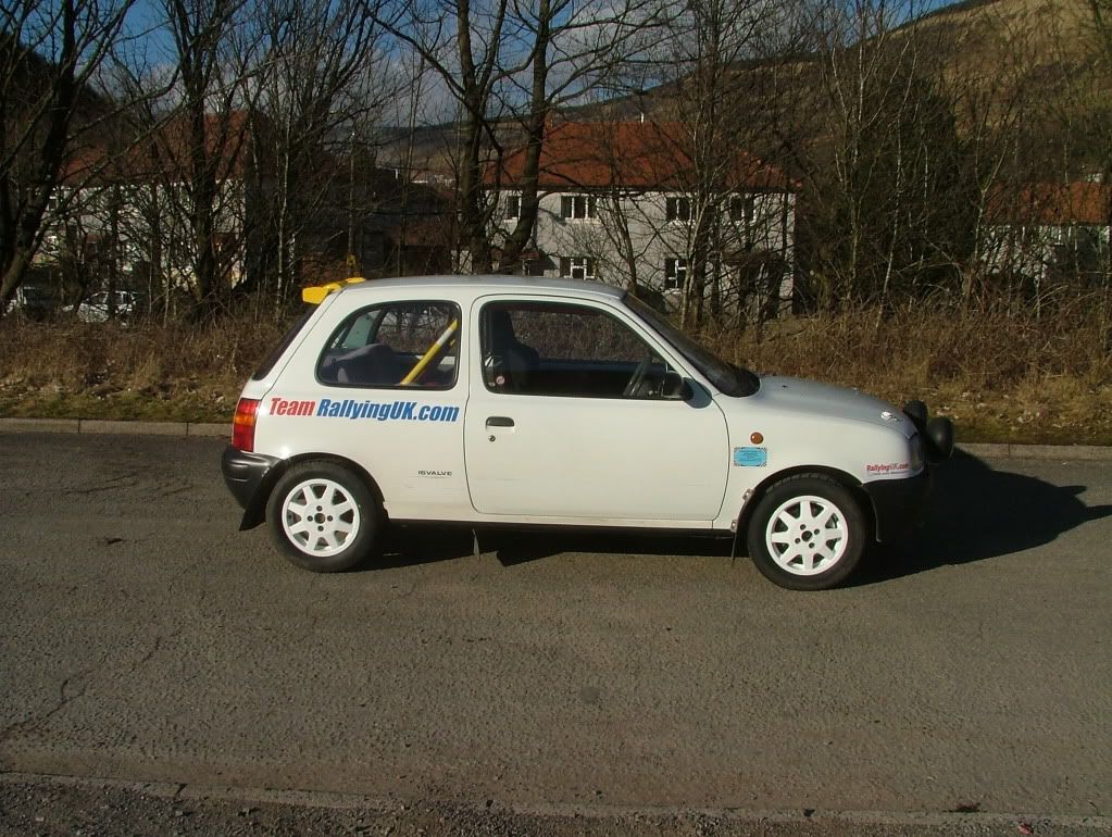

its got micra challenge cams, grp a airbox, std 1.3 box with 5:1 gripper limited slip diff cant think what else at the moment
these are photos from last year just after i baught it and after id made it road rally spec. i also removed the stickers and spoiler.

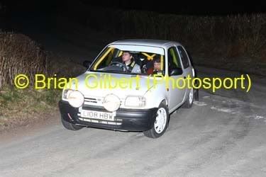

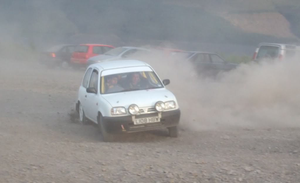

competing on 1000 lanes rally 2009.

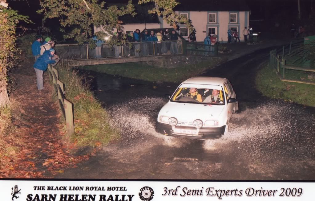

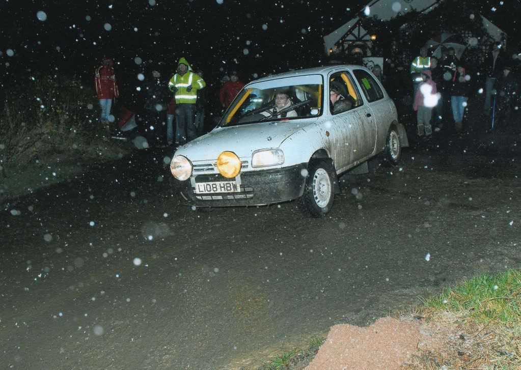

were out competing on the 1000 lanes road rally this weekend, 3 laps of walters arena then into the lanes for the night section. the micras going great now its got a new std box (thanks to matt humphris for the box and the knowledge of how to put it together, i was totally baffled about why it wouldnt fit until someone pointed out the final drive was different to my original one) and new paddle clutch cant wait now :grinning:

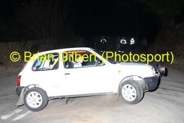

we had a great day and nights rallying yesterday we finished 9th overall and 1st semi-expert. the micra was awesome never missed a beat even when we went through a ford and the water was over the bonnet.
this photo was taken by my friends caron and huw of us in walters arena
im thinking of building a new engine for my micra with hopefully more power. (currently has about 110bhp at flywheel not tested tho)
can anyone tell me how much power i could potentially get out of a 1.3 engine if i throw enough money at it eg, re-bore, throttle bodies etc?
or who i should talk too?
thanks chip
Matt H (MPH on here) is the best person to talk too. You cant re-bore, you could put a 1275cc engine head on a 1348cc block to keep the same set up to get more cc. light flywheel, steel crank & new pistons, and a ported head with a set of cams. 140bhp id say.
Why can't you re-bore? If you use high comp pistons you have to re-bore as the pistons are oversized :p
I figured it was a restriction or something perhaps. I know we go to 71.5mm on the CG13 with new pistons, so still some wall left.
took the car to mosleys garage in llandeilo today to put it on his rolling road.
first time he run it up it had 109bhp at the fly/ 88bhp at the wheels.
he then changed my std fuel pressure valve for an adjustable one and run it up a couple more times
eventually after a bit of adjustment it was 116bhp at the fly/ 95 at the wheels so im pretty happy with that
