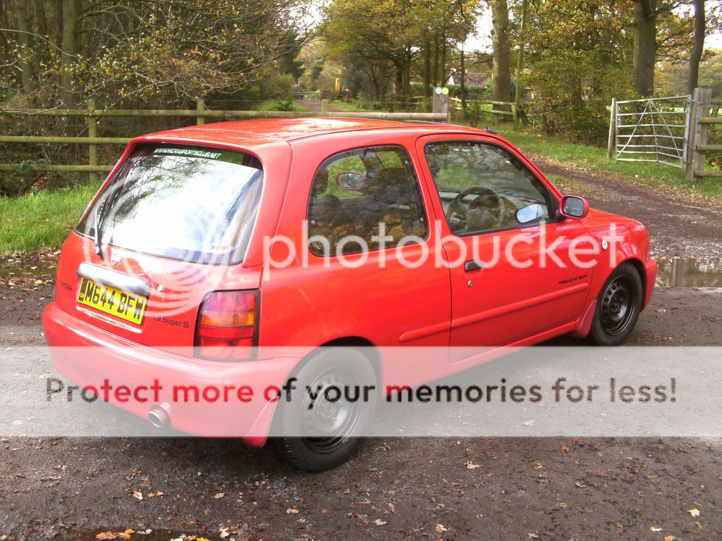

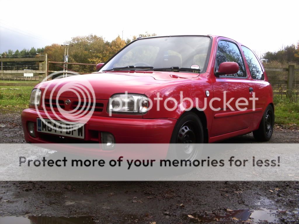

My 1.3 Super S
Very clean, nice SuperS you have. Any more mods planned?

Car looks great :grinning:
Thanks buddy!

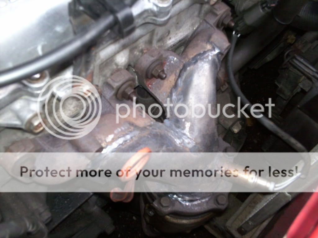

Took the car over to Franks, to get my frankspeed manifold. The removal was all good, not too many rusted bolts however when he got to the lamba we had to wack out the hammers and spanners. Once fitted I took it for a spin. Coupled with my Janspeed downpipe you can feel the difference. It has improved low down - midpower and when you get to about 5000 - 7000 it has a sudden surge of power. I definetley recommend one of these, cutprice but deliver the same gains as a janspeed manifold.

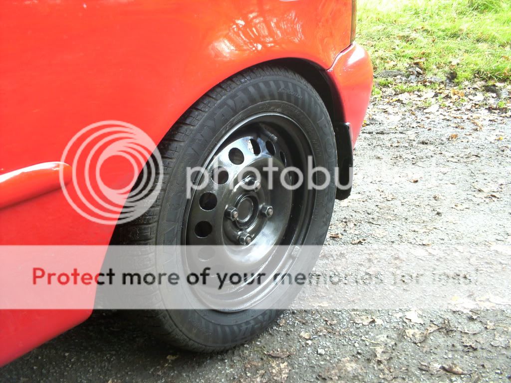

Frank was also kind enoiugh to space my rear wheels, it has made my car look so much better.

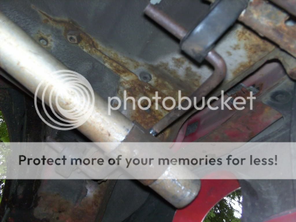

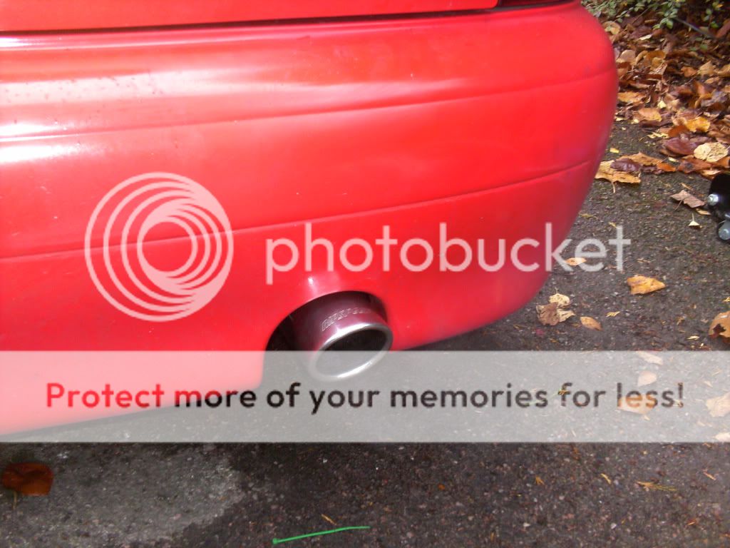

As some of you know ive been after a performance backbox. Frank recommended making a straight through pipe. so he set to work in the rain removing the backbox. It turned out Kwick fit had overtightened the bolts si it was a right opain. Anyway after lots of swearing later and effort it was off. I decided to start it up to hear how loud it would be. I was very impressed, it had a nice deep burble.
Therefore Frank set about cutting of the flange and creating a new 38mm bore pipe. After it all was fitted we started it up agian and it was very quiet! I took it for a test drive and it still sounded quiet. However when I got back to Franks house he said it was very loud when I drove past him. So I gave Frank my keys and he took it for a rip so I could hear it, when he blasted past the sound was immense.

Frankspeed manifold

'Franks custom exhaust'.

Spaced rear wheels.
Front wheels

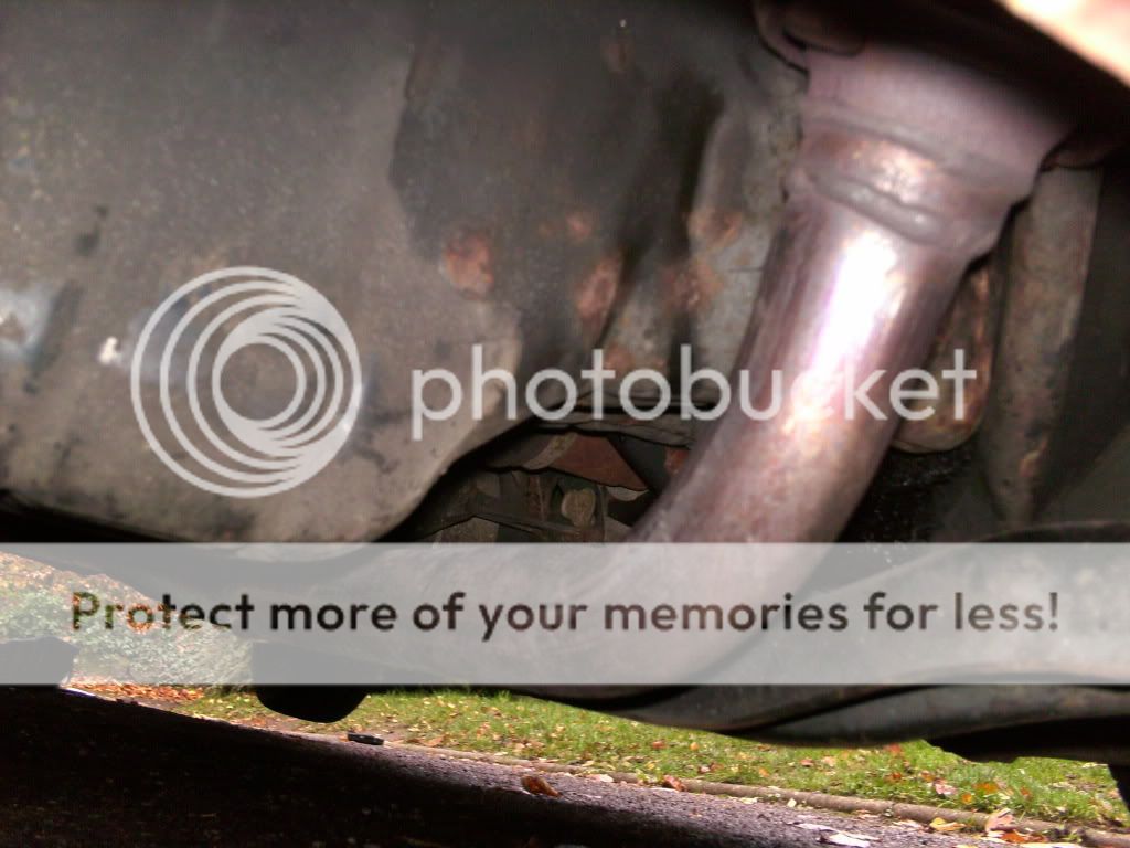

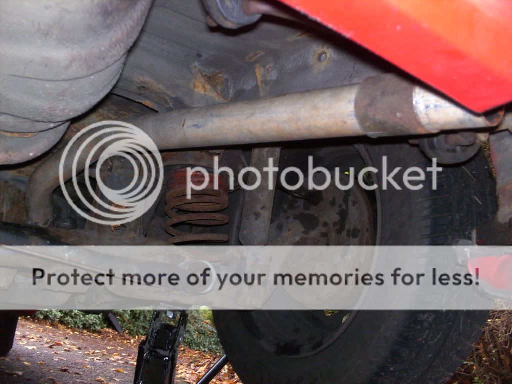

Manifold looks mint Eliot (Y). Is that a small fluid leak behind the drum? Looks like it may just need nipping up.
yeah look good for sixteen years old I think! Its not to rusted it passed the MOT end of september.
Woo your cars same age as me :grinning: and yeah but getting underseal on the underside and in the sills and anywhere else will prevent rusting for a longer and hopefully make your car last alot longer (Y)

155/70R13? Im using them on my 1.0 and its dangerous, on a 1.3 it will be even worst... lol
... i dont like red cars but yours looks very awesome !!
...i am envious of your exhaust mod.
...i need a bit more power and concerning my remus backbox i can say "the sound of silence" (no sound,no power)
...but maybe baguete will start the turbo project soon :p and sell me his complete exhaust incl. manifold (Y)
i also never had problems with this small tyres and they make the car very zippy to drive.
Eliot, thanks again for yr help concerning the springs.........now i have nearly the same drop as yours :laugh:(pix will follow, i will start a new thread when i have the time to clean my car)
No mate, its all mine... :laugh: And it will be a Supercharged project. :wasntme:
Yes, its zippy, but the 165/60R14 are much better and are "only" one size up...

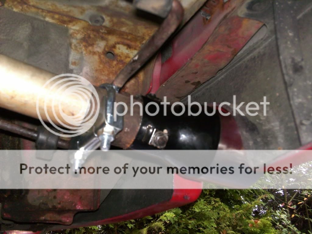

So is your back box just a straight pipe from cat back? How's it attached exactly? Car looks very nice btw! How much does each frankspeed item set you back?
Yes it is, Frank cut the flange of my backbox and welded it to the pipe we wanted to use. From there he cut the metal mount hangers of the my backbox aswell and welded that to another piece of small pipe that slides on to my tail pipe (4th picture from the top shows how its held on. if you cant understand what I mean.)

My frankspeed manifold was £37 pickup. I think frank wants £45 posted.
He knocked the straight pipe up and attached it all for £15
I can definetley noticed a gain with the manifold (recomended) and I can easily notice a gain with the straight pipe aswell.(and the noise :eek:) Frank took mine for a rip and said It is getting almost as fast as his. Just the cams then eh Frank *geek*
Eliot, with the wheel spacers the car looks very good. As i understood, you fitted the 32mm wheel spacers from ebay ??
i never saw that kind of system before, it is not available in germany.
On my car i have fitted pulsar plus wheels 14x5,5 with tyres 165/60. If i fit this wheel spacers do the tyres touch the body in extreme situations? Do i have to modify the body?? Or does it work without probs??
...last week i picked up brand new wheel spacers (only 15mm each one) for very small money, but it is another system, where i have to replace the studs
...and i think the change of the studs will take a lot of time (i have abs and rotors on the rear axle)
cheers
monchi
yes monchi eliots spacers were those grayson ones (but with longer bolts, and not the extenders)
and yes i think you will have to remove the discs and calipers to fit the extended bolts :grinning:
