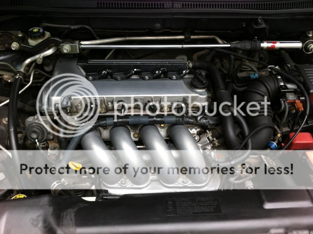

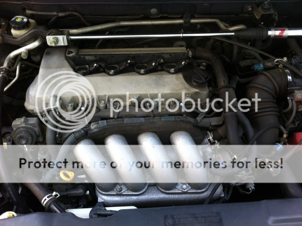

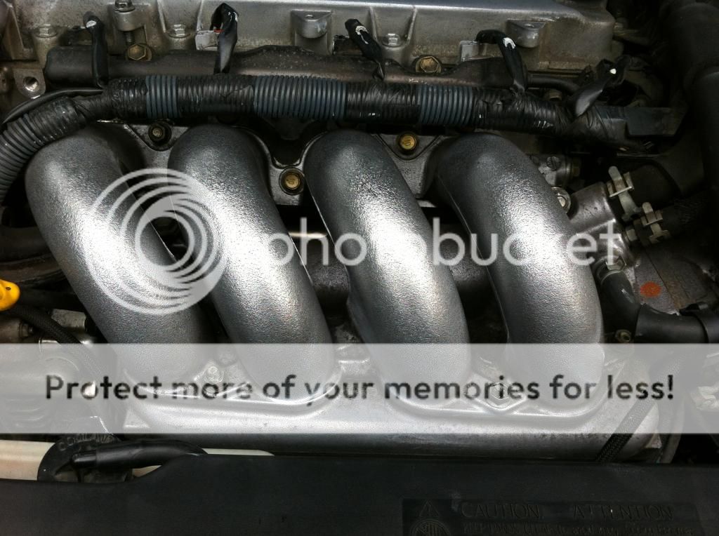

Had a crack at degreasing the engine today, Before and afer results are below.
Still a work in progress, takes time for all the crap to come off.

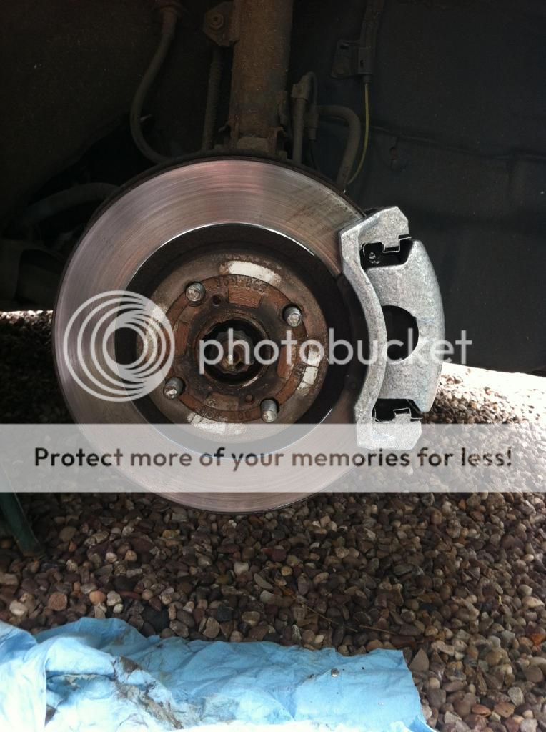

Been painting the brake calipers, went for a subtle silver option over the usual red. Used tinned hammered silver hammerite and dabbed it on with a brush.

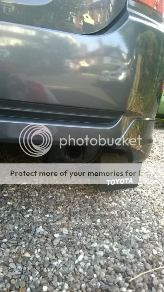

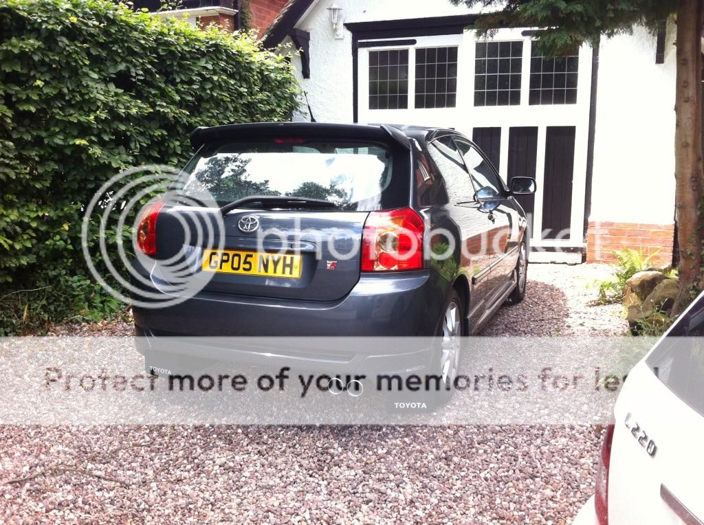

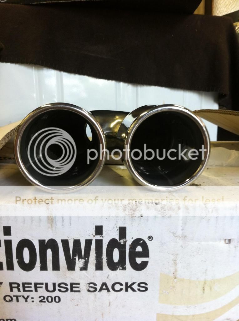

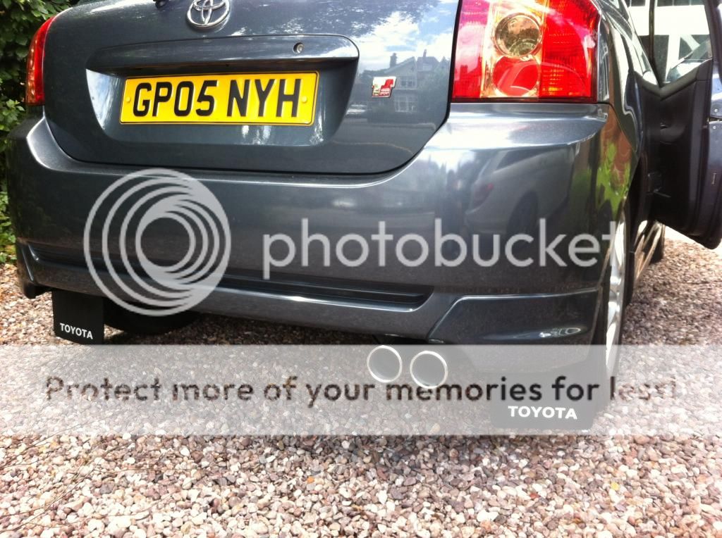

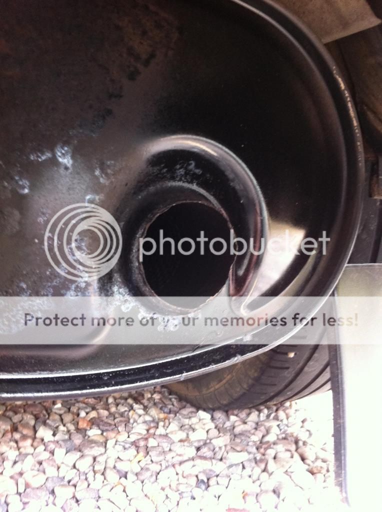

I had my first small niggle not long after owning it. The exhaust tip had rusted and completely fallen off, I cant recall when it happened, I just noticed one day something was missing from the back. This has happened to a few people so it must be a common fault.
Rather than dish out a ridiculous amount Toyota want for a new back box I went for a different solution.
My Dad works in precision engineering so made me up a small tapered steel insert that I could hammer into the existing box.
This game me enough room to clamp on an exhaust tip.
I went for a dual 3". A similar style to the official TTE backbox that most people opt for.
Here is the result on the car
Best thing about this is I can easily change the tip and put a different one if I get bored.

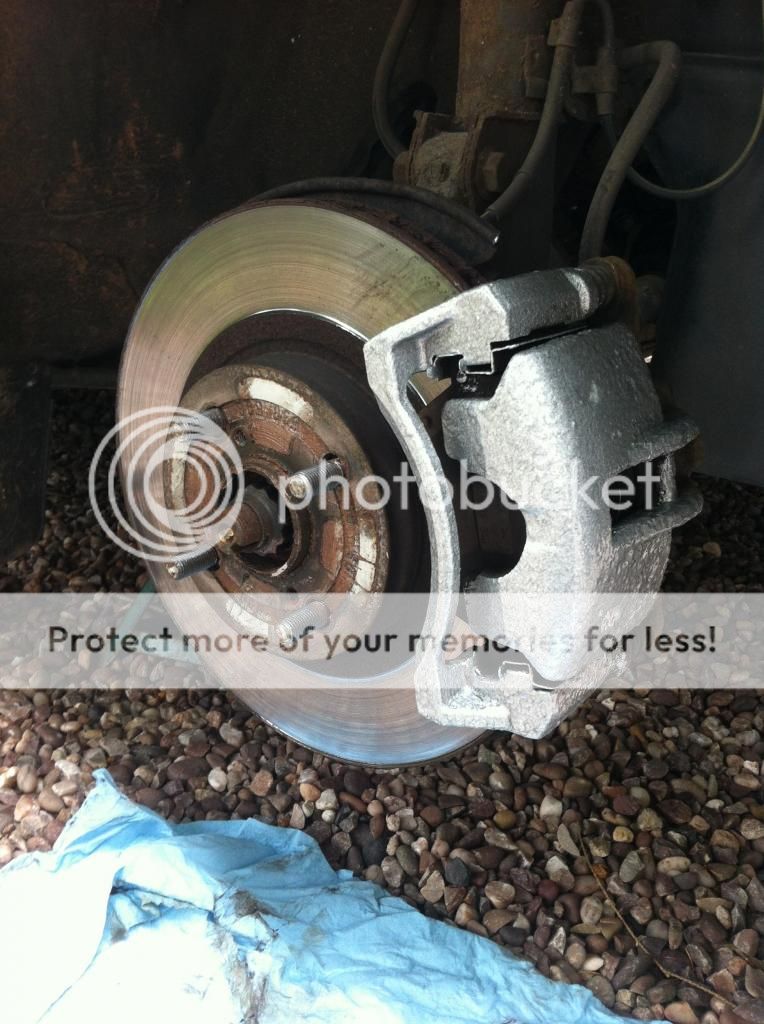

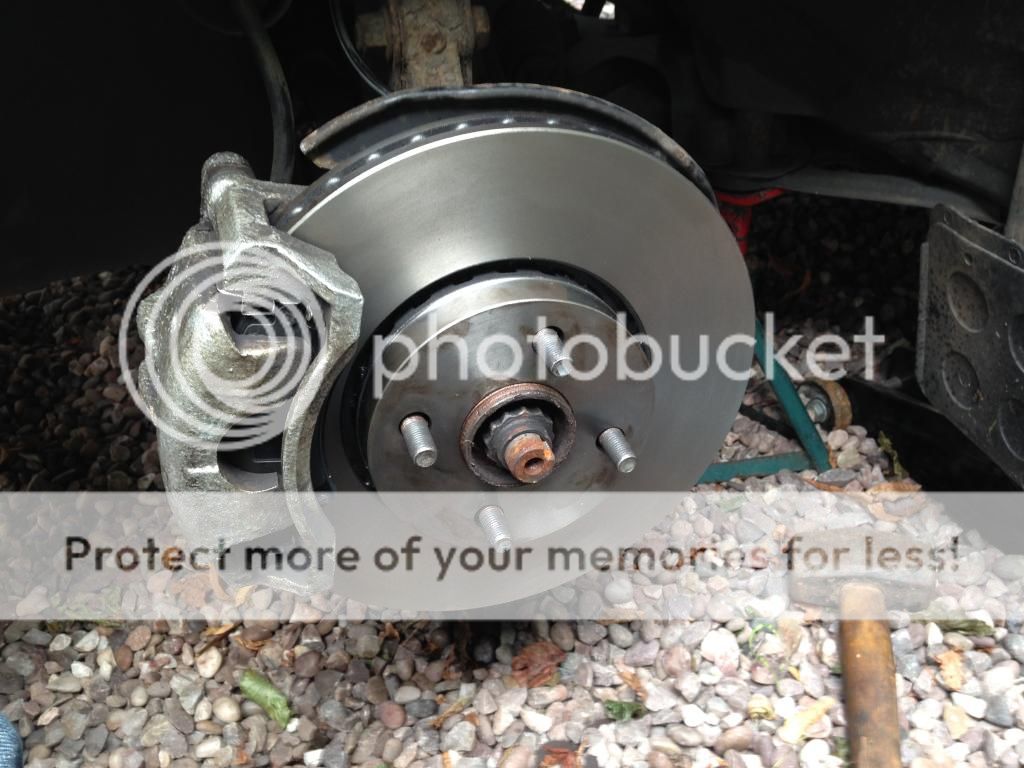

Decided to tidy her up a bit so I painted the calipers a nice subtle silver
shortly after I ended up replacing the the front discs and pads.
The nearside was so badly worn the brakes were jamming on when reversing.

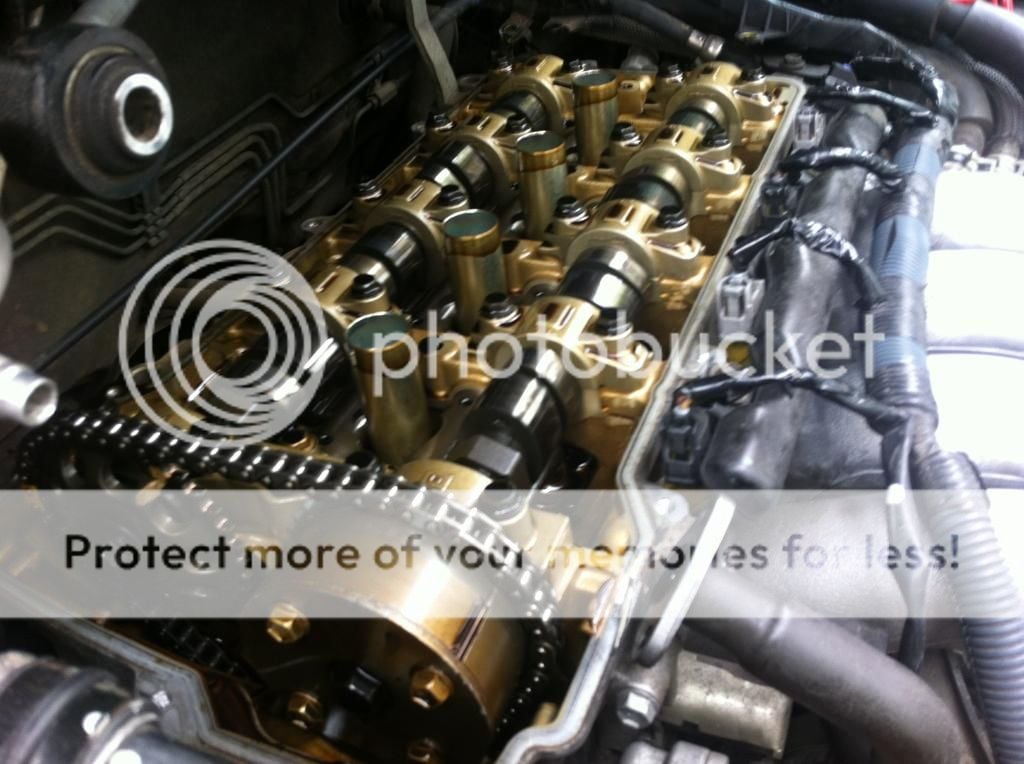

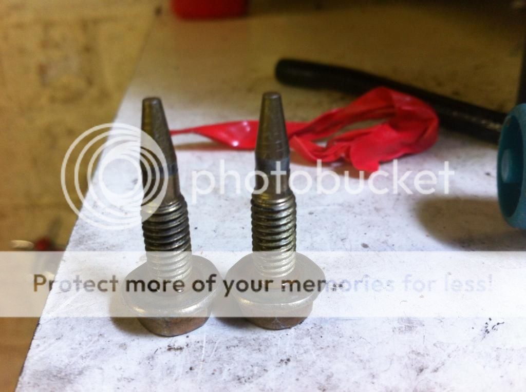

Next job was the infamous lift bolts, very easy to do!
These are infamous on these cars, they keep the cams locked in position when they change over to the high cam at 6200 rpm.
They can wear and snap casing the cams to move about slightly and not allowing it to change to the high cam.
You can see the wear marks in the second picture.
