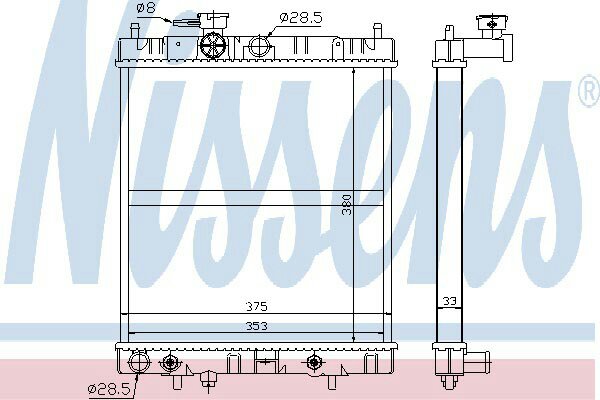

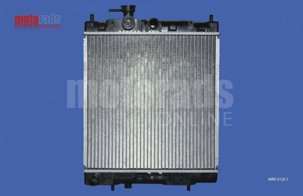

  • undersized, dirty & blocked thin 18mm manual gearbox radiator. before u ordered the civic rad I was gonna suggest buying a 26mm thick Nissen K11 automatic radiator like mine which is a direct fit & handles the heat of +160hp on trackdays all day long no problem.

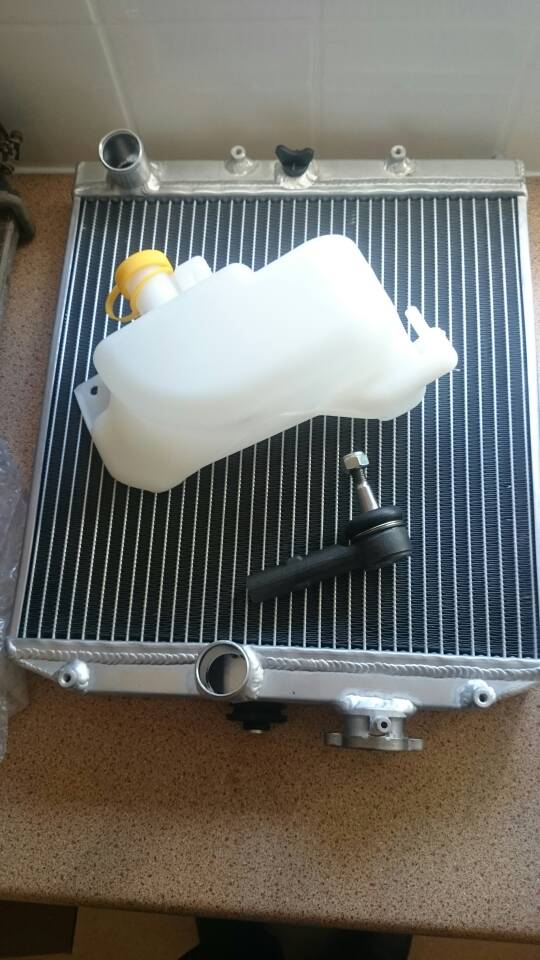

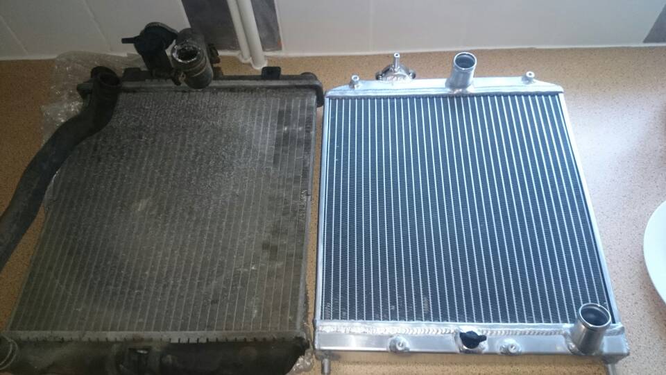

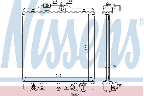

So, looking at the civic rad, doesn't look too far out to be honest.
Three holes and a rad hose.
Easy peasy.
There are plenty of options for rads on the K11.
I went for a full width starlet radiator, as the hose positions were very close.
Was thinking about one of those but the turbo position puts the inlet forward of the rad support horizontal plane.....
It not the bumper that's in the way.
It's the turbo inlet. Sits too far forward for a full length rad.
No biggie, this civic one is good for 500hp of cooling duty with a 12" spal fan...
My cousin once suggested the same rad but the lower pipe is at wrong side, requires new hose route, and too close in front of front mount. Option was to get it rewelded to the lh position but that's lotsa time n money. Hence why I tried the straight fit k11 Auto rad n was fine.

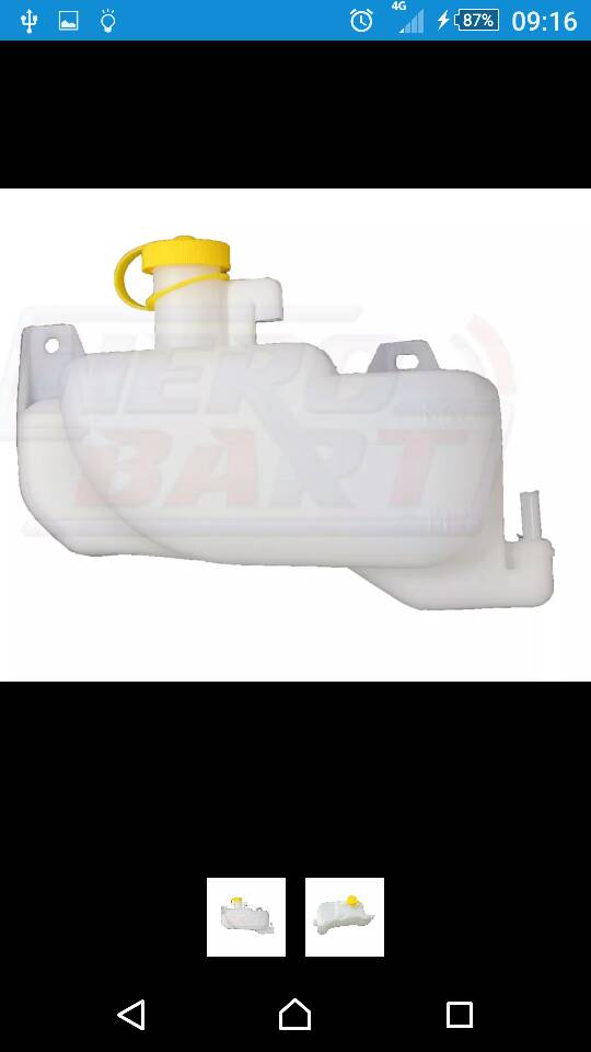

Radiator, expansion tank and track rod end.
Just awaiting torque wrench and head gasket. And I'll get this bitch sorted.
It's for a civic. Will take some jiggery-pokery to fit but it's not far off.
Bottom hose is on the wrong side, but should be able to fix it with a hosepipe. Lol.
The one I've got was on a 205 turbo and has been shortened and had one of the outlets moved to the top. Ideal for me.
