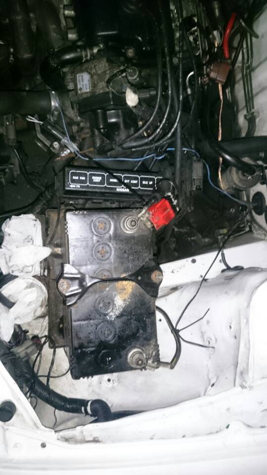

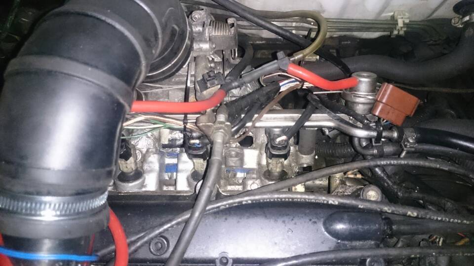

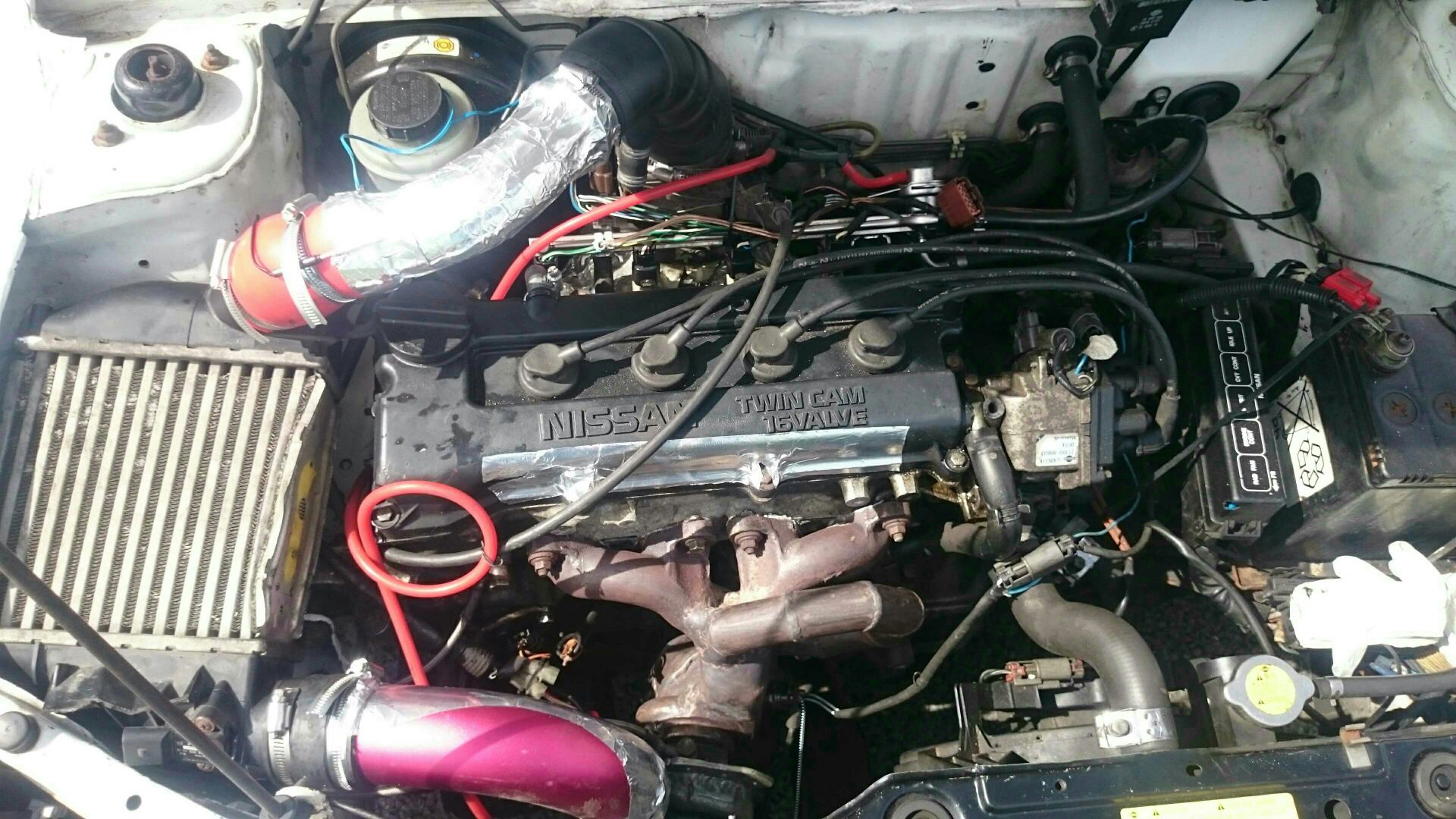

I've removed the egr / dump valve as it wasn't sealing properly and was causing a boost leak.
No leaks now lol.
Also began to replace the go-kart fuel lines for silicone vacuum boost lines.
My £15 intercooler ain't gonna fit. So that's a bugger. But it's all experimental.
Here's some pics after I've tidied Er up a bit and of some of the areas that need attention.

Move battery to boot
Fit an intercooler
Fit boost controller
Change all the boost pipes for 2.5" stainless steel/ally
Remove any excessive cabling and replace with a bespoke loom (my speciality)
Clean and tidy up the engine bay

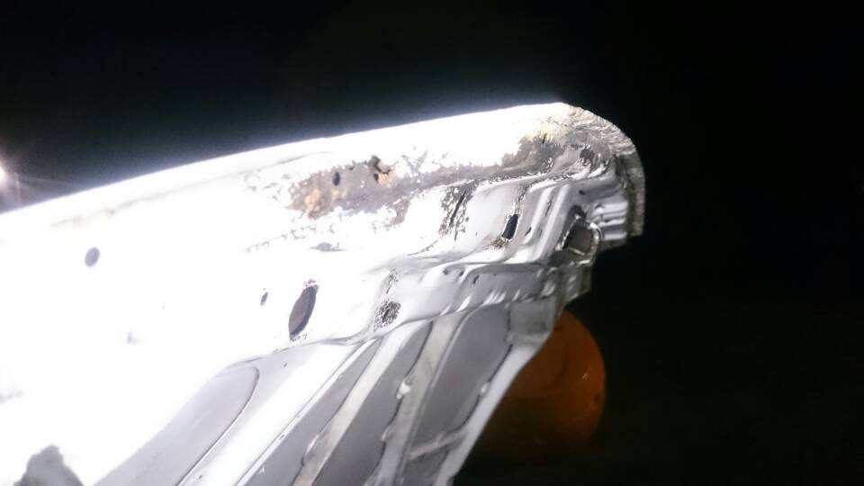

Fix the rust bonnet

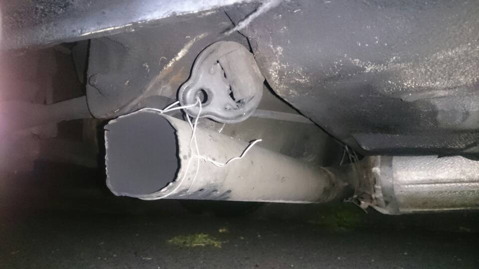

Replace side exit pipe for a decent straight through custom jobbie in 2.5"

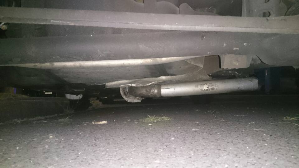

Tighten and check the rear suspension isn't falling off.

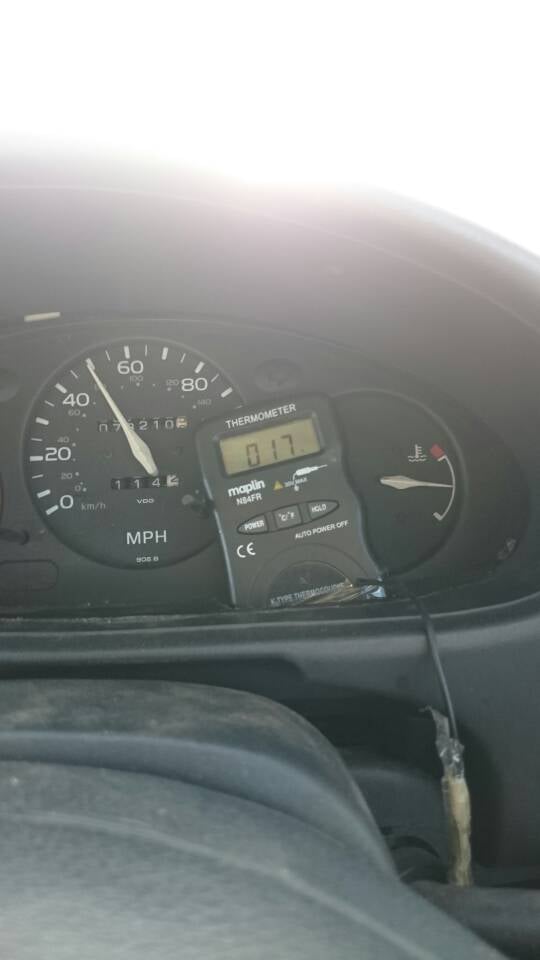

Intake Temps of 56deg after a short blast.
Needs an intercooler badly.
Should be nearer 40deg
I'll fit a remote intercooler and a temp controlled fan.
if you hav,nt lagged the pipe thats probably heatsoak from the engine bay ant ^ put the probe anywhere in the engine bay and it,ll read 56
