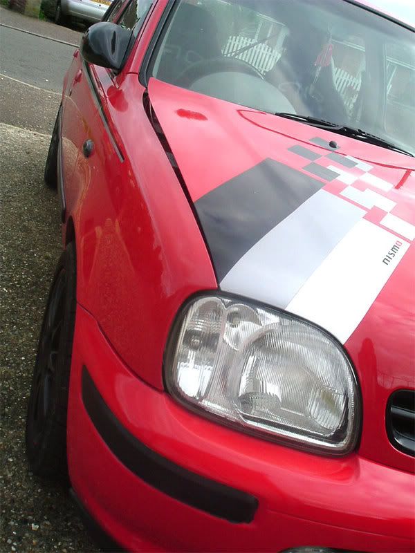

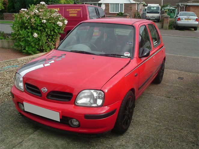

Tbh i done the bonnet raisers for the look,rather than the cooling side of things,every night i get atleast 10+ people come upto me and say my bonnet is open! So i tell them if i bonnet is open it'd be open from the other end!
RS Turbos originally had them on so i got told,thats where the idea came from.I bought these off my friend who had them on his Escort,so he probs got the idea from the Ford club or something. Cost me 10 quid.
@Antony: It was seeing pictures of Your car that inspired me to have them! The Black,Silver & White stripes really gets the red off and they're not OTT. Plus...its not as if we live near each other anyway :p
lol ive been out side doing my bonnet just got 2 quite thick washers and 2 diffrent new bolts with a longer thraed, works fine...tbh ive done it because of the look, but if anyone asks its for cooling performance :p what does your bonnet rasier kit consit of?
It consisted of 2 polished blocks (not sure what they're made from) with 2 oval holes both ends (where the bolts go through) and 4 bolts. But the bolts were too small for my bonnet so bought some M8x40 and M8x70 bolts.The rear bolts are too long so need to get some M8x60 :)

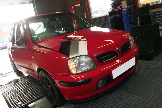

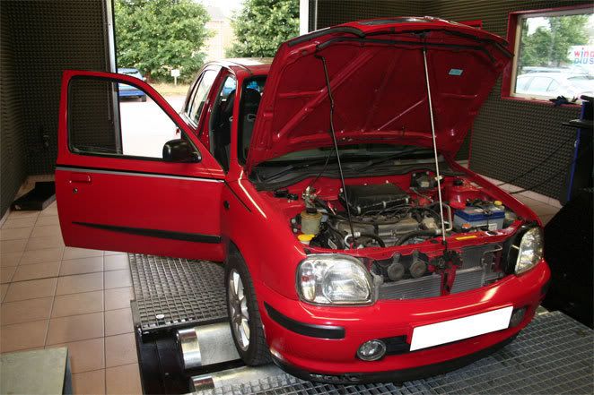

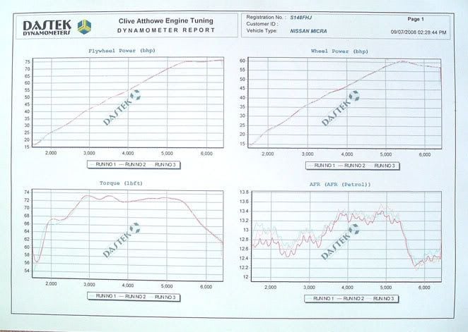

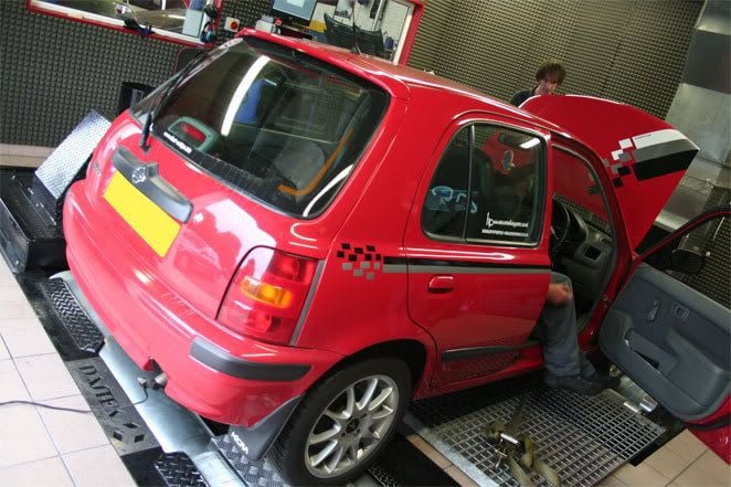

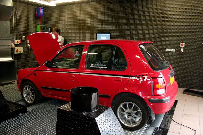

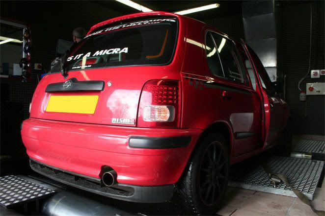

Had my Rolling Road today at Clive Atthowe,heres some pics of it on the rollers:

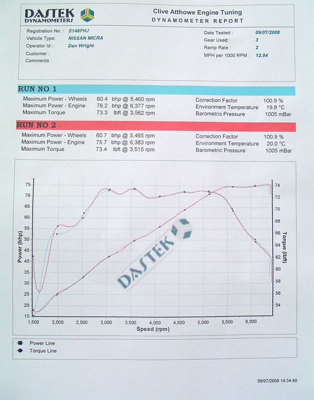

Heres what your eager to see:
76.2bhp @ Engine
73.3 Lbft Torque
So for a 9 year old car to loose 2.8bhp is pretty damn good IMO,guys at Clive Atthowes were impressed with the figures though it was running standard.

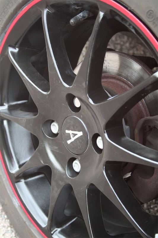

Heres an update,had my alloys refurbed & resprayed,grille painted gloss black,colour coded door handles

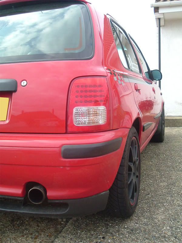

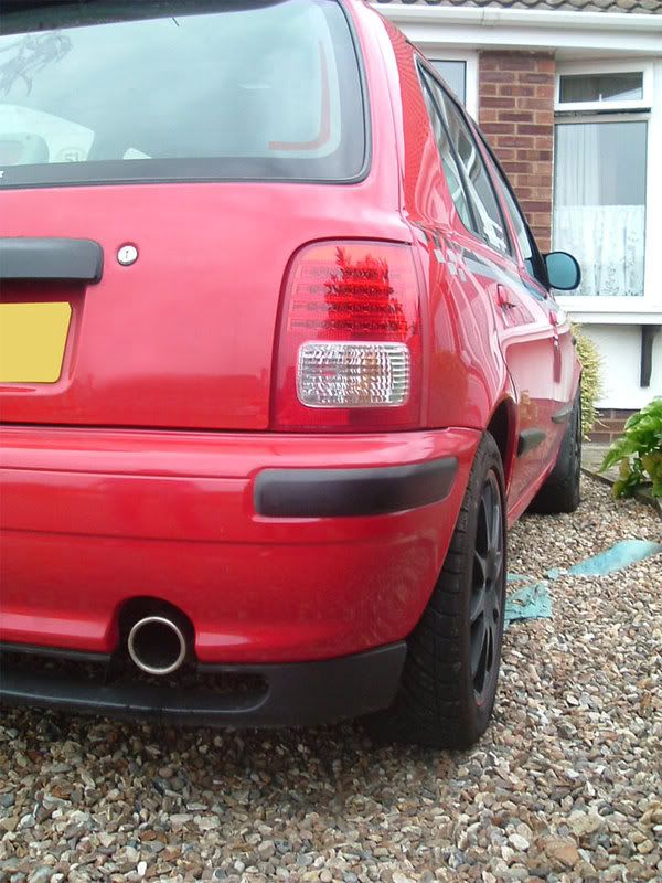

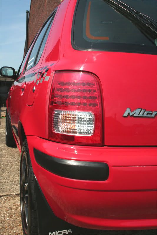

New LED Rear Lights

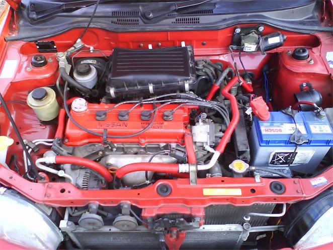

Tidied up the engine bay & fitted hoses and painted rocker cover

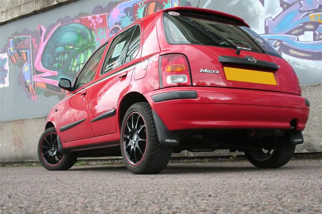

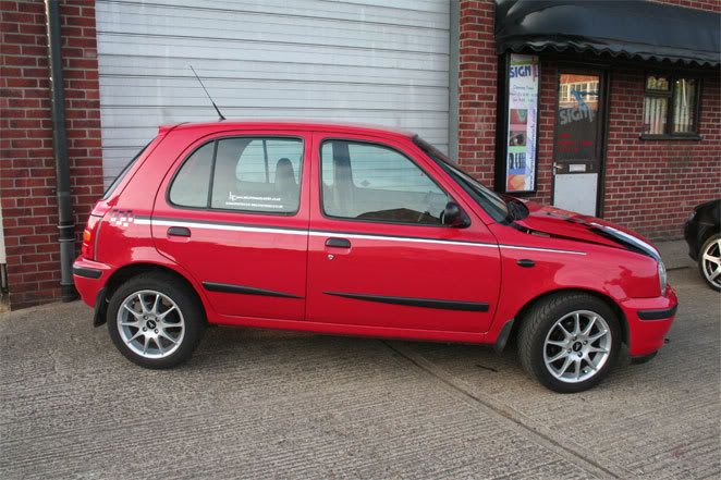

Lowering springs (P.I -35mm springs) fitted and settled
BEFORE
AFTER
I only put them on for Trax and havent had time to take them off yet. I'm still in 2 minds whether or not i should keep them on. Only takes 5 mins to put them on/take off anyway :)

I got a replacement performance panel filter from work and the car performs alot better with that than the cone filter.I've got a cold air feed running from the bottom of the car (about a foot from the front splitter) directly to the air box.

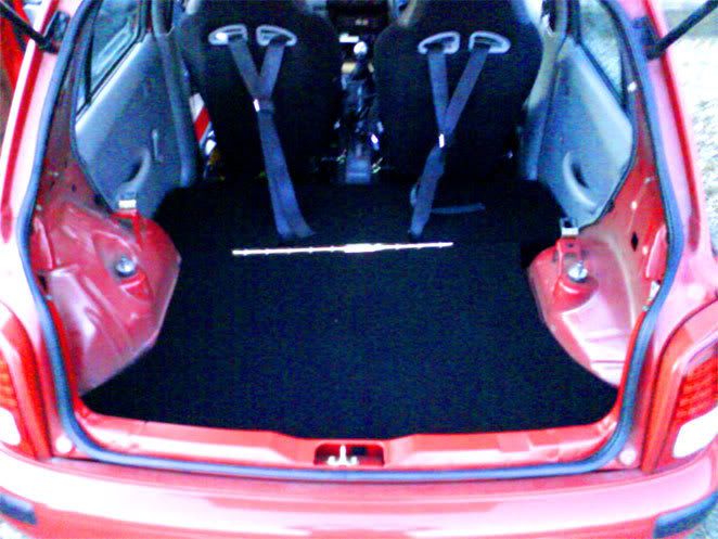

Rear floor is now done,sorry for the crap pics i used my phone:
thanks :) Yeah thats a hinge in the middle to help attach both pieces (only thing i could really think of that made it quick and easy to remove both pieces)

False floor was completely DIY with the help from my Dad :) Took abit of time to do but results are deff worth it!

Have you got any pics of making the floor? It looks really good and I want to do that once I have tints to hide my audio etc.

Had her Dyno'd at Clive Atthowes again today to see what gains i've got with the panel filter and de-cat exhaust system:
Standard (previous) : 76.2bhp
NOW : 83.4bhp
Standard (previous) : 73.3ftlb
NOW : 75.9ftlb
And heres the graph comparing both dynos:
