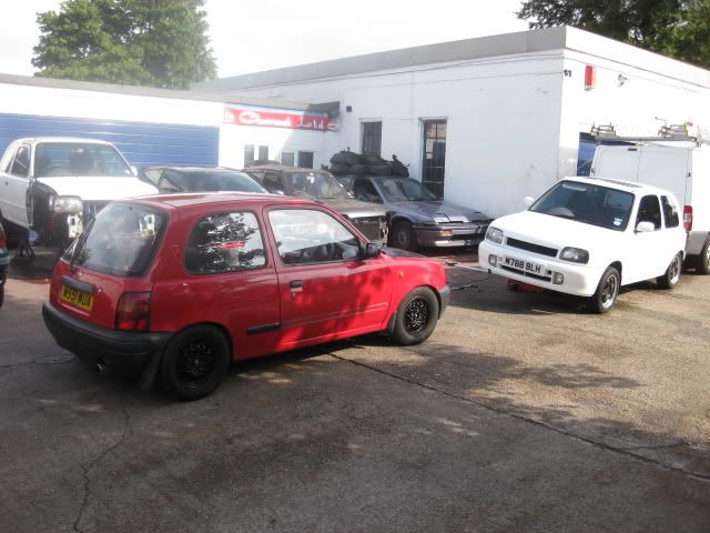

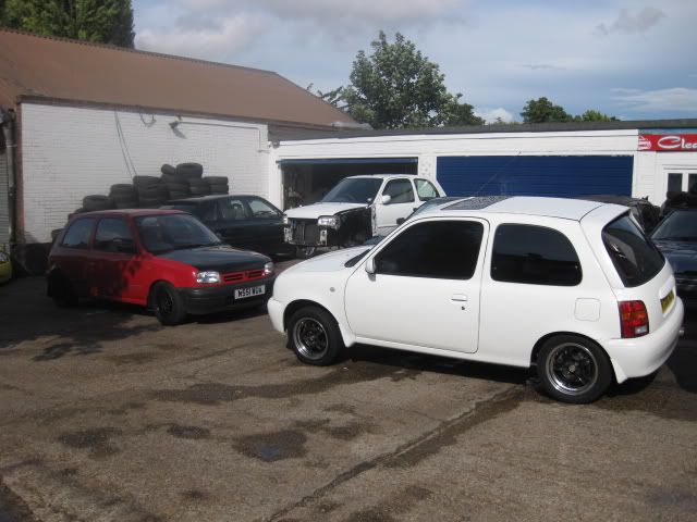

oh and some photos of the little bar steward!
off rats blog
has so much potential
new next to old!
bump strips of the first day i get it and finshing removing all the interior, carpets, roof lining, sound deading with a full sand down and respray internally with satin black, even the roof!
