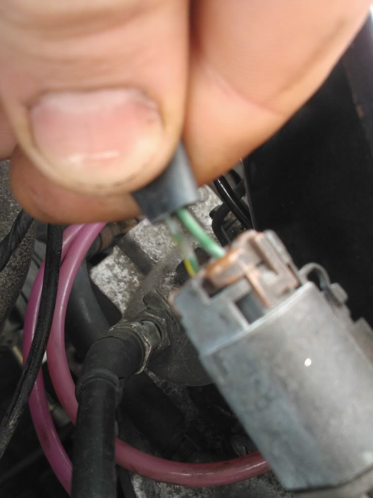

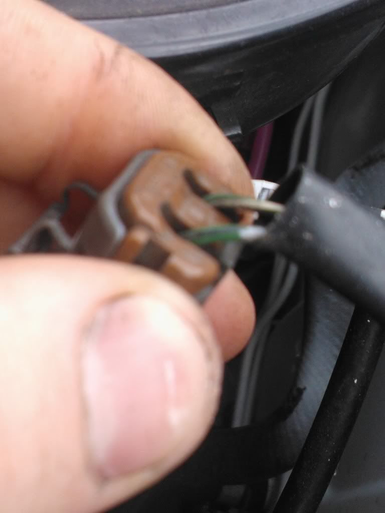

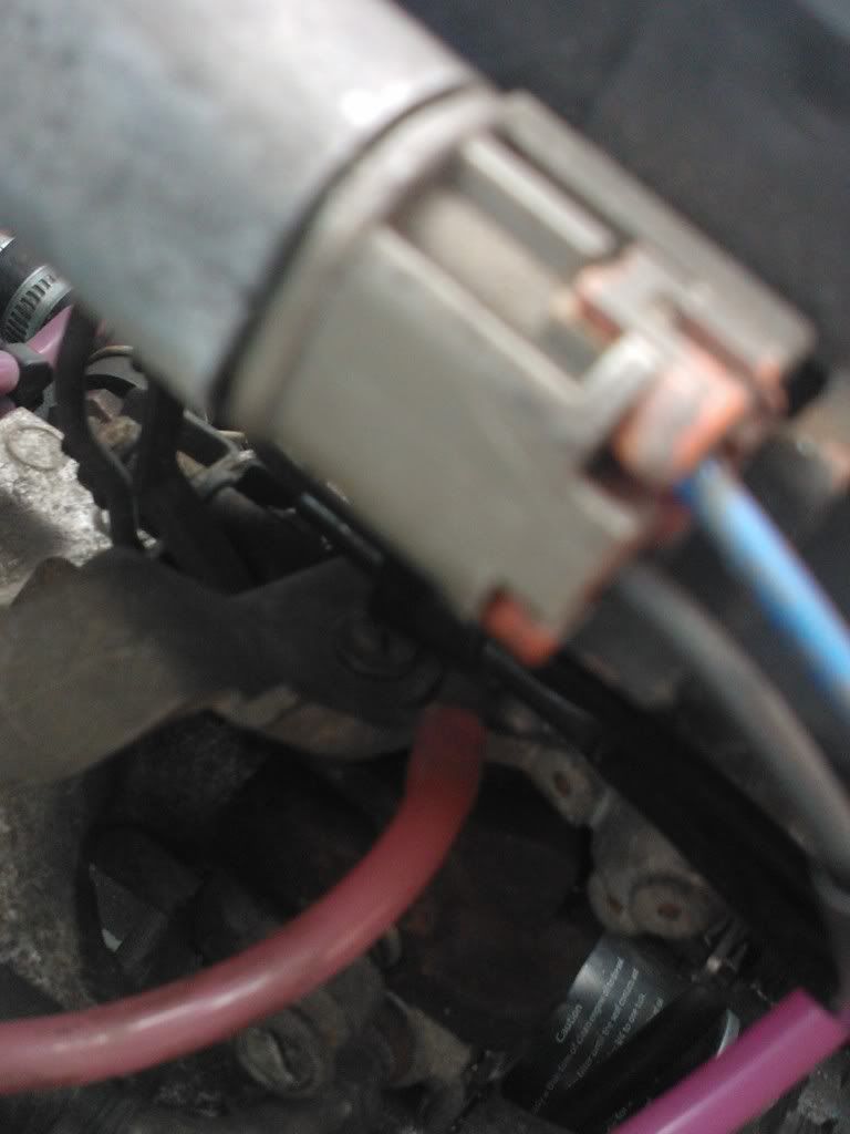

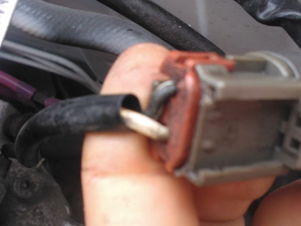

The one of the right.. has 2 vacuum pipes coming out both go to the dizzy in one form or another after t'ing to a carb vac feed I swapped vac pipes one at a time when I changed em :)
The one next to that has 2 wires coming from it going to a black plug... this is the connected... its plugged into the water feed that goes through the matrix and carb I persume
The one on the far left is plugged straight into the top of the thetmostat. Again another water sensor... I have the old loom and the both plug in and avoid the carb but go to bigger plugs.. assuming fusebox
A second loom that fits I actually remember seeing.. it connects to both the above mentioned sensors and both go to the 6 pin plug... the carb plug...
On that plug is
1 wire autochoke
1 wire anti dieseling valve
2 wire idle up solenoid
2 wire accelerator pump solenoid
Questions
1: does the autochoke require a 12v feed? Just tested and it hasn't got one
2: will the idle up solenoid require a signal from a temp sensor? Or just power and earth?
3: the acceleraror pump varies according to temp... so im guessing signal from temp sensor? Or again power and earth?

Do you not have some kind of ECU to take care of the thinking side? Sensors don't usually control other sensors as far as I know.
Autochoke is a solenoid yeah? Or a stepper motor? Either way it will need some current (most likely 12V) to perform a function...
Nope no ecu. I searched high and low for one when I stripped the 100nx
I tested the autochoke this morning and its receiving 0.06v
auto choke and anti diseling solnoid,
g/y and g/r wires on harness,
blue and black on carb,
whatever the other wires are lol
on carb
on harness not clear but its bl/g and w/g
Just been reading up on autochokes etc.
Apparently that and the idle up solenoid take power from the '+' side of the coil... hmm
Isn't it a bimetalic or similar type mechanical autochoke with a signal wire to an ecu?
Its the same as the K10 setup... infact they're identical... its just mating these to the k10 loom
The accelerator pump solenoid is the only thing different to the K10... so gotta figure that out :/
