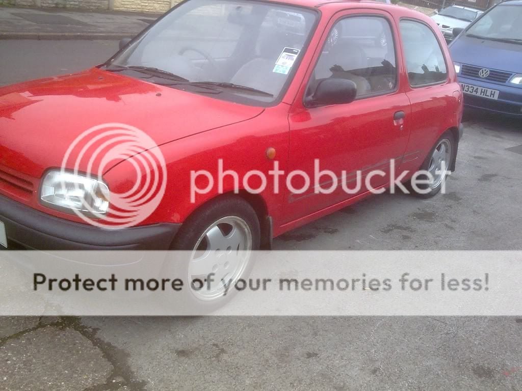

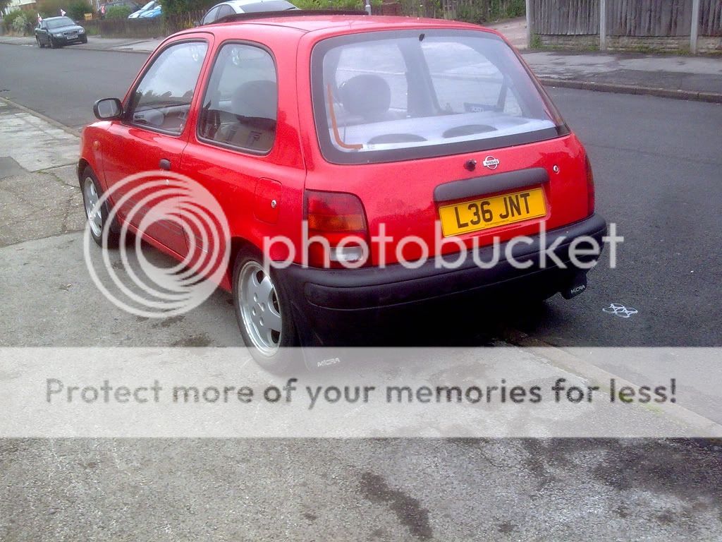

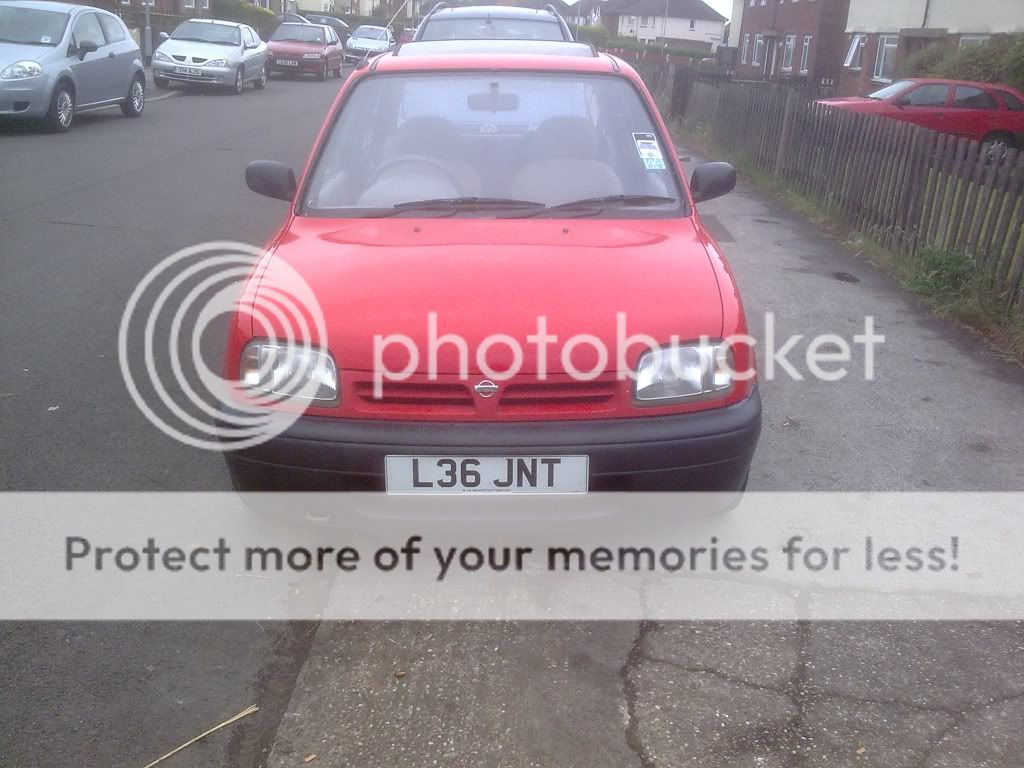

first pics of my work in progress micra
just a few pics after its been lowered and renault clio alloys fitted door strips have been removed just need to clean off the sticky stuff
all coments welcome good or bad but please dont be too harsh
Very Smart. The alloys look good.
They look pretty good with those mudgard spats off along with the rubbing strips.
looking good mate,get some petrol on them, keep applying it to them and they will dissapear!
maybe some bolt on spacers to stick them out futher, say 20mm?
well i couldnt find springs lower than 35mm so i took my springs off and cut 2 coils off with the grinder so dont know but would say around 60mm rear and 50mm front
Halfords "sticky stuff" remover works great on that bump strip glue if you spray it on and leave it to soak for 5 mins it comes off in layers, mine took me about 3 layers and i used hard plastic scraper i got for window tinting,
Also afterwards i found my paint didnt match, but rubbing compound works miracles and matched it in when t-cut wouldnt !
