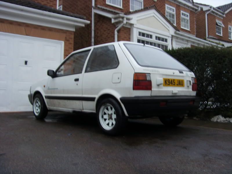

Well this will be my 2nd one. My 1st was a 1.2 auto that I converted to manual, stripped out, slammed and put a bucket seat in. But anyway this is about my new one. Not doing much to this on as its gotta be a reliable daily, thats there when I need it.

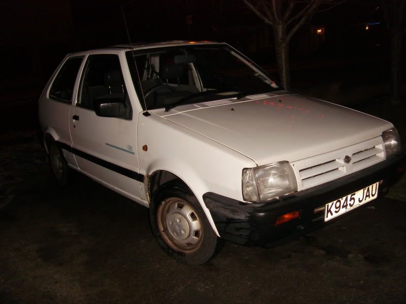

When I 1st got it:
Did a few jobs on it:

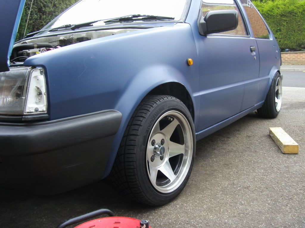

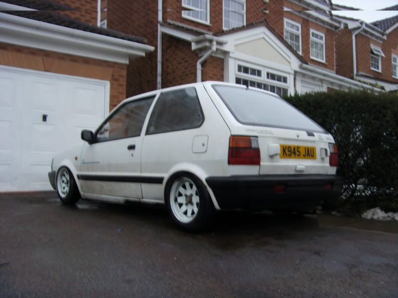

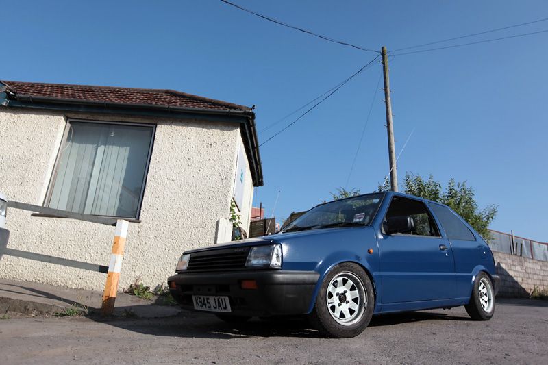

as it stands atm:
And when I can be arsed to get the grinder and springs aquainted:
Ill take some pics of my handy work on the sill and ill be upto date with how it is atm.
This looks amazing but I agree with micras69, you need to lower it a tad more like in the photoshop :p
Cheers for the comments lads, as you say it still needs to come down a little, but its pretty close to the already chopped bump stops so will get some coilovers in the future for more slammage. The wheels are 13x5.5 wellers running 155/70/13 tyres.

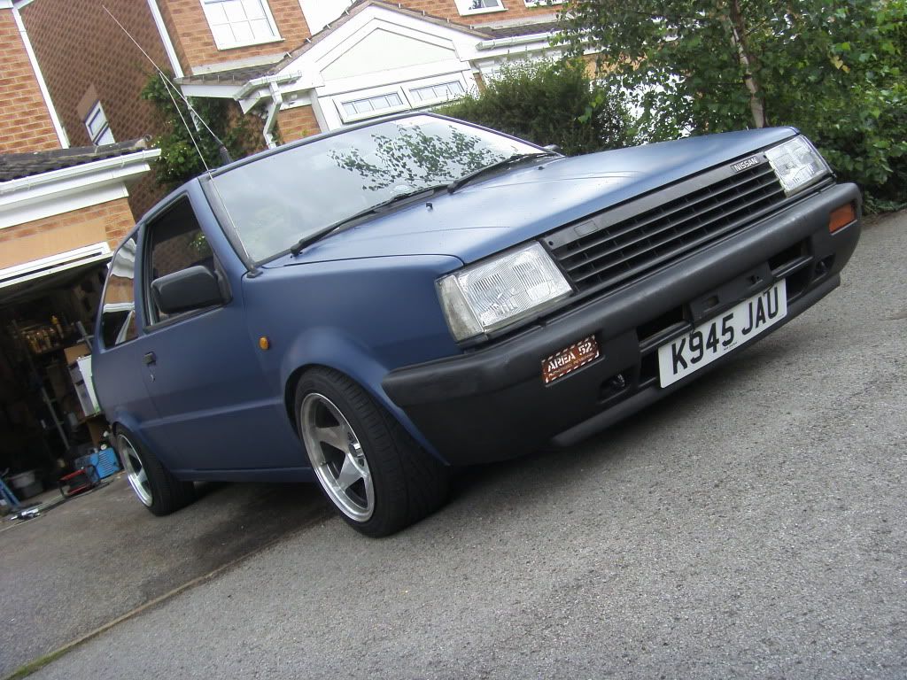

updates?? this is one of the best micras on the forum. simply coz the way it looks slamed on them rims!!!
erm? I gave it a wash today? lol Not much will be happening with it as its a cheap daily. Though when Im done with it, its gonna have the pre-facelift front end, 7j or 8j wheels and more lowness.
i agree it puts my car to shame :( does look nice though (Y) well done!
Thats because you spent time painting things blue, instead of getting the grinder and your springs well aquainted ;) Though I do like your grille and interior.

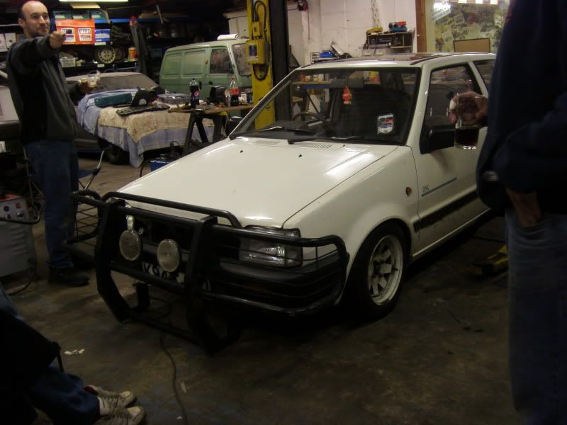

Decided to go down a different route with mine compared to everyone else:
Thats another coil off, making it 3 coils all together
and then:
Bull bars ftw! :D
Cheers for the comments guys, and that would be a good idea Mark, but ill be getting something simular to this in the back window :D

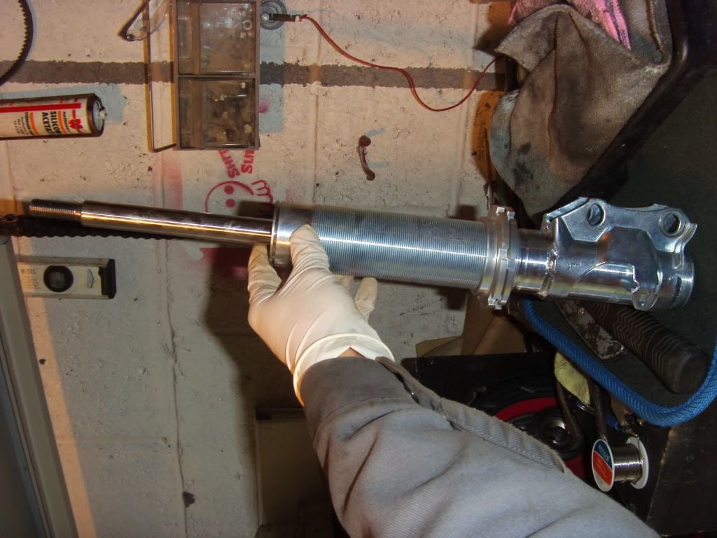

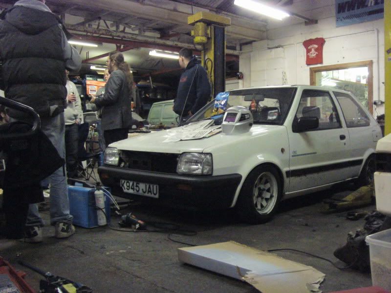

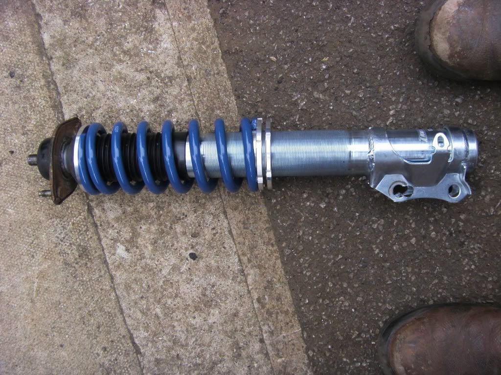

good update today! :D COILOVERS FTW!!!! ;D
ooo shiney:
Stripped down:
Drilled:
Drilled:
Built up:
This is far from perfect, but with a day to go, I didnt have time to find someone with a lathe who would be able to machine the top cups down for me:
Fitted:
ah....
thats better :D
Loving the strech with 165/55's instead of the original 175/50's (half price too! ;D)
I think I'm gonna bring the front down a bit more in the morning, unless the springs will settle anymore.
(why isnt there an edit post button?)
But even if the plastic washer does collapes, its only gonna make the steering a bit stiff and grindy, nothing is gonna fall off lol
the topmount problem will probably just make the steering stiff, but the weakened mounting hole looks potentially lethal to me :eek:

Cool I was thinking of copying you, (silly question the top cup is the rusty part on the pic)
attachment.php
It will be weaker than original, but I didnt have a grinder to hand, otherwise I would of welded up the original hole, but Im sure that it will be fine. We'll find out this weekend as ive got a 500mile round trip with some track time inbetween :D
(there is when using tapatalk ;p)
The top cup is the shiney bit, the bit that the spring sits into. the rusty bit is the top mount.
well, got back from the retro rides gathering and the coilovers have lasted! :D I ended up dropping the front more at the campsite, which means its now back on the bumpstops at the front, and the bottom arm mounts cant be more than 2inch off the floor. The car also got a good thrash around the track too! :D so 480miles, including 2 track sessions, and no problems with the coilovers :grinning:
