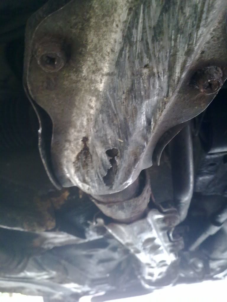

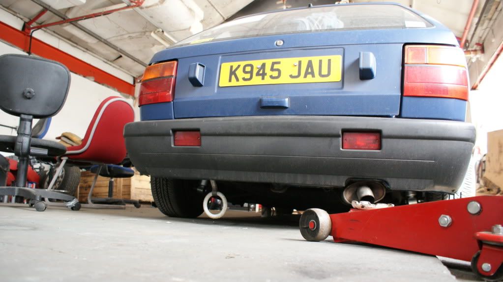

I started today off with getting the car up in the air as I was getting bored of the exhaust scraping everywhere. And well, that and a few other things have taken I liking to the tarmac:
Gearbox
Sump
Bottom arm mounts
Exhaust

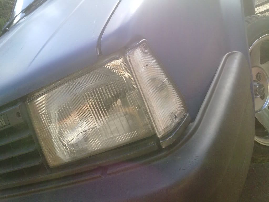

After looking at it, to raise it up I'm gonna have to chop and shorten the downpipe, but I havnt got a working grinder atm so that went out the window. I got my new sidelight covers from donttellhimpike ( cheers mate! :D) so fitted them:

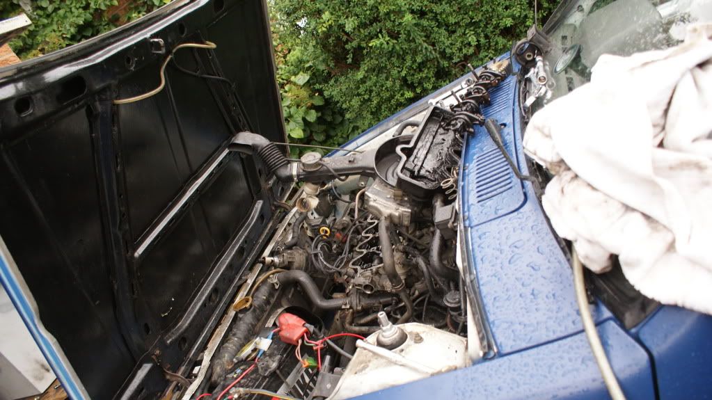

Then went on to stripping the 1litre engine I had ready for its new head:
Bloody clean in there to say it was from a D reg!
That isnt though, new water pump time:

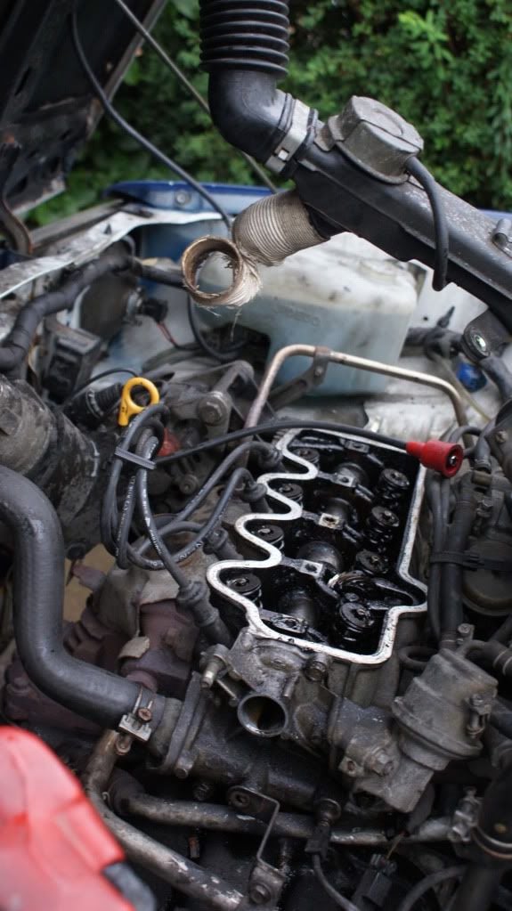

Got the head of too find this:
Its like bloody new still!
Pistons out of the block:
nice clean crank:
Crank shells in bloody good cond
and the car its going in
Ill be building it back up with a new water pump and belt tomorrow and will take pics

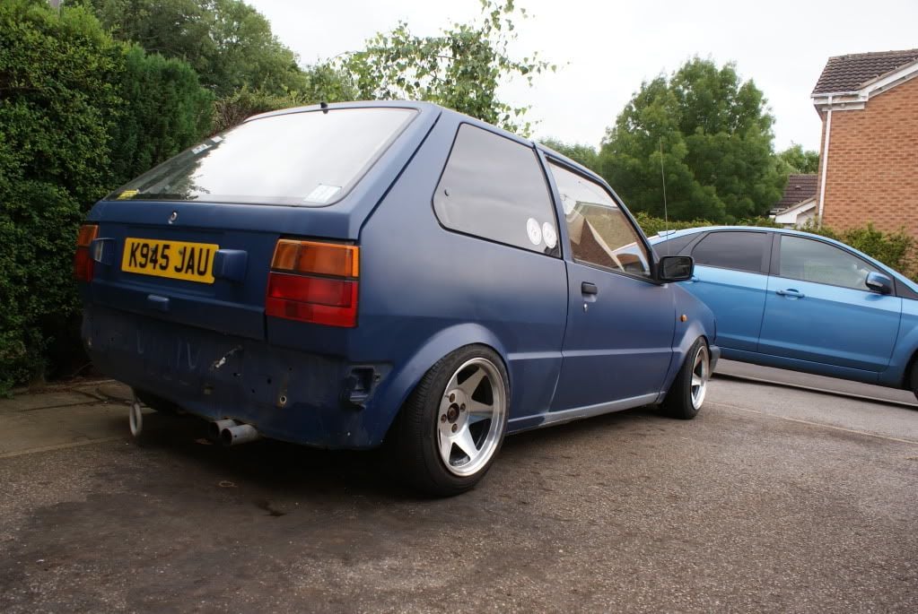

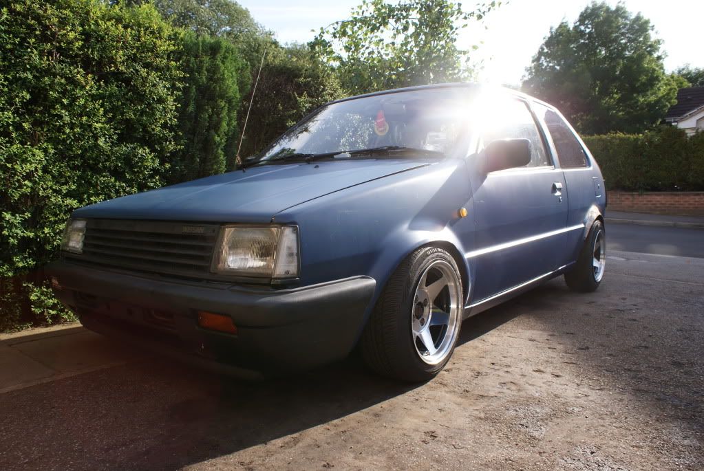

What colour is it on your car now? because in some pictures it nearly looks like a matt colour!
also are your coilovers just cheap polo 6n ones off ebay? was there any other mods needed to fit coilovers and looks like you have pulled the lip out on the arches aswell?

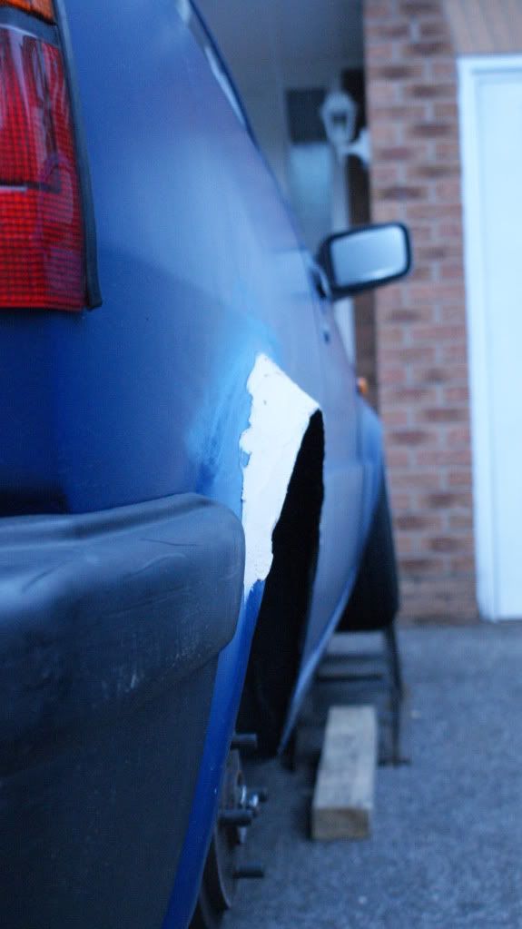

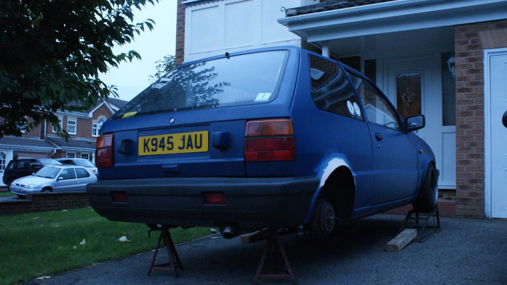

Quite a bit of work has gone into the arches to make the wheels fit, cut and welded the inner arch higher up and gave the outers a good bashing and rolling.
some more update though :D

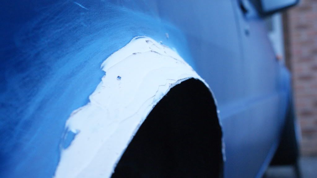

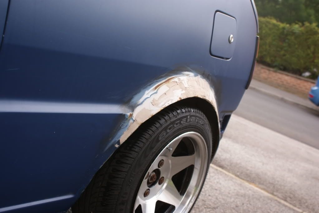

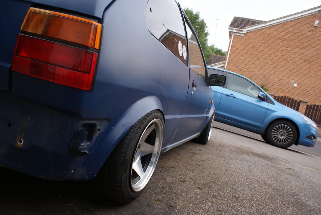

Finally got around to making the rear arches a bit more presentable, a mate came around and bashed them into a bit of shape and I gave it a skim of filler.
Before:
(thats before I gave them a bit more bashing :p

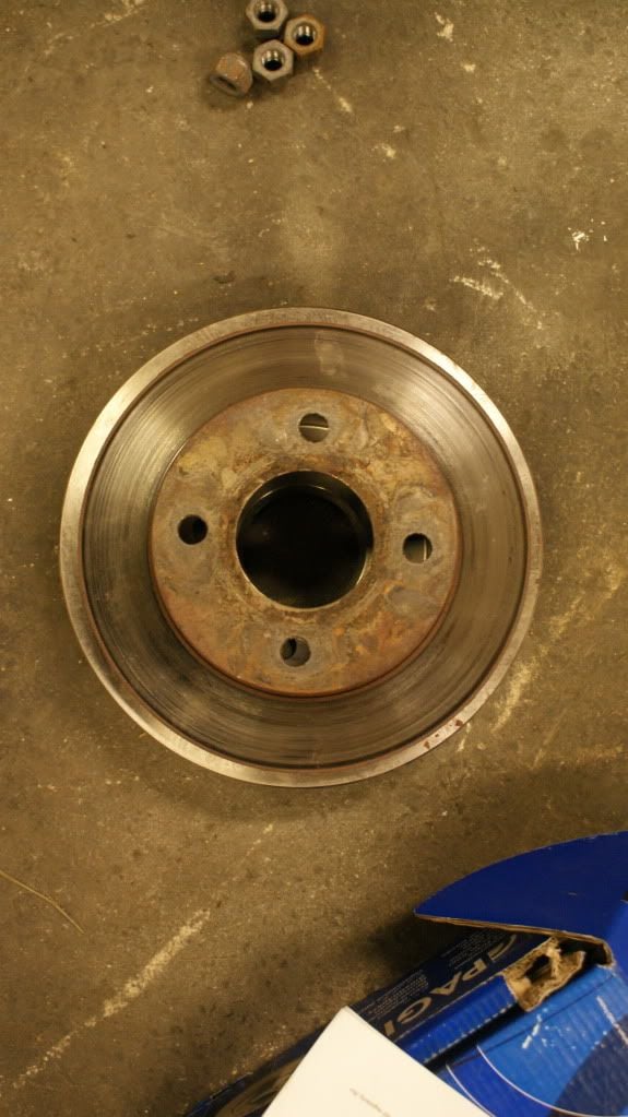

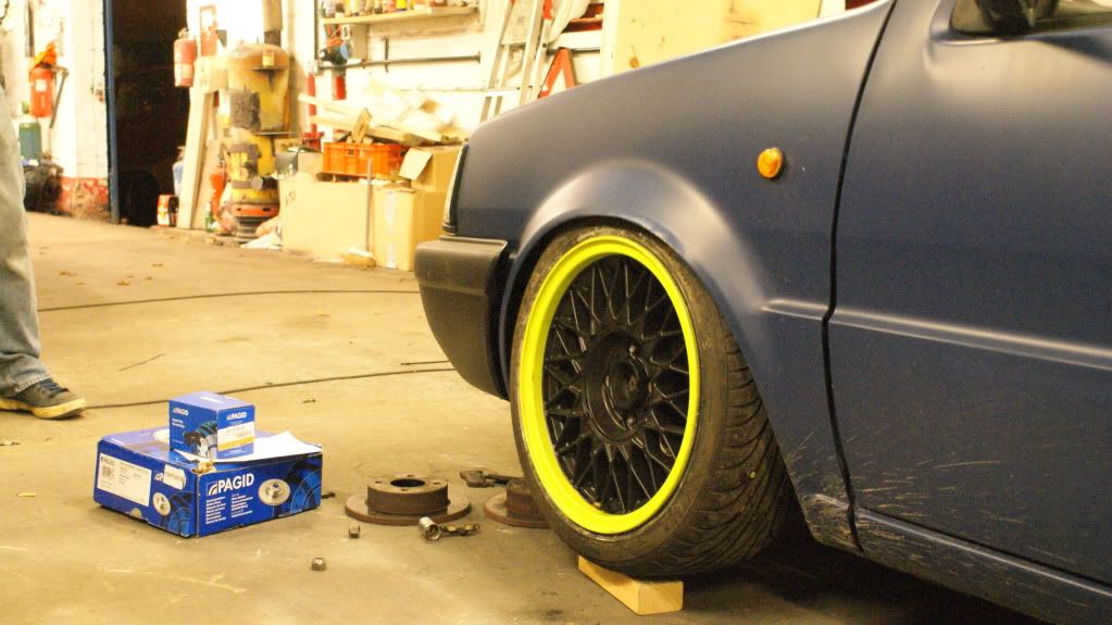

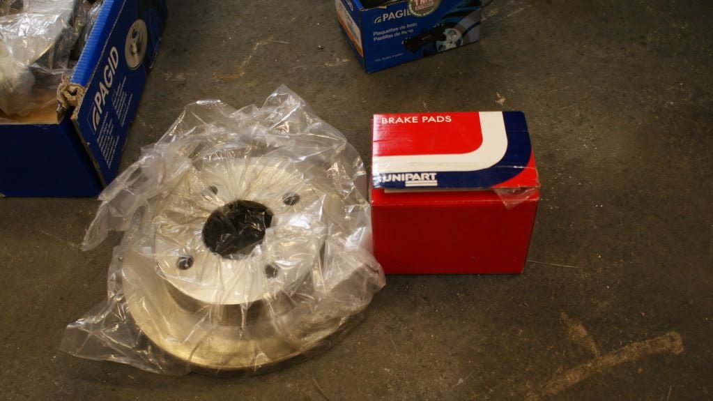

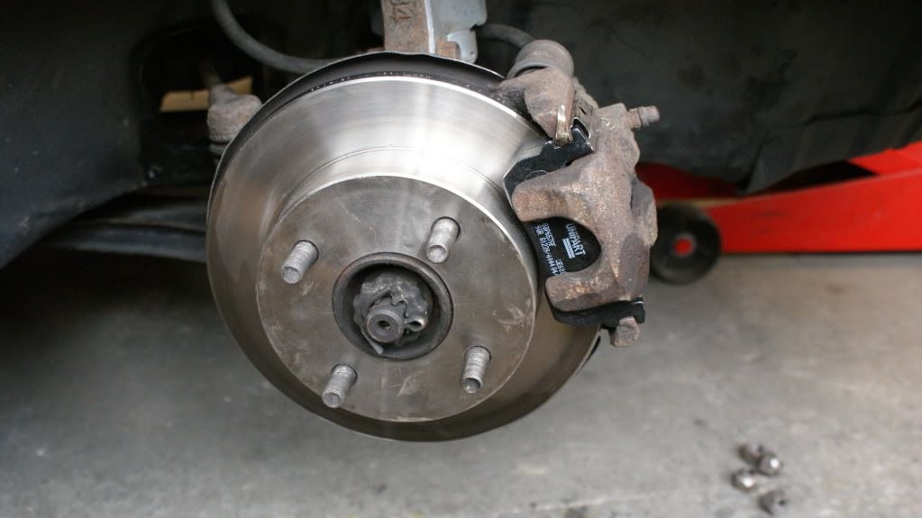

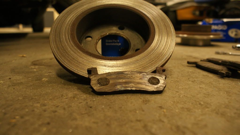

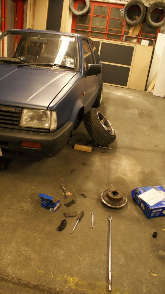

had an epic weekend at a52 and the micra finally got some new front brakes. But that was a job and a half. The brakes I brought down were for a k11 not a k10 ::) But Steve (sleeperviva) was an absolute legend and manages to track me some down in bristol! score!
So after a ride in his ford twink powered viva (which was awsome) I got some new front brakes. But after fitting them it turned out that the chamfer on the centre of the disc was too small and the disc wasnt sitting on the hub properly. I didnt take any pics but I ended up knocking the studs out, starting it up in gear and grinding the lip off the hubs ;D
The brake mank cleaned off the wheels well :D

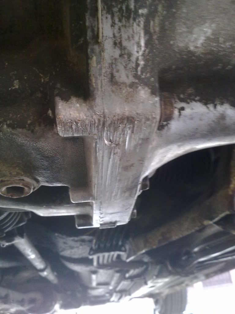

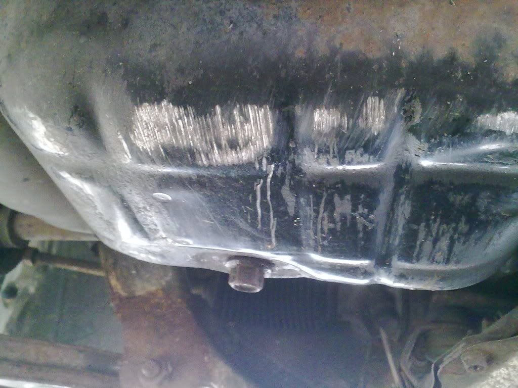

Upon having the car in the air I noticed that the sump had aquired some fresh stratches and a rather deep dent of about 1cm :p I think i was very very lucky that the sump didnt hole!

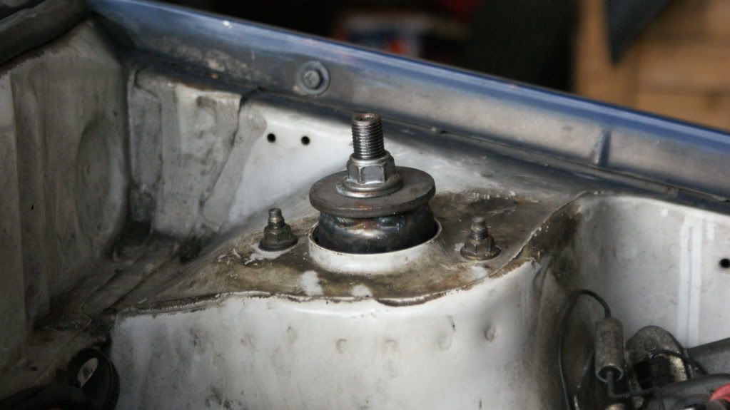

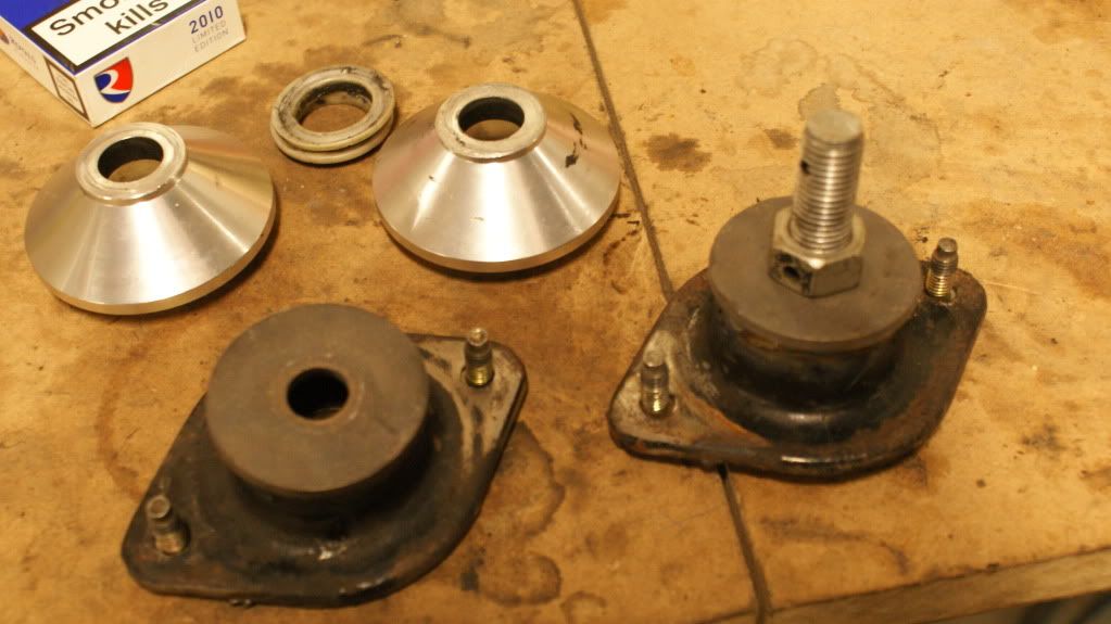

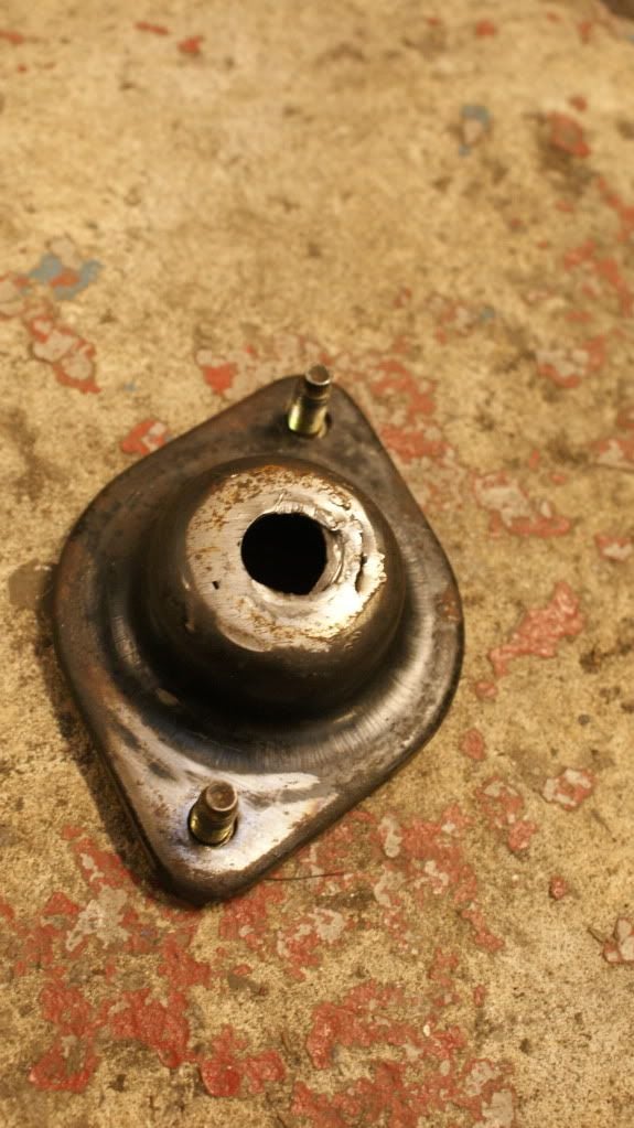

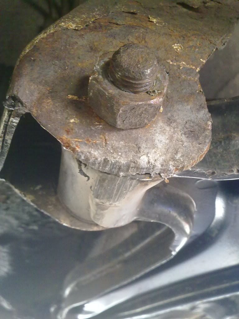

It also ####ed on of my top cups so that had some mega thick washers welded on:

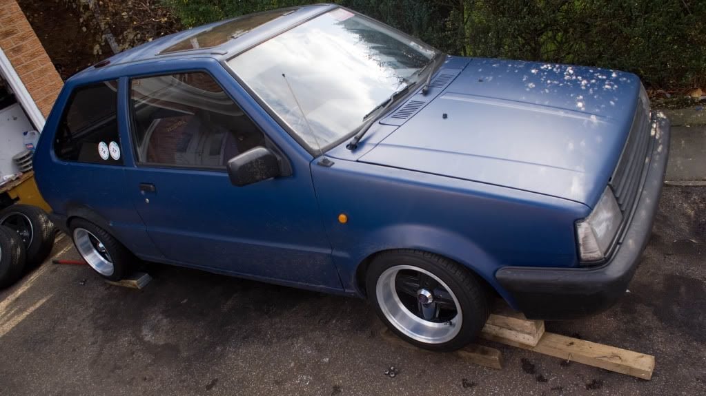

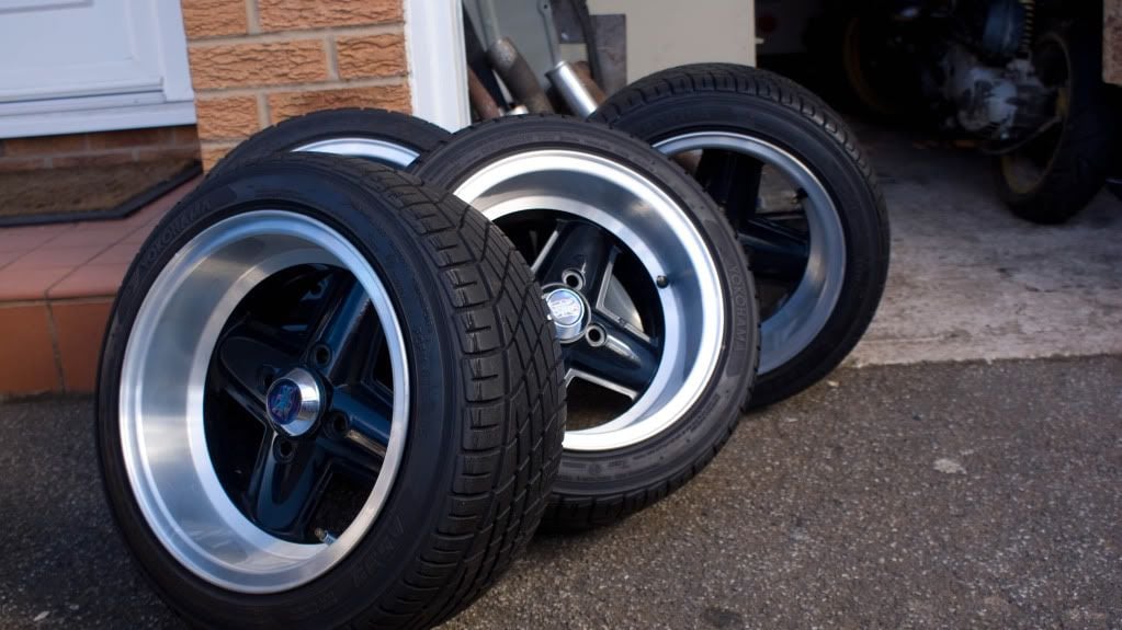

Well, I ended up spending some money again! but in my deffence, they were cheap ;D

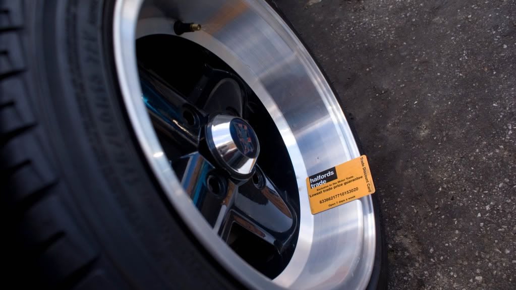

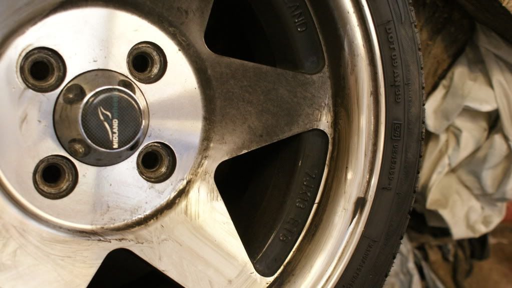

Got dish? :D they're 13 x 7 et-7 Just waiting for my wheel nuts to turn up and then roll the arches some more! lol

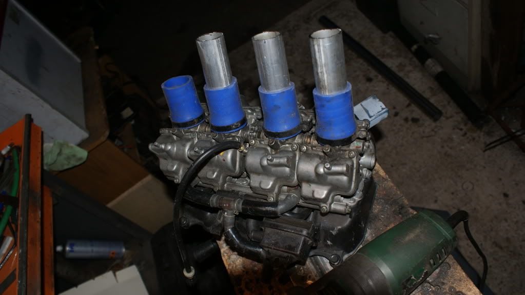

Also finally started on the carbs! Gonna take it to work and use the chopsaw to cut slits into the pipes so I can curve the carbs upwards, then weld it there (free useage ftw :D)

Wheels look awesome but how cheap was cheap?! would love dish like that! (Y)

Including fuel to collect them and the m6 toll, they came to just under £300 :laugh:
jizzed my pants when i saw you rims... nice!!!!
Thanks :D I wasnt too sure when I picked them up, but once on the car I fell in love and went and ordered the wheel nuts :D
hey mate, looking awesome. they are the one from C0llis0n right? are you gonna be running wobble nuts? if so where did you get them from mate? i found some on ebay but they are around 60 quid and that's something im not willing to pay. cheers
I havnt got wobble nuts, and revo's use a special wheel nut and I havnt seen any wobble revo nuts. Gonna try them and if there isnt enough play in the wheel hole nuts (only gotta find 1.6mm play from 2 opposite wheel nuts) and if not then Ill get the holes machined out slightly.

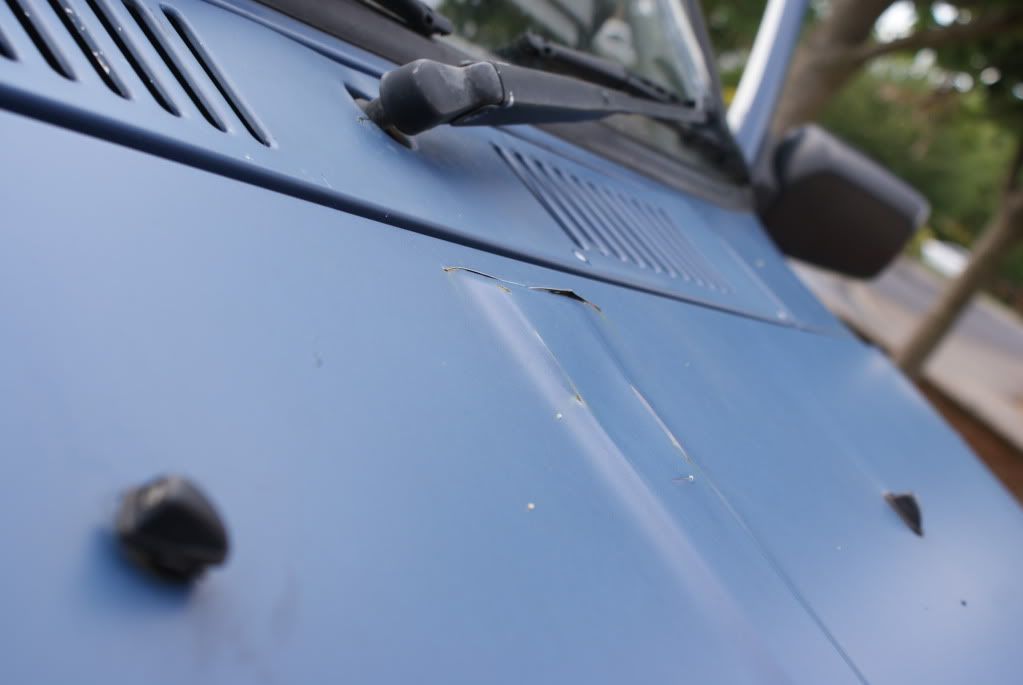

and get it sorted. The paint on it is was needs most attention. The underside of the sills was thin. The rear arches had been pulled after being painted. The paint has started to crack and come off around the rear window and door shuts and a dent in the bonnet where the paints lifted too.
The problem with the paint is that I've got a tin of it which needs to go in a spray gun. Ive got a little compressor and a spray gun which will probably do an ok job. its just where the car is. Over spray would go everywhere and probably onto my neighbors house and car. So for now ive decided to brush paint things. This worked well on the n/s sill but when it came to the o/s/r arch, you could tell it a mile off. Ill probably end up buying a gazebo or something and going over these bits with the gun at a later date.

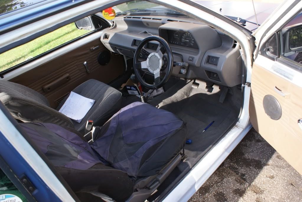

As well as doing the paint work so far I removed the interior and steamed the carpet which then stayed out for months until yesterday when I started to refit the interior.
Just back left to do now. But from now on, every minute I get I'm gonna try and work on it. Ive got a pretty big list! haha

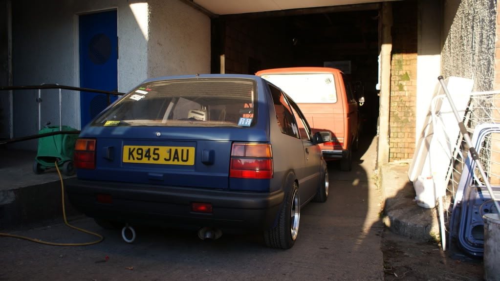

About time I updated this thread!
Well when I was away the sierra got nicked so had to press the micra into service. Unsiezed the caliper sliders, fixed a fuel leak on the carbs and fitted some new front brake pads and off to test she went. 11months after she was last on the road. Just before standing her up she had new front bottom arms, so flew through the MOT with no advisories, also only 900ppm on the hydrocarbons. Not bad to say i drilled the jets out in the carbs and threw them on.
