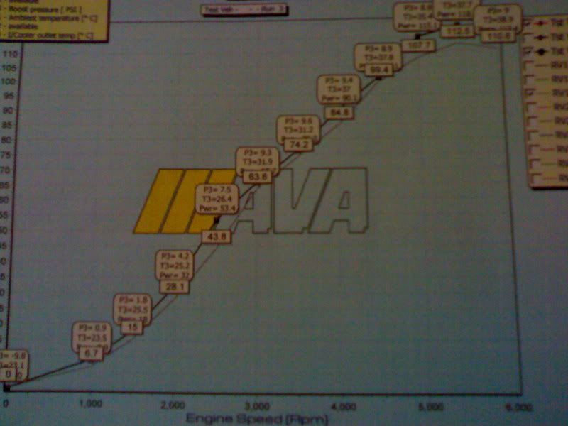

Its currently running just 9psi which is putting out 120bhp at the Wheels!

This is true.. its been mapped at AVA and is running very well at the minute developing quite amazing power..

Ed, I believe Stephen has the read out proving the power. Unsure if he gave it to Kristian or not.
I think this car alone is "real proof" that it does work. And as for reliability issues it seems to have been resonably reliable so far.

PRINT OUT... thin libne was wen i got n black line is as it is now on this map

The Print out above shows 118bhp AT THE WHEELS, this is said specifically on this print out..
Since buying the car ive made some minor alterations to the exhaust and intake in order to make safe some blinding safty issues..
After a quick Power Run today the car is developing 121bhp at the wheels..
