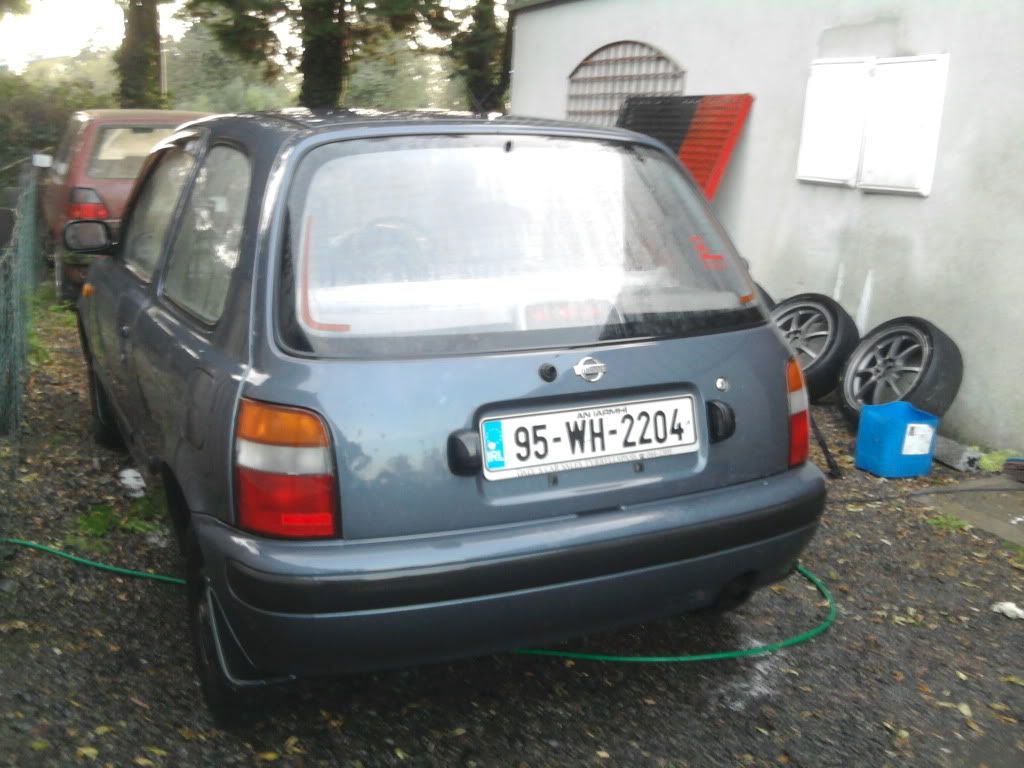

track micra :D
micra being built for mondello park in jomo engineering for 2011 or 2012 as my first track car
no work done yet

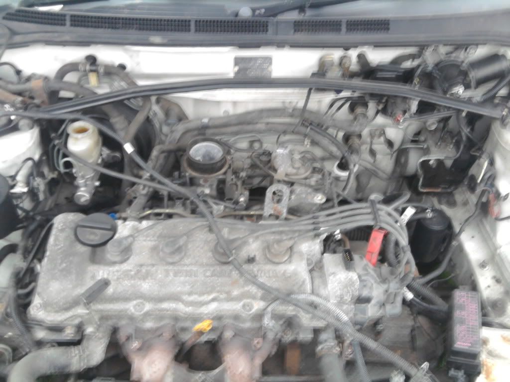

will be fitting a 1.4 engine from a pulsar stripping it seam welding a cage and suspension work and whatever else is needed:p

Keep the 1.3 (if it's got one?) don't think the pulsar engine will give much bang for buck?Looking good though, sell the bumper, you will get some money back.... There rare, good luck :)
just use the GA16de from the primera/almera/sunny exact same as the 1.4 pulsar engine but MOAR POWRZZZ!! :p just make sure you use a pre-nats p10 primera as the ecu should be a straight enough swap! how much is the swap going to cost you?
its all gonna be just time and work i can get the 1.4 for free and its only a 1.0 now i could go 1.6 but i want to start low and race with skill not power (Y) the bumper is staying :p if not a fiber copy as i will blank the heads and just keep the spots or use one head as a cai
im more interested in seam welding caging and weight loss for now :p sr 20 could be done in the future when i have the experience out on track :blues:
ah right mate if its free then take it :D suppose once the base work is down then the 1.6 will be a straight swap then after into the car, what direction are you going in terms of suspension and that? full whiteline kit?

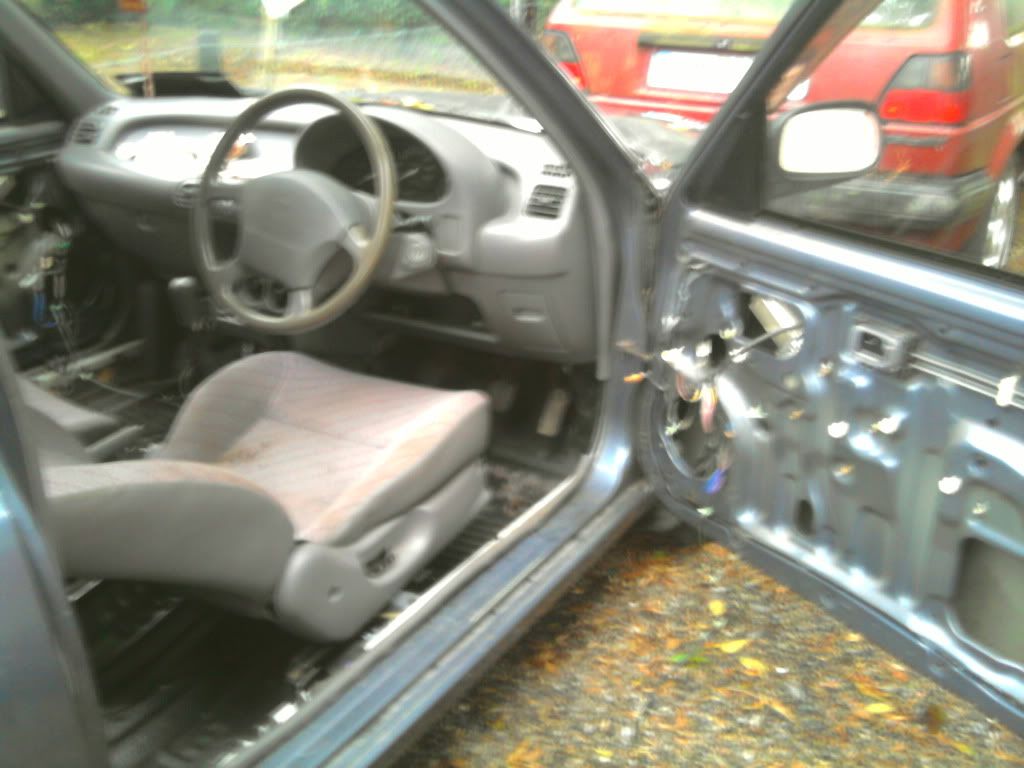

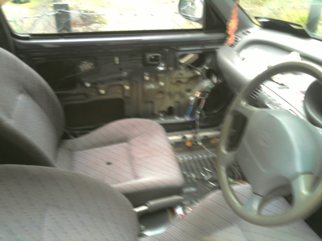

todays progress was just stripping the inside,,the car is a nice spec has ac electric windows central locking and a cup holder :p
hmmm if you want a good track car all those bits need to go mate, if the micras AC is anything like the almeras the brackets weigh a ton and change to manual windows or plexi and do away with them altogether!

anything thats useless in the car will be gone :p ac is heavy in them as far as i know,, all interior is being dumped, all i will keep is the bare shell,loom,seam weld and cage it,1.4 engine and suspension and 2 seats and harnesses :wasntme:

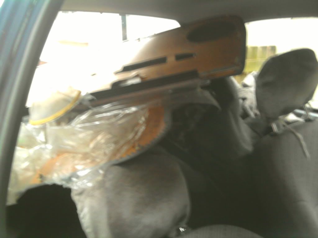

finished stripping everything except for the dash gotta dump it all first :laugh:
should have the 1.4 on sunday and clean the car out on saturday and begin takin up dat sound deadining stuff and the likes

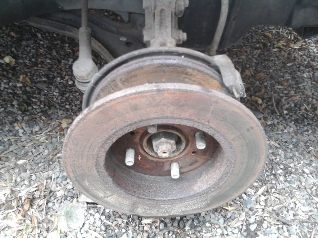

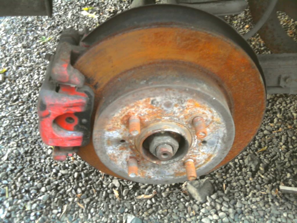

how do you plan on getting rear disks on the micra lad? do you have a disk axle off a 1.3 or are you going to weld brackets on to carry the caliper?
yeah ive heard of it, over in galway myself not surprized you have a pulsar rear axle plenty of the westmeath boys seem to have VZR's, few N1's as well
the fella who owned the pulsar has an N1 a stunning car and about the brake plates if ther will be some involved it wil be made not bought :p

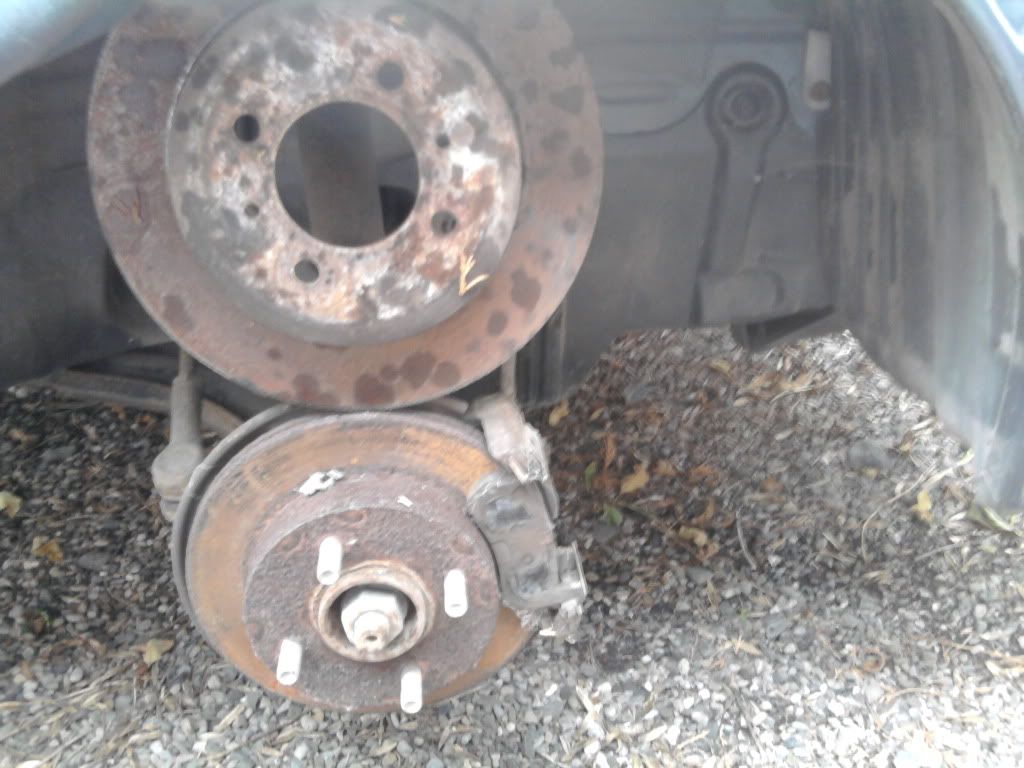

nice difference in the discs from the almera rear and the k11 front:p
heres the almera rear disc on the k11 hub backwards and above
