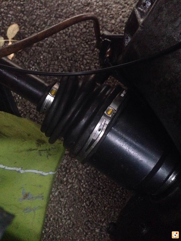

Il take pic later, if you look at the rubber boots near g/box they look all bunched up

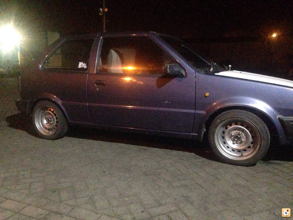

Raised the ride height.......loads better when turning now....... But looks ****, at least I can use it more now

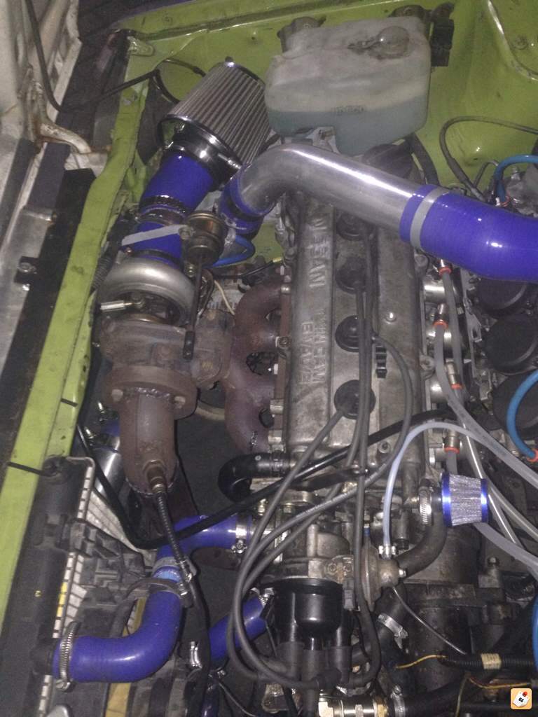

It's been leaning out at top if revs on boost, so fitted a bad boy halfrauds rip speed air filter (only one I could get at short notice)
And also moved the needles one clip up..... Loads better now :D !!!
