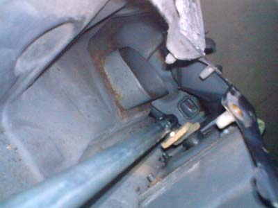

here's the cabin intake btw
dsc09187-jpg.30599
tested the motor and it moves fine.
Ah ha! Thanks for that photo Paul.
That's my first port of call this weekend after finding a nice leak into the passenger footwell last weekend :mad:
