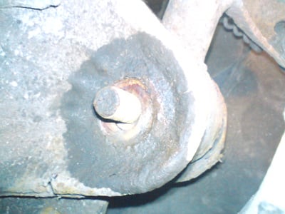

mine used to have a rear left knocking when the rear suspension was going over a bump or uneven camber roads/alleys.
turned out to be a loose rear trailing arm bolt
http://micra.org.uk/threads/pollymobiles-rebuild.35251/page-104#post-659834
dsc09038-jpg.28263
replaced the bolt and was quiet.

Like someone tapping a section of the chassis lightly with a small hammer due to the bolt rattling n banging within the bolt hole when the arm was loaded over a bump.

Is it a case of retighten of did you replace buddy?
I tried retightening but it had ran for afew years in loose state before fully seizing to the bush, so no amount of tightening the nut would ever tighten the head end, hence it still knocked and ended up cutting n replacing the bolt.
