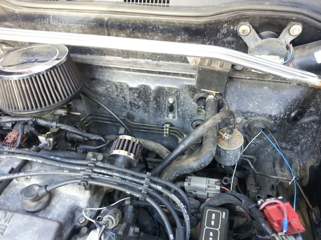

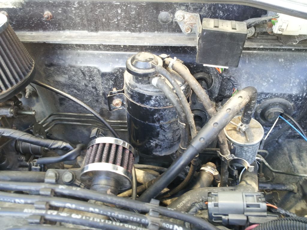

I presume the big one is the route the recaptured fuel would take back to the tank, rather than a vent. It still has to be best to block otherwise fuel vapour from the tank will be constantly leaking from it eh? The piece that goes to the inner arch has to be simply an exhaust pipe for the canister and can be totally removed.the big one is the vent from the tank iirc, and the ones to the plastic valve on the head can be left (i smash the plastic bit off mine) the little t/b one is just light vacuum because its above the butterfly (but probably best to block it anyway)
nah, the carbon canister does,nt store any fuel, just vapours, the fuel delivery and return are separate pipesI presume the big one is the route the recaptured fuel would take back to the tank, rather than a vent. It still has to be best to block otherwise fuel vapour from the tank will be constantly leaking from it eh? The piece that goes to the inner arch has to be simply an exhaust pipe for the canister and can be totally removed.
Get that waxstat mech off skymera... the green spring thing.
Is that your cai down to the underside?
Vapours yeah, don't they kinda condense or someting and run back to the tank along that pipe then? Otherwise why would it be connected to the tank?nah, the carbon canister does,nt store any fuel, just vapours, the fuel delivery and return are separate pipes
how else would it collect the tank vapours ?Otherwise why would it be connected to the tank?
out of interest why do you want to remove it?
i did this to make the p11 airbox fit
i think that vapour return pipe is also the fuel tanks sort of breather?
cos the tank is a fully sealed up system, as you use up the fuel the missing volume of fluid has to be replaced by the same amount of say air via that return breather pipe.
if that breather pipe was blocked off, as the fuel level goes down it'll create a vacuum inside the tank and could make the tank slowly implode until you open the fuel cap and the mass of outside air rushes in to replace the vacuum.

Stupid question, do you just block the pipe line 2 the carburettor and leave the other two, to vent to the atmosphere?Now you see it....
