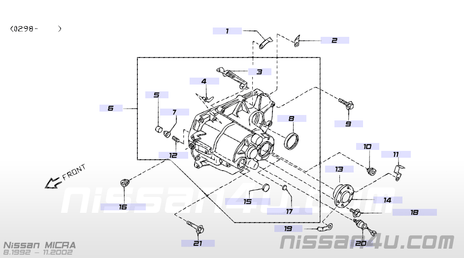

drain plug is number 16 Asif, right behind the rad
About the "gravity" your right but when the GB oil comes back out of this plug hole you know you have the right level... as long as the car is level too :)

ive always used no.18 in that diagram as the drain, gives you chance to clean any swarf off the magnet whilst its out

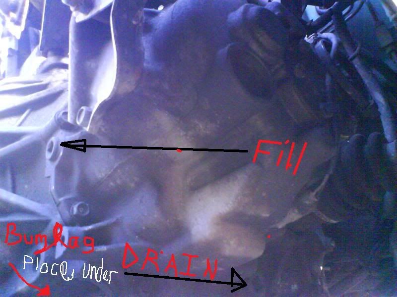

Hey reg that looks just about right !! i jacked the car today and it looks like those are the same both have square holes in :p thankyou to everyone who contributed :D now just need some piping to fit into the filling hole lol
the pre face has a plug on the bottom that u can remove to drain the oil out from
and then just fill it back up from the speedo hole
1.0 small gearbox drain hole on bottom
