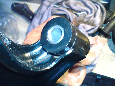

Pic of them (different colours will be for different stiffness ratings):

The bushes I have made are designed to fit without removal of the metal sleeve so burn out the rubber and fit new poly. pretty dam easy! I think the hard part could be the bolt for the front bush but frank seems to have worked out a pretty easy way for that even.
Its the stiffness I need feedback on really. Would people consider solid bushes?

No problem Matt. Iv got everything I need to make those. There are a couple of types of wishbone so will need to know which you have. If you email me or send a message through the nodspeed website site (link in my signature) we can sort it :)
So it turns out the OEM wishbone bushes are less stiff than at first thought. I borrowed the durometer at uni to check and it turns out they are around a Shore A60 (brand new).
The polyurethanes I have been using are A70 and A85 so 15% and 40% stiffer :) So I will be sticking with these options :)

the PU is stiffer, less give than rubber and is not bonded to the metal insert so:
- forces are transmitted to the chassis faster = faster response
- more % of the vibrations are transferred to the chassis rather than being absorbed by the rubber = more feedback sensation
- less deflection = more consistant arm position = consistent suspension geometry/alignment & handling
- bush can spin freely around the metal insert without twisting itself apart
- able to withstand higher forces for longer periods = durable
