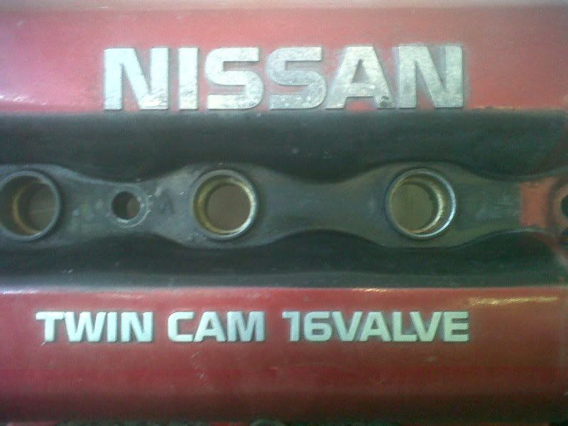

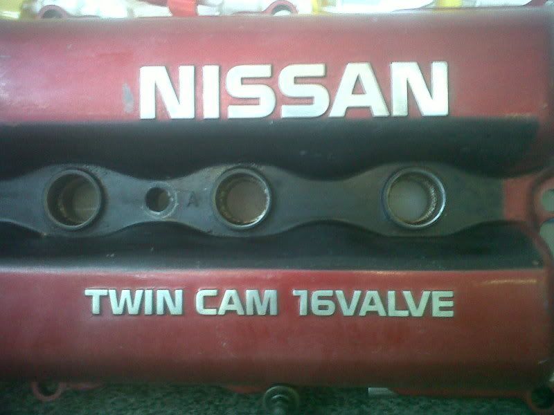

The SR20 you currently have fitted is the better option because you have a lot more cam selections... that is a roller-rocker Sr20 out of a p11
The car however, looks really really really good !!!

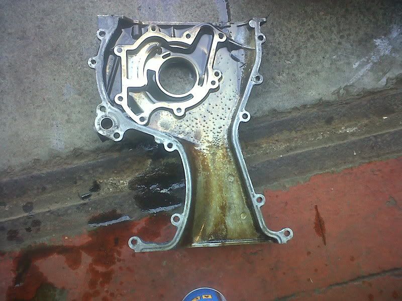

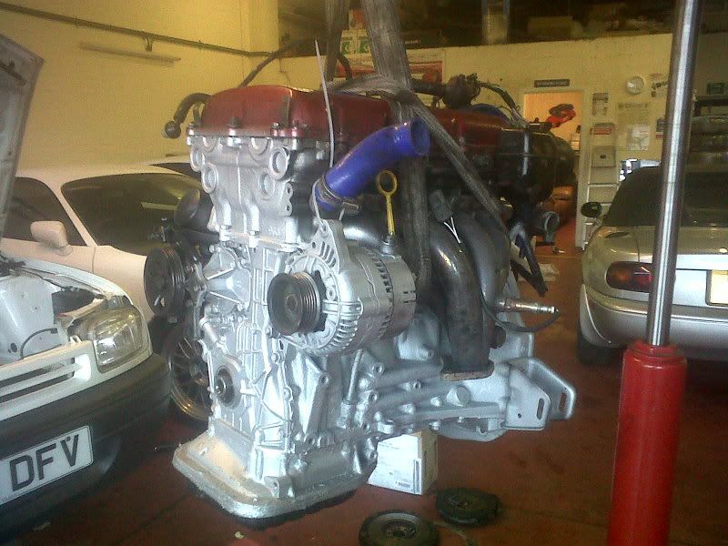

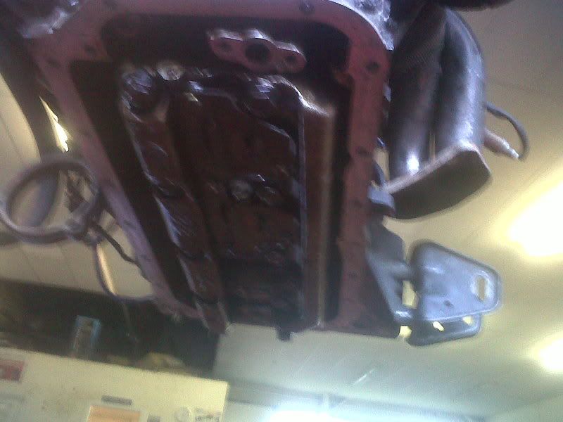

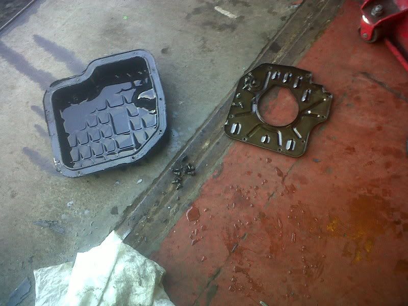

I'm planning on keeping the highport I've only bought this block to swap over timing chain cover upper and lower sumps as previous owner has cracked them causing to leak a bit oil .
And thanks :) should be finished by end april fingers crossed
you will have to do a little modifications to the breather pipe parts on the cover, not quite the same... IIRC ... you can fit a p10 cover to a p11 engine but not a p11 cover to a p10 engine. Can't be much work though as the bolts are all the same :L

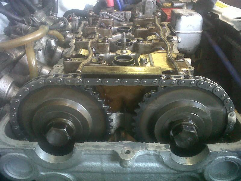

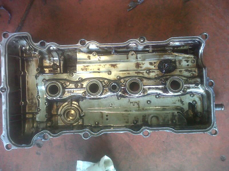

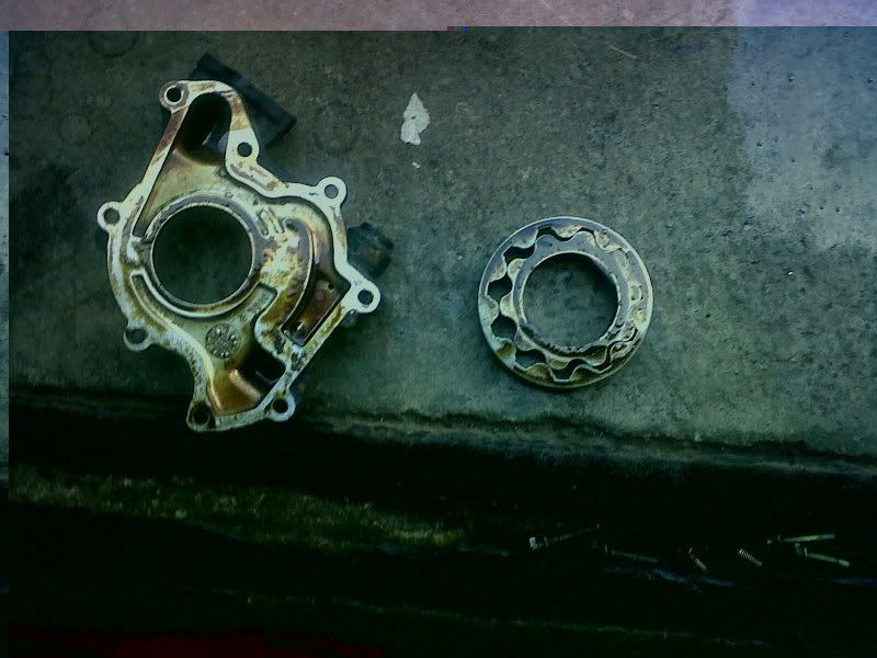

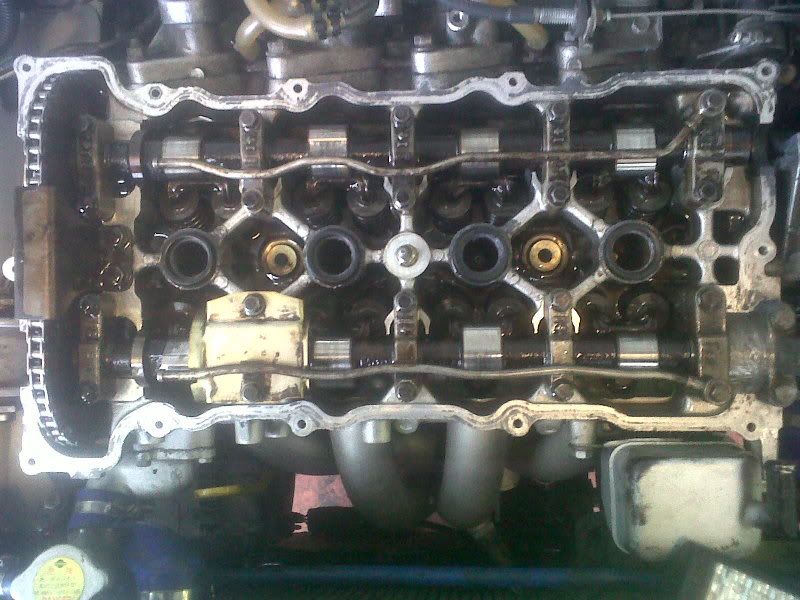

new chain and gears fitted rocker cover refurbish.

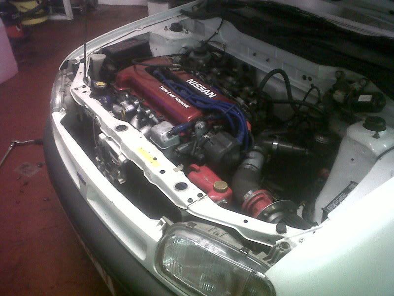

engine bay nearly complete just need to finish off the induction kit to help keep it cool
update : im loving the car really glad i stuck to getting it finished. got a short vid of a driveby will update by the weekend. also be able to tell the mpg gone 120miles on just under half a tank so far so it aint that bad not much different to my si
good job mate, crazy bumping into you at Jarrow of all places LOL. Car looks smart on the road in person. Yea I found my mpg was actually better than it was before. from 38mpg to 45-50mpg on the motorway.

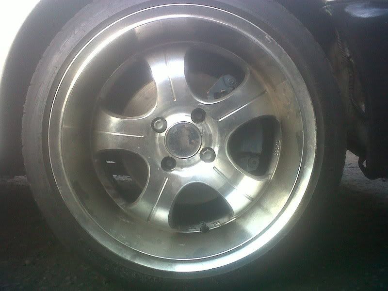

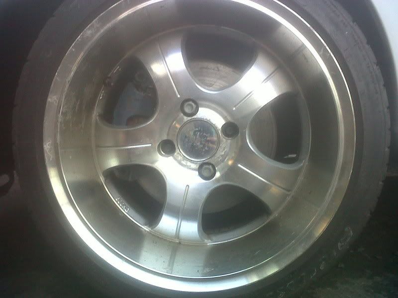

nice build so far :) i'd personally lose the wheels and get some hubcaps or banded steelies and go sleeper....

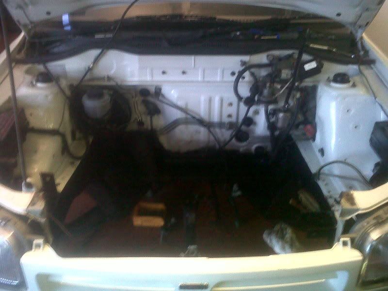

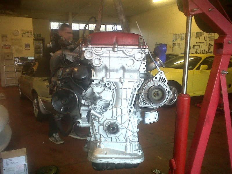

next step. change SR20 out for the R34's engine in 4th pic. now THAT would spin your wheels, in 5th :p
