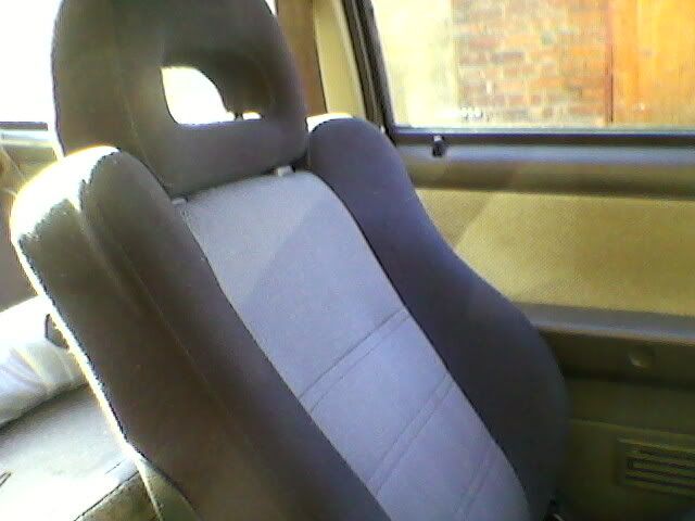

gti seats are quite simple mate 3 of the bolts line up and the 2 rear ones closest to the handbrake need drilling although i haven't drilled mine yet :p i will say tho you have to be a patient with lining the bolt holes up as they are a few mill out each side you could drill them but i just used some strength and made them line up:laugh: they give a lot better seating position

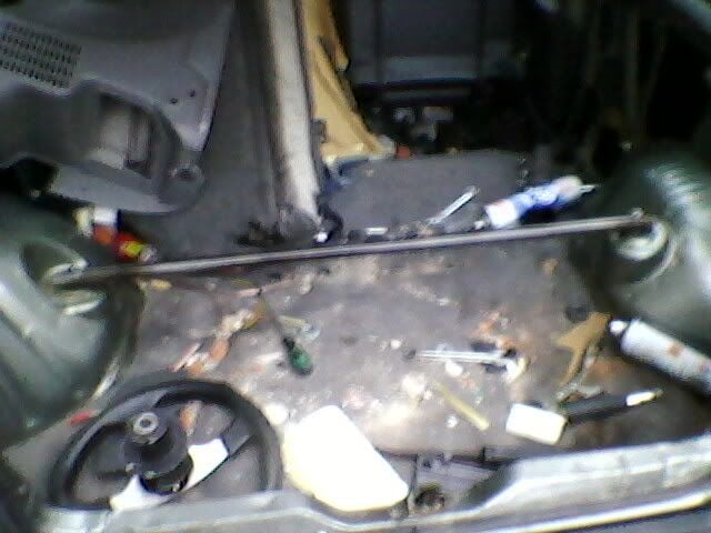

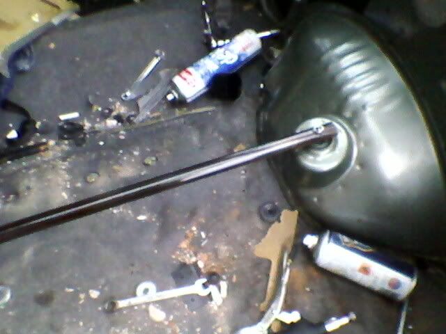

ok so i was board yesterday and started looking at my weight lifting bar that i gave up using and thought instead of chucking it what can i do with it well i made some use of it :p

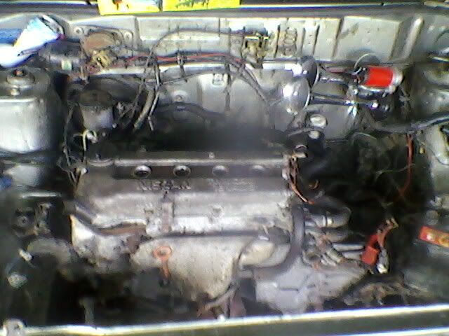

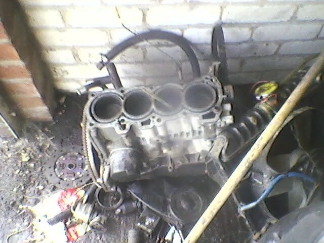

well last couple of days ive been tinkering and now i have a cg10 bolted in thanks to gtsnissanb. i haven't got it running yet as i need to mod the dizzy and make the manifold for the bike carbs. but this will not take me long once i get cracking i dont stop :laugh: i will try and get some pics tomorrow if i dont forget to take my phone again lol. the cg10 will soon have cg13 crank and rods but for now i just want to get it running.
Very nicely coming along might start on one of my cars soon lol, rear rear strut brace is a good plan, maybe get down to b&q get some threaded bar and two nuts cut the weight bar in half cut a chunk out of it slide the threaded bar in-between with the two nuts in the middle then voilà adjustable strut brace just wind the nuts out ;)
Given myself an idea now
yeah thats a sweet idea bud im going to ditch the weight bar for something a bit tougher it flexs quite easy. it made quite a big difference tho (Y) your idea is a brilliant one mate and i bet it would make a huge difference and make it easier to take on and off without wrecking the strut threads.
hacksaw/grind the weight bar down then hammer it between the rear turrets :D
it would be better between them :)
maybe a blob of weld on each end if you can weld or get it welded :D
that sounds like a good idea mate i might put 2 on in that case one at the top and one between the turrets (Y)
attaching to the top of the struts would be best but his attach to the nuts not the struts so will still move a bit.
between the struts or anchored to the top would be better :)
I see what you mean now it's bolted directly on the strut tops and not the strut turrets ;)

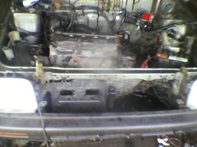

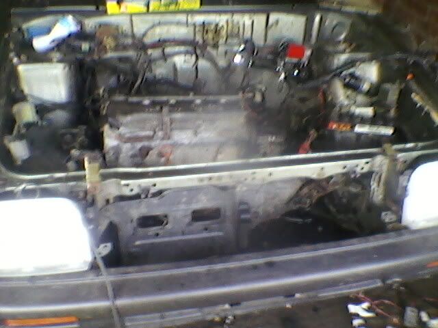

well ive been down the garage and fitted the inlet mani one less thing to do. the modded dizzy is yet to be took off but i couldn't find a 12mm think someones been in my toolbox grr anyway heres some pics bit crappy quality i had a wobble on it was freezing lol.

cheers (Y) yeah its getting there i just need the wiring loom and ecu and a fuel pump then it should run:grinning: cant wait to drive it now lol
