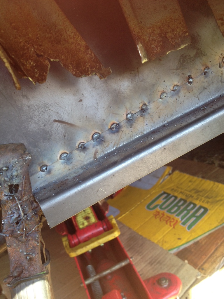

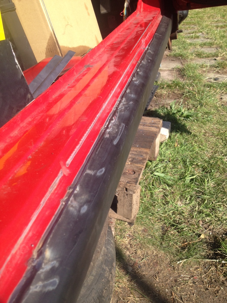

hi my sills cost 18 pounds and took me 3 hours, cutted the inner out and made a 1 inch fold, garage would cost 200 I would say
Ok many thanks for this. Where did you get your panels from? The cheapest I have found for full sills either side is £49 on EBAY.

Sheffield parts have sills only 18 pounds each, u can buy a Micra at 300

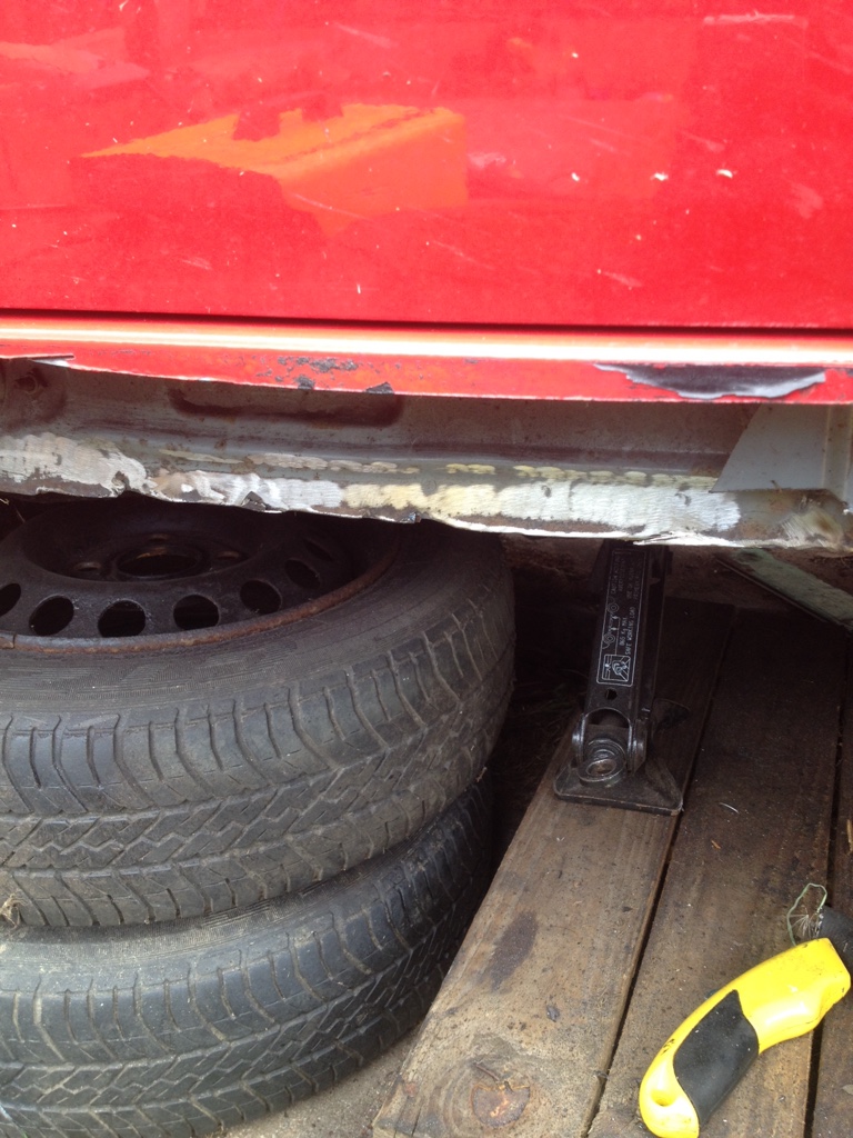

Just to give an update. My Micra passed the MOT. Another one saved for another year (& a few more hopefully)!
Had a lot of welding for £250. I felt it was worth saving.
Very pleased to keep it going!
Waxoyl was put in and understill for the outside. Hoping for the sills to last until 2017/8, that is the plan. I won't be doing them again!

I just got my pre face lift CVT auto through the MOT this week. It wasn't cheap at £450. The rear arch required welding and some other bits and pieces such as brakes. Though it's through to Sept 2017 I've been advised the other rear arch is showing signs of corrosion & will require doing next year!

Panels for u do German parts, full sills and sill skins, I have a full sill ordered so hopefully they are good. They do arches too tho I hate the quarter panel warping after welding
Panels for u do German parts, I have a sill ordered so hopefully they are good. They do arches too tho I hate the quarter panel warping after welding
Hi mate are you getting sill skins if so be great to see a pic of them thinking of replacing the sill skins on my 1996 SR! B-)
