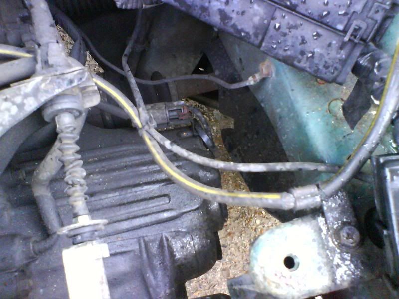

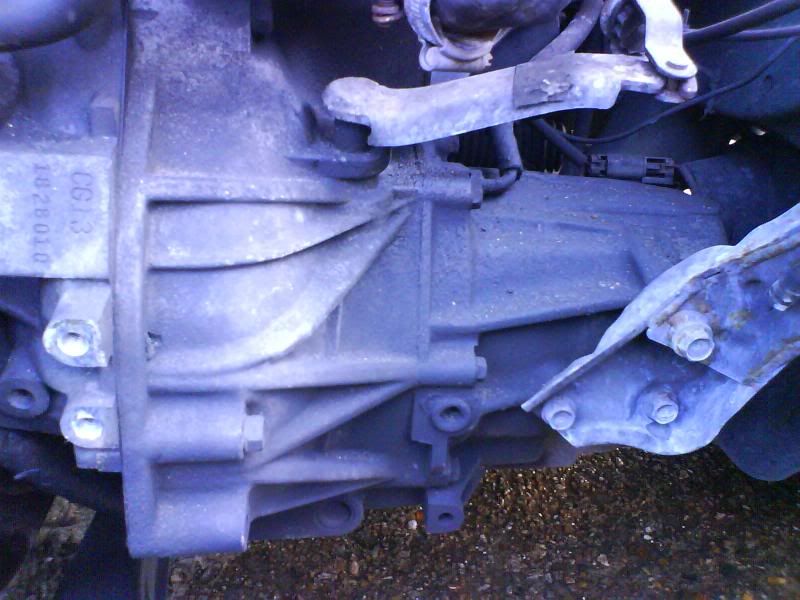

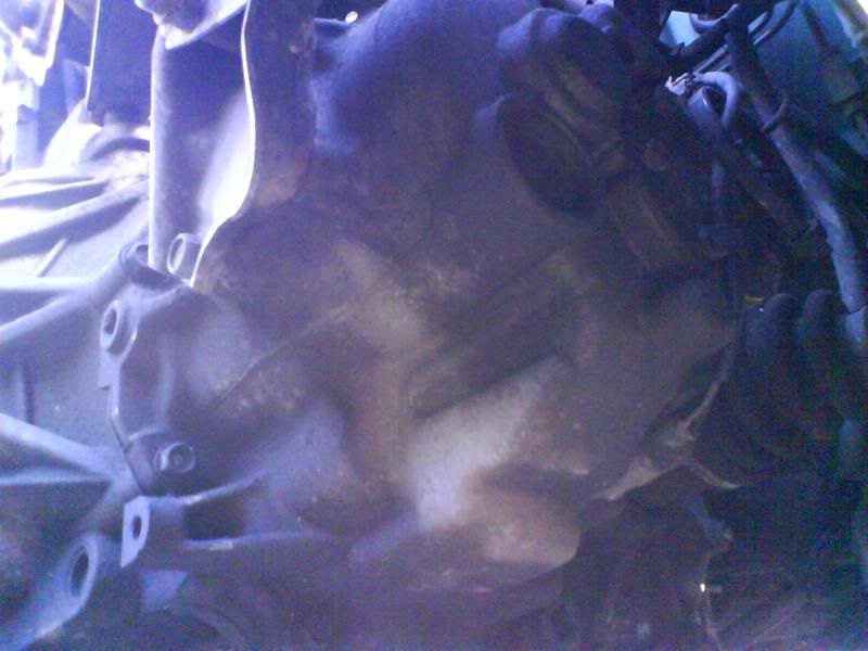

this is the box in the SR (1.3) at the moment, Mathew ID'd it as the facelift 1.0 box when i went Oxford to get a 1.3 one off him

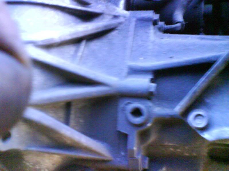

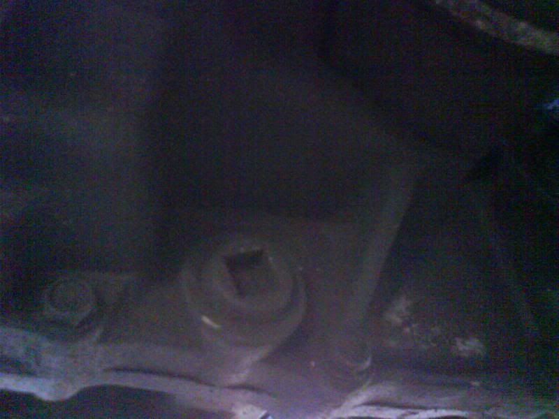

pics for anyone who is wondering

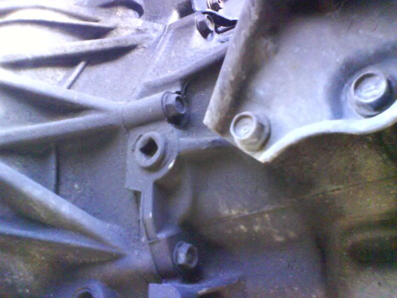

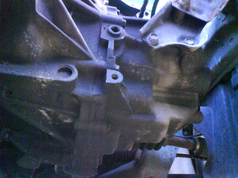

filler plug on the front

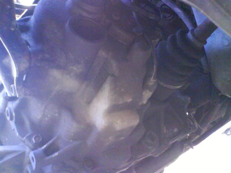

drain plug passenger side

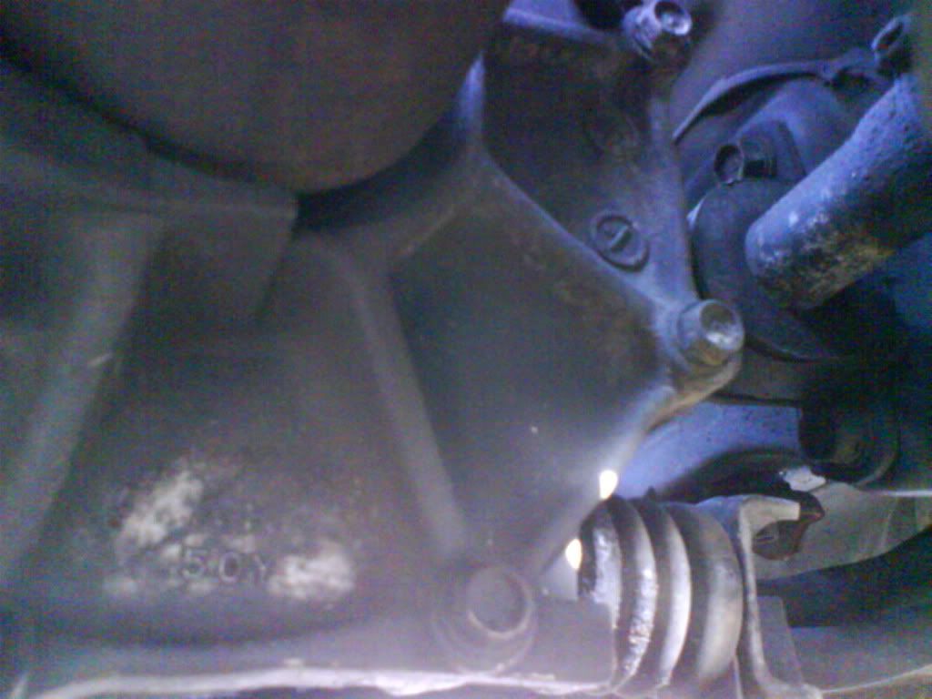

its a type 30, but matt said you have to count the crownwheel teeth to determine which diff it has (74 iirc)

found numbers on it
