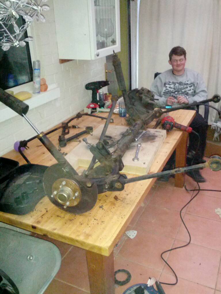

Oh frank and Paul. I did get a disk axle in the end. Cleaning it down and painting as we speak.

Modeled by mas the k10 owner. Just shows up here as usual to make it look like he helped with the build.
