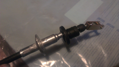

spotting tday an oil stained top near spark #1 was cos of a perished rubber seal, perhaps this could be part of the reason for little oil loss and burnt oil smell? so will need to replace the leads. asked in buy sell for a set
the brake pedal also rattles alot annoyingly on motorway so tried tying the rivet to the pedal to reduce slack, didn't work so will also need to replace that too.
and then as I got more oil from halfords, Kasandra threw another fit n reveal another weakspot by snapping her clutch cable as I was about to drive off back home. Oh FFS good thing this didn't happen on main road :rolleyes:
as you see the cheapo plastic outer cable end had sheered off under the heavy clutch. good thing I brought my tools in boot, time to improvise a get-home-fix
tried keeping the plastic outer end in place by afew zipties but simply slipped back after afew test runs
had to ask sister to grabbed some wire n tools from home and secure it abit better now but didn't position it far enough thus the biting point was far too low to barely work n the wire was slipping. but was getting dark so lets risk it.
barely made it home with almost no clutch, had to try clutchless shifting through town :/
just as I arrived home, I ran outa clutch travel cos the wire had slipped too far but just pushed the car back into the garage.
OK car will now be grounded for afew days, replace the clutch cable with preferably a metal ended cable (posted request on buy sell), swap back to stock setup before going to andys to weld n swap tyres

sorted now.
went to partco to check the BluePrint one they got, yup tis all metal :cool:, £24
here's the pedal end
removing the rubber seal, it's all metal inside, gr8 should prevent this all happening again
cable made in japan by SBK
the gearbox end, still gonna drill out n replace the weak rivet end

clutch bite point was still too low so lets remove any rubber bits
imag1281-jpg.35146
replace with a solid spacer such as a big nut
space it out a further few mm
so now I can feel the clutch pedal travel past the springy crest of the PP. check the bite point tomorrow
