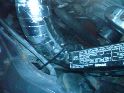

I've tied it to the chassis here and it's pretty secure nowPaul please make a simple bracket to support the weight of that MAF and give your TB hose a break

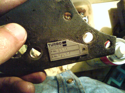

and their pdf catalogue saysThe S116 utilises the standard T2 unit but is supplied with a larger compressor wheel and housing, to increase power, and is matched to a larger turbine housing which will increase flow, with minimal effecting on spool up times. A fully screwed down 270 degree thrust bearing is used, enabling higher boost applications, while helping to keep costs down. The unit comes supplied with a dynamic seal to help improve response, and an uprated actuator means this unit will safely run up to 13PSI. With minimal engine and fuel modifications, this turbo will flow enough for up to 150BHP maximum.
Lol my t2 is still boosting with 3mm+- play on the shaft... I call my turbo... "The Grenade"found my turbo spec.
remember my actuator plate said turbo technics part # S116
and on their website its a S116 Renault 5 GT Turbo Stage 1
http://www.turbotechnics.com/turbo/s116.htm
Renault 5 GT turbo stage 1 hybrid
1987-1990
T2 with 60 trim / 0.47
rated 130-150bhp (so I'm running at it's limit)
