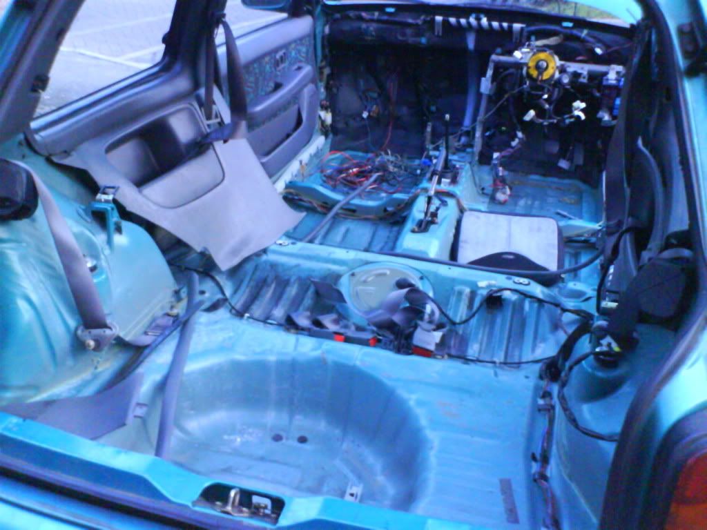

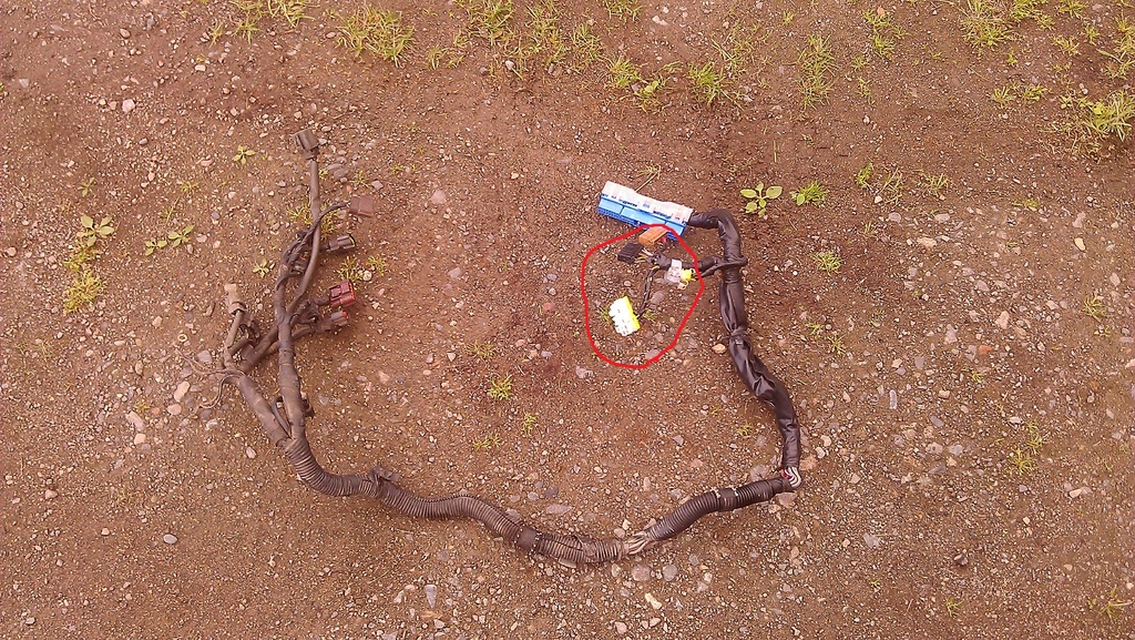

Now i have the CG10 + ECU and wiring from a 1994 K11, i only managed to get the wires that go between engine and ECU, the wire where to connect the computer for mapping i couldnt get, its meshed with alot of the cars other wiring...

possibly showing what the rest of the wires are meshing with ive just done a cg10 to a cga3 conversion and all i used was the engine, ecu, chip from the key and the ring from around the ignition, but i needed key and ring as mine has nats

I know what they are meshed with, the go to fusebox and alot of other things. do you have a pinout for ignition, fuelpump etc on the engine loom?
The connectors are the ones i need to know what is what on there.

i only have two white plugs that i can see of mate they plug in just under where the ecu sits

Yes :) or like something that show what pin on the ecu box is what, then i could just take my multimeter to figure out the cable.

i dont sorry mate someone on here might if you post in the k11 section they might have the ecu pinout for it
First think i can see missing is the eccs relay...should be a little green relay that has 2 thick wires and 2 thin wires into it (thick are green/white afaik and thin are red) this would have been very close the the 3 plug connectors that you unplugged. It is actually a very easy loom to wire up, i ran a 12v feed via master switch to one of the thick green/white wires and a switched live to one of the red thin wires and then the normal earths are connected. for the fuel pump i just ran a switched live via a relay, bear in mind this was for racing but i did use the standard nissan in-tank pump, fitted to an alloy tank. Make sure to use fuses for road use though. The haynes manual has the pinouts you need, i have one but have no way of copying it onto here for you.
The loom is all self contained except the alternator wiring, this is up to you but is also very easy to wire up as the alternator itself has a small sticker with the signal,live,light positions stamped on it....unless your lucky and have an alternator with just 2 bolt on wires

Could you not take a photo of the page? :) Since my car is a K10 i don't really want to buy a haynes for the K11
