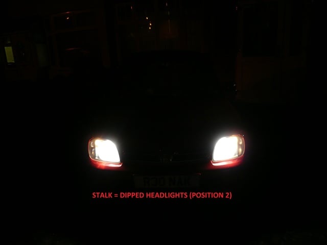

EDIT: Decided to take them now anyway lol
I should also mention that when I put the indicator stalk to the second headlight position which should be dipped headlights - I get the high beam indication on my dash

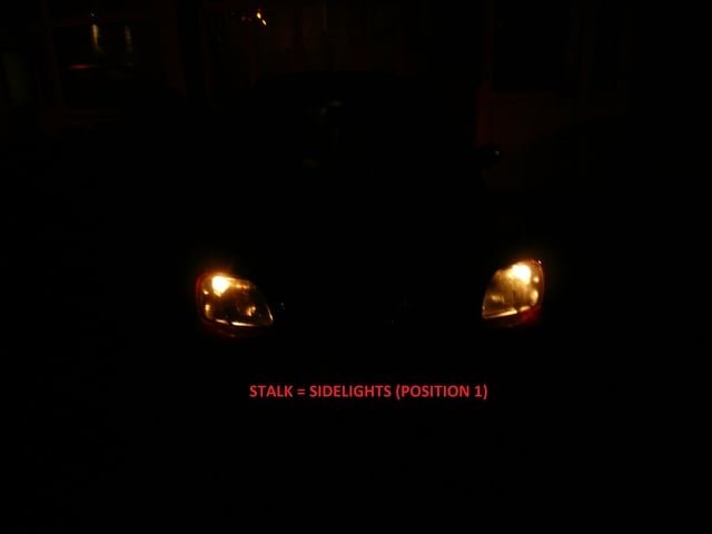

Here is sidelights only - DASH INDICATION OFF
Dipped headlights - DASH INDICATION ON

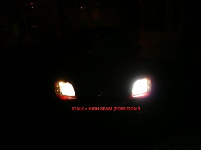

Main High Beam - DASH INDICATION ON (Compared to the previous picture (Dipped), the Right got brighter and Left actually became more dim!

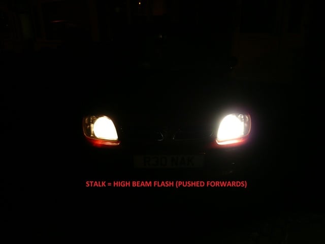

"Headlight flashing" position where you just push the stalk forward - DASH INDICATION ON

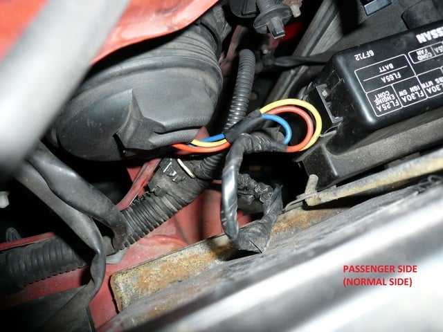

Here is the normal connector

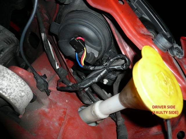

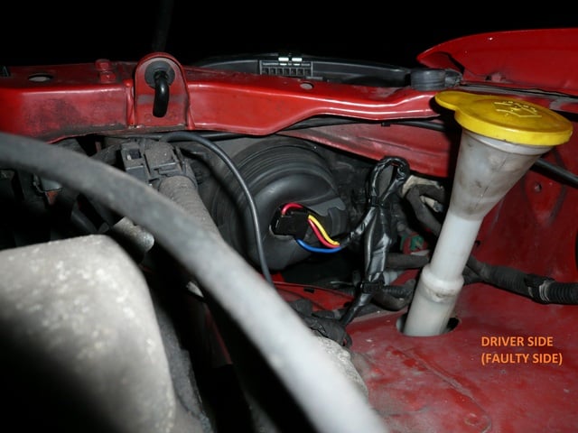

Here is the abnormal side
On the Working Side, the High-Beam does seem brighter than just dipped on the same side - the picture does not do the lights justice for this!
On the non-working side, Dipped are actually BRIGHTER than high-beam!
