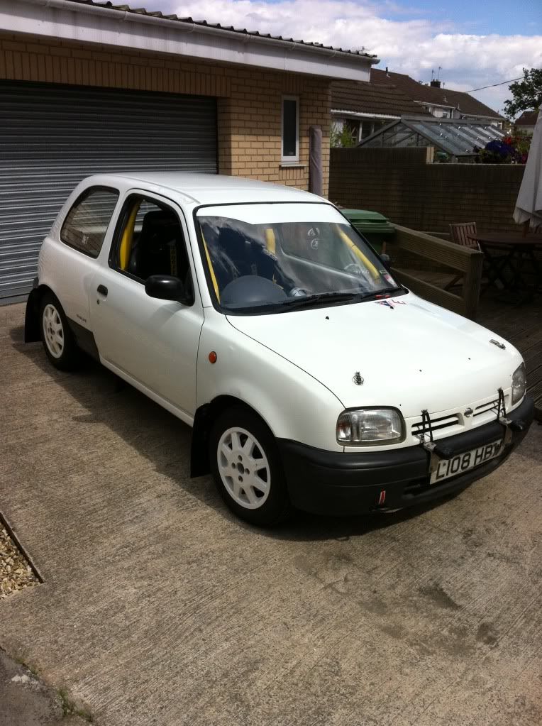

Hola been posting various pics so thought should start a blog.
Bought this micra from a mate a few months ago.
The car is stage/ road rally car with lots of cup parts, suspension, cage, guards, 5.1 cwp and gripper plate diff. The car goes ok and has currently got 116 bhp ( 95@wheels)

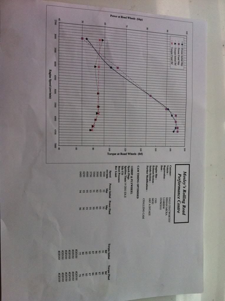

Went to dyno today.
First run made max power of 111 bhp.
Second run with new plugs, took off dizzy and upped rev limited, made 116
Third run, adjusted cam timing which was a bit out. Both cams needed tweaking, had a quick run up to 7k rpm. Was going to do another run to record power 500 rpm per time and the car started misfiring heavily under full load. Checked cam timing, fine, checked dizzy temperary mod- fine, car misfires heavily under any load now. Had to leave it at the rollers. Would rev up fine at say 25% throttle but any more and would say that it sounded like it was hitting a rev limiter. Checked fuel pressure. That's fine.

Car made 96 bhp at wheels so 118/119@ flywheel? Made a little bit more mid range power. Gained 6 bhp at wheels from first run up. Happy now at it's optimum.

Will post up dyno sheet when I pick up the car tomorrow

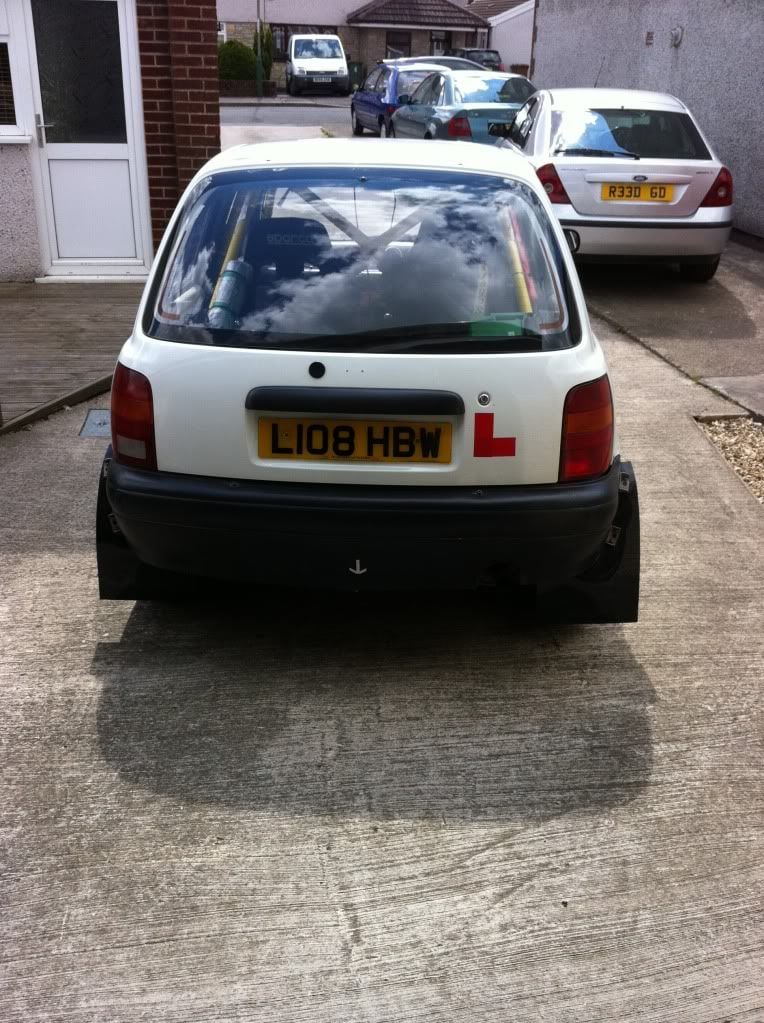

this may sound dumb but why the l plates? is it because your a beginner at this?
is the car fully road legal?
if so id suggest bringing it to JAE show how good these damn cars are!
Yes the car is legal. The L plates are just a Mick take because looks like a school of motoring car. Never thought about taking to a show before. Track day thing is it? I've only really done rallies and road rallies

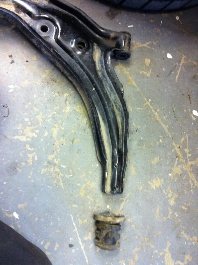

Found out what the issue was. Picture below. Was banging a fair bit and handling was bit weird but thought it was due to the forestry roads. I'm assuming this isn't unusual

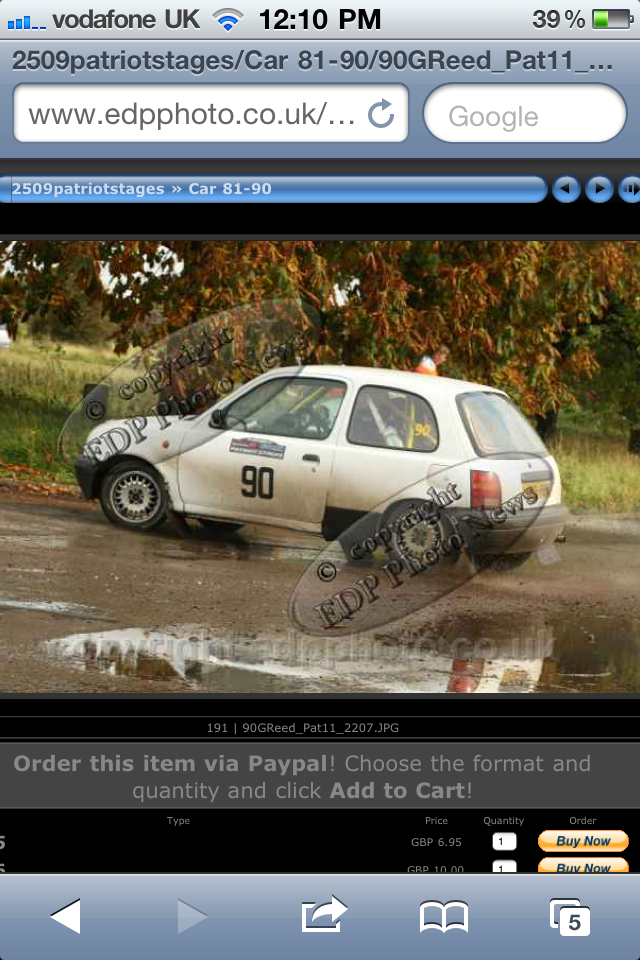

Recently competed in caerwent patriot stages rally. Was really good fun. Slippery in the morning which suited the small power micra. Came 43 oa out of 100 starters. We started off in 30 second intervals and on the first stage we passed 3 cars!! Pictures below on a hairpin right. On the handbrake
Quick update, did the mel harries memorial rally on sat night with a mate on the maps. Car was superb as the tight and twisty lanes were really slippery and muddy. The conditions really suited the car which enabled us to catch a few cars as bigger engined cars struggled for grip etc. We were setting top ten times overall on first few selectives according to my navigator. After petrol we had to travel down a White (country lane with an unbroken forest/gravel surface which normally only used by landrovers etc) as we were catching a c2 I got a bit over excited and kept it flat out in 2nd gear at max revs and after a few large holes and heavy landings the wishbone snapped again. Bit slower next time. The wishbone was only changed few days before as bent the previous one during breaking.

Their only about £30 each new so I know the bushes are good etc. I used up all of my stock of 2nd hand ones. I was a bit over the top down the White to be fair to the car. It's strong as hell though. Fully seam welded, strut brace and full multipoint cage.
