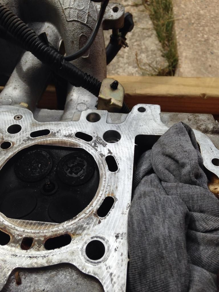

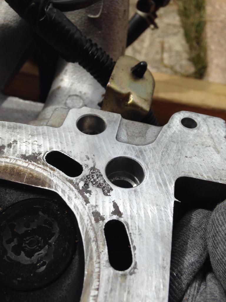

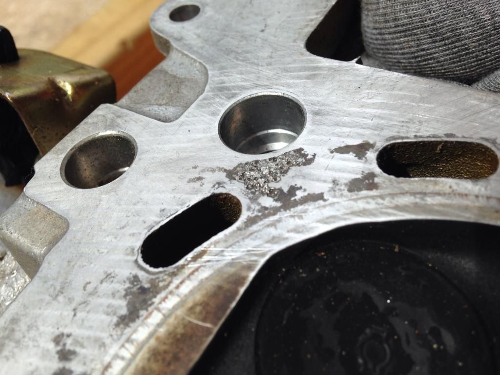

it's fine, all the important sealing surfaces like the cylinder fire ring and oil supply port looks clean n smooth.
the pitting is caused from lack of coolant change/quality over the long years were the coolant just errodes at the exposed head surfaces.

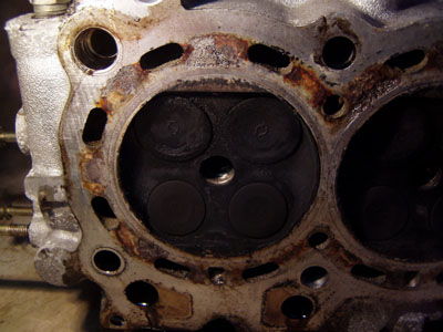

shoulda seen mine when I first started rebuilding
http://micra.org.uk/threads/pollymobiles-rebuild.35251/#post-381092
