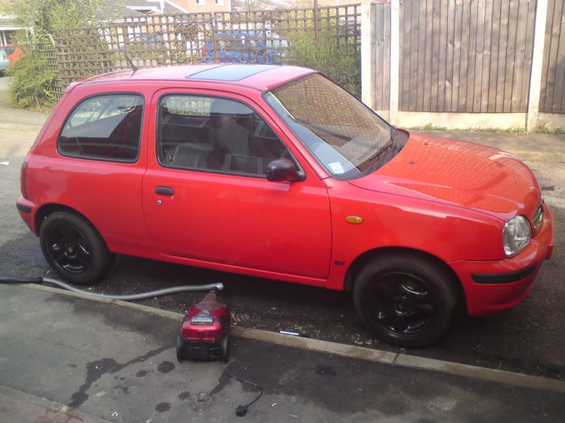

There you go.
wiked:grinning:

Top work Dave ! Now you only need to remove that side 16V badge, it makes me think of those 16v Twingo "oh look, I have a 16V engine, it's so incredible for a ####ty french car, impressed eh" :wasntme:
I've only done one side of the de-stripping, badges go last ha ha, there is so much effort involved.
