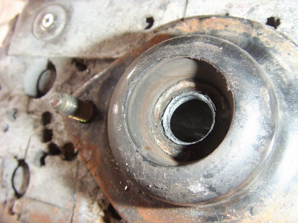

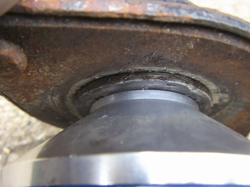

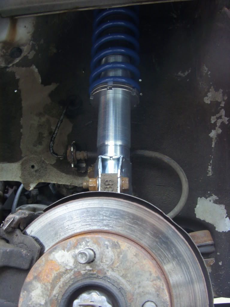

just seen this and the cheapest easiest coilovers are polo 6n ones. For the front they require:
# top mount drilling out

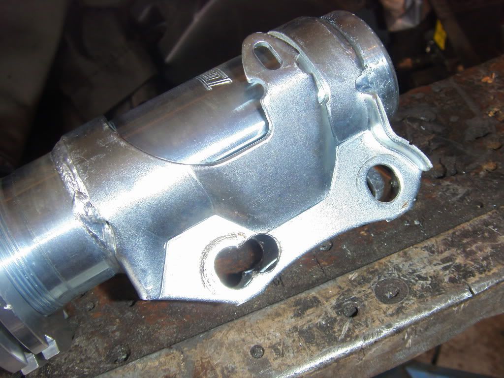

# coilover body mounting plate things drilling
Idealy you need the top spring cup maching too so that the bearing sits on it properly, but I havnt yet and its been fine:
Fitted
