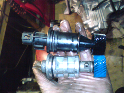

i think paul (pollyp) said that there is a slight difference in dia between the electronic and cable speedo drive kev :)
yea electric speedo was 36.75 dia while the mechanical speedo was 37mm
dsc04447-jpg.29561
