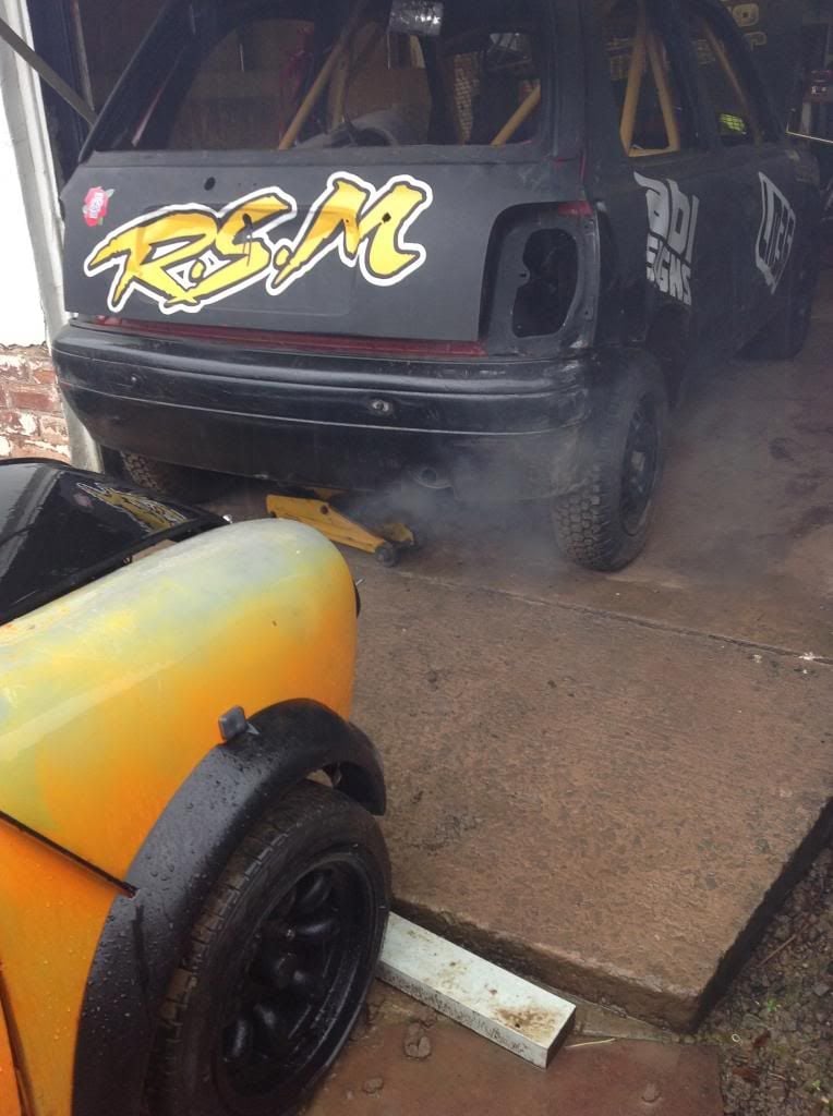

Noticed over time the grasser has got a wee smokey, wasnt like this at the start of the season and has got worse over time, just wondering if rings could be on the way out
Pic is of car after being revved up a couple of times (then ran to the back choking to get pic)
Any thoughts
my original 1.0 engine did,nt smoke till i did the rev limiter delete glen, i ragged it round the block at about 8k and then it started smoking bad !
it turned out that the oil control rings had gummed/clogged into their grooves over the years, and the high rpm had squashed them even tighter into the grooves (so they were,nt scraping the bores any more)
i free,d the rings off and fitted the pistons into a 1.3, and that ran fine :)
Rev limiter delete=tape on hole? Not had this on if so, probably just the ragging part :)...A lot of the Micras seem smokey at the mo, was hoping mine was just following suit :). Head need rebuilding Frank?

grrr seriously not good then, any suggestions bud? just been reading on cisco about oil change can have this effect also. Was running some good stuff (redline) then re-did oil just as this was starting to smoke about a few meets back with some ****e any possibility it could be this? dont wanna shell 50notes out on redline to find out its not
Yeah might give that a go and see how it goes till end of season then think of a transplant maybe dont really want to but hey well!
Any thoughts
That's a definite MOT failure.
