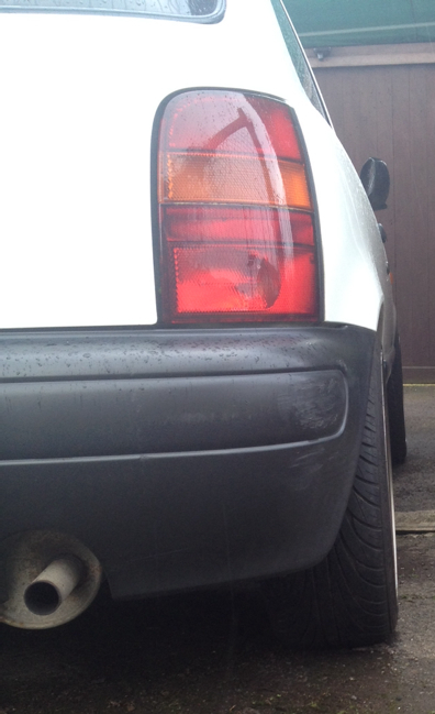

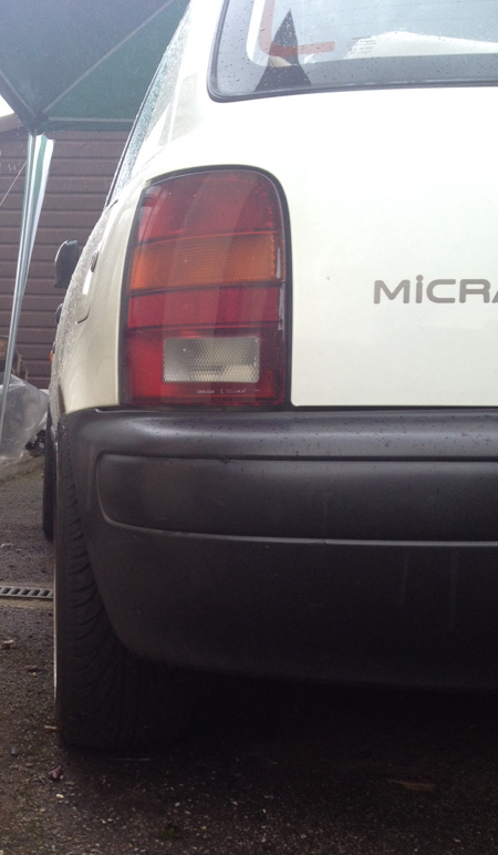

by altering the whole suspension geometry with lower static ride heights, different shock geometry, different wheels and different tyres, the rear axle/tyres are more likely to be:
- off-center which affects alignment (crabbing/pulling/handling) and tyres may foul the arch
- hit the arch at the suspensions highest travel/loading
adjustable rods/bushes allow you to shorter the pivot ends of the rods to ensure the wheels are equal distance away from the reference edge of the chassis (arch lip) so the alignment is straight and the tyres won't foul the arch.
