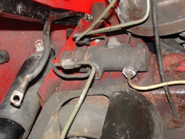

I ditched the valve on the bulkhead too. I always struggled at MOT time to get them to pass the rear brakes, the valve was stuck in a position that limited the pressure to the rear brakes.
The exact workings of this valve divide opinion, it is supposed to help if one braking circuit fails, given mine seemed stuck I'm fairly sure it wouldn't have helped me.
Keith Calver always recommended removing it, and fitting a reducing valve on the rear circuit. my car seemed fine without a pressure reducing valve fitted.
