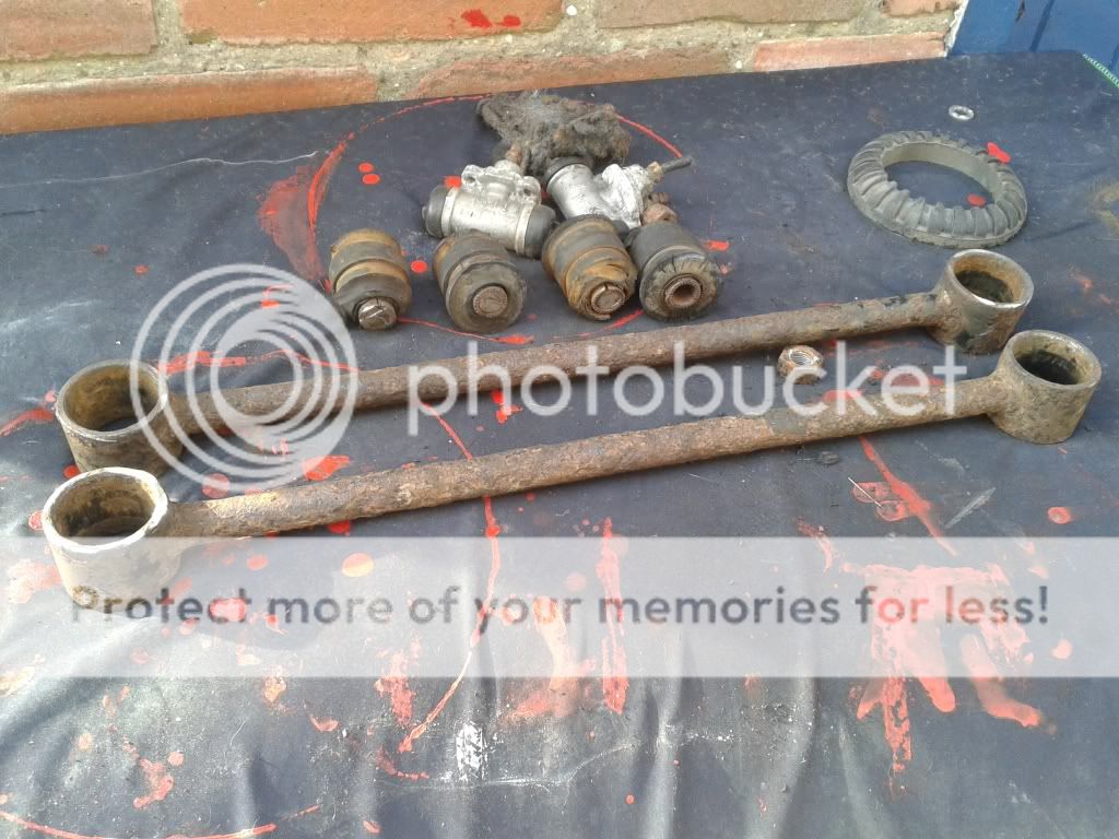

They should pull out. Unfortunately you have what I had with my old tie rods.
They'll have to be cut out now bud
They'll look similar to those I'd say :)
