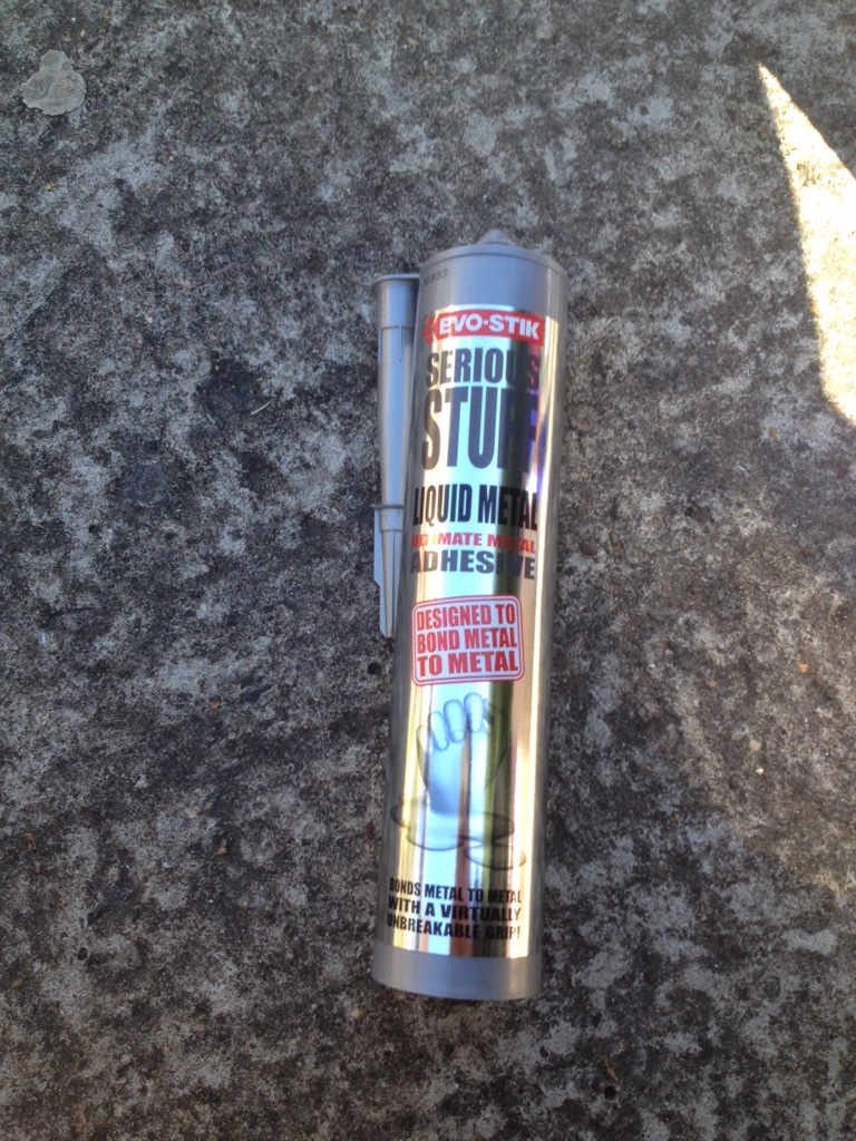

u can try this ?

ooh, k I'll get some in halfords tomorrow. wonder which one will bond/seal/flex against the oil leak the best? guess I just slap it on and see
That's all Chloe did bud it's 2 part harder and chemical...
Mix up slap on forget.
