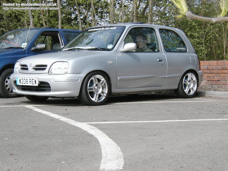

got my d2's fitted and loving it lol:love: shame the camber's nacked the inside my toyo's :( let me know what you guy's reackon?

not bad :)
aye your gonna have to watch your tyres...they'll get eaten by the wings if youre not careful...once i get some proper wheels for mine theres a pic going up as ive got d2's aswell :D

aye i know that meaning for the shocker nice! (Y) lolol, but i couldnt tell you the connection it has with jap cars loads have em i jus thought it looked cool, i got the damping hard as hell to save scrubbing its quite erm *harsh* like no suspention at all lol its down all the way on the back with the adjusters in i think i could squeeze some more without the adjusters in tho, just need to sort the tire issuse do you reacon im gunna need camber bolts to corrct it? i would love to see your car when its done solarice gunna be lush!,
you and me both Blake, lol one day it'll be done...one day. :)
The front shocks have camber adjustment built into them, so you'll get some movement...youd have to unbolt both the hub/strut bolts and then push it back into itself (if you know what i mean) mine are set for maximum camber ( wheels like -> /--\ )...the struts seem to have about the same adjustment i had with the whiteline bolts...incidently the whiteline bolts dont work with the struts as the top bolts holes are ovaled out...
and its advised to use the camber bolts in the bottom only if racing, which im taking means an increased chance of ######ing somthing, lol :D

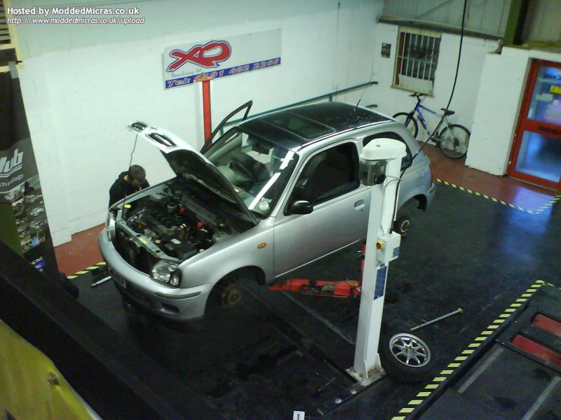

yeah it is in and working sammo and looks ace, i asked about prices for a power run there £45, but i also asked if we were to do like a club day the prices would be cheaper 10 people or more we would get it for £35 iirc i would be up for that in the 1.0 wonder :grinning:, ok solarice thanks for the advice gunna have a go on sunday for new tires hopfully on monday. Blake
With regard to the mention of the rolling road, be aware you may have clearance issues depending on which rolling road they have.

thay can defanetly go lower rob, i may drop the back at the weekend i will get some better pics for you to have a ganders at, :upside:
yeah 15's thay look bigger with the drop its decieving :suspect:,
