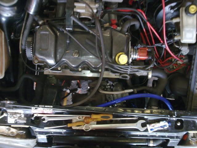

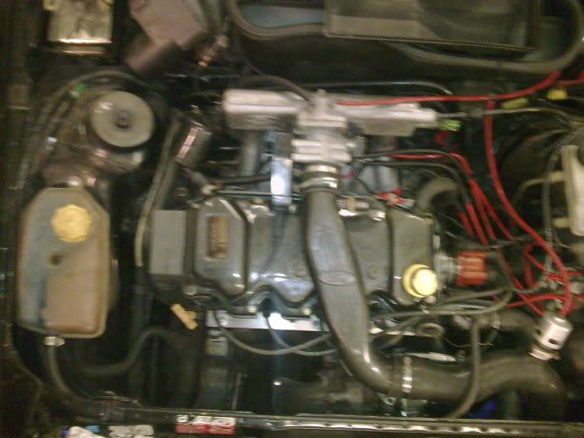

Well got some progress done today. The old CVH is out! BYEEEEEE
The new RS Turbo engine is in, the RS Turbo loom is pretty much in (a few cables to connect and some wiring to the dials (rev, oil sender, some earths)
The turbo and manifold are connected, radiator and intecooler are in place. Distributor alternator and starter motor are all in place, a lot of the water plumbing is done, some of the turbo piping is done.
In no particular order, here's some photos!

Little update tonight.
Charge carrier is now fitted onto the correct rocker cover, a mate helping fitted the wrong one. hehe.
Also the dials have been removed as my friend is coming to finish off the wiring for me, connect the rev counter, oil light, ignition, etc.

Well a little update.
I blew the turbo up, my friend who knew about the engines (yeah right) set the turbo up incorrectly and I was running at 1.4 bar....whoops. lol.
Well I now have a new turbo, and have done my research and have the engine running at a reasonable 0.6 bar. Ford state as standard 0.45-0.55 Bar. So i'm pretty much there. I have installed the bailey dump valve. Have just got some red silicone tube to replace the blue/purple one.
I have some new rear shocks to install as well as Escort RS Turbo brakes. Discs are slightly bigger so should help with my braking. Here's a few camera phone pictures of the update. Have also replaced the alloys with ford 7 spoke alloys (same alloys as used on the series 1 rs Turbos)
Will also be replacing the horrible red fuel lines with braided fuel lines!
