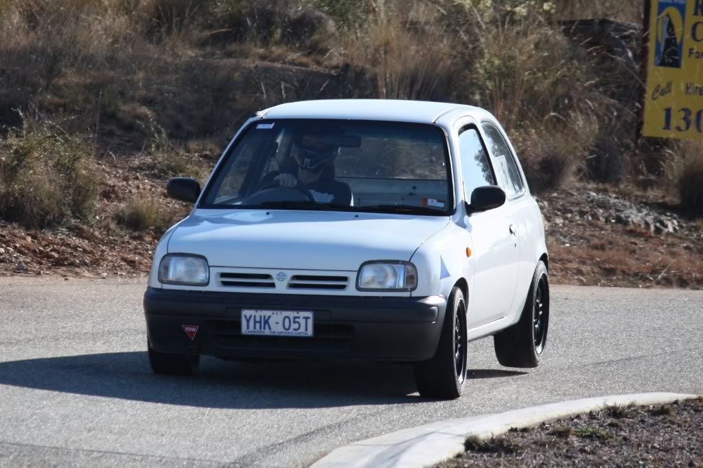

Hi All,
Ive been around for a while, and owned an slx for a couple of years doing some minor mods to it. Ive always wanted to get an lx (lighter and better for my needs then a super s), and last month I finally found one in Melbourne that looked like this...
http://i1232.photobucket.com/albums/ff368/climberjoel/IMG_1040.jpg
http://i1232.photobucket.com/albums/ff368/climberjoel/reardisks.jpg

thanks darthpunk, full photo credits go to my girlfriend though! id always wanted a white one, and its living up to all my expectations!
ndxxx ill make sure i keep measuring what i do and posting - the amount of help ive gotten from old posts in this forum makes me hope i can put something back.
Also at the recent hillclimb i got a pb of 53.63 (making all the mods all the more satisfying!), although fellow forum member tyrie is keeping me honest with a 55.45 with nothing but 185/55 semi slicks!
motorkhana on the 3rd should be sweet!
