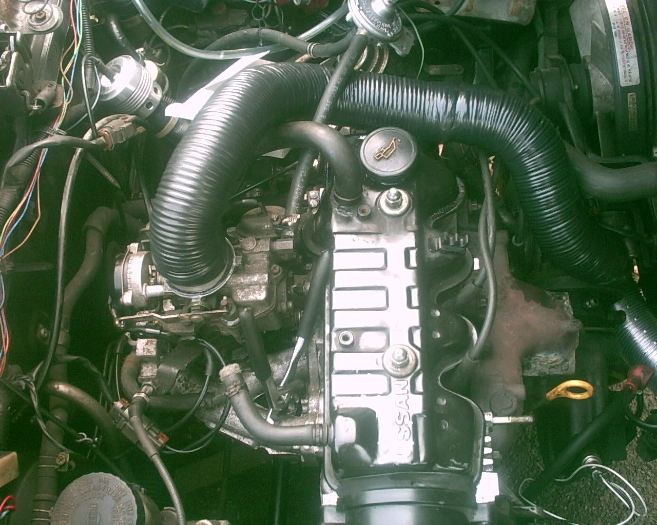

I now have cbr carbs to fit as I have a spare sr20det plenum I may mod that to fit the trumpets inside for when I boost it!
you also need a fuel regulator as cbr600 carbs are gravity fed from standard and any standard pump pressure will make them leak through the jets
i have no idea on them ones, but they need to regulate the fuel pressure to about 1psi or so. on the filter king regulator you need to set it to the lowest it will go. IIRC swiftmini is gonna use one of them Sytec PRO-FLOW on his k10.
I'm gonna change the headgasket and cambelt too as I'm not sure on the condition of either as I bought it from a scrap yard! It'll be easier to work on the head with it removed anyway

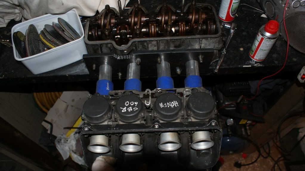

what carbs have you got? Theyre not cbr600 ones. but if bike carbs are simular, you will have:
fuel in
diaphram breather
And maybe a fuel return (if theyre pump fed)
Also since your using the k10 ignition setup theres no need for a tps so just ignore it
They are cbr600 fy carbs they are pump fed mate yeah using k 10 ignition so that's a relief! I'm thinking of cutting the old inlet off but leave some of the manifold so these can slip on. Or is that a crappy Idea?

unless later cbr600's (dunno what age carbs mine are) went to fuel pump. the carbs ive had hated any ammount of fuel pressure. I dont understand what you mean dude, can you take some good pictures of the carbs and stuff so I can help :)

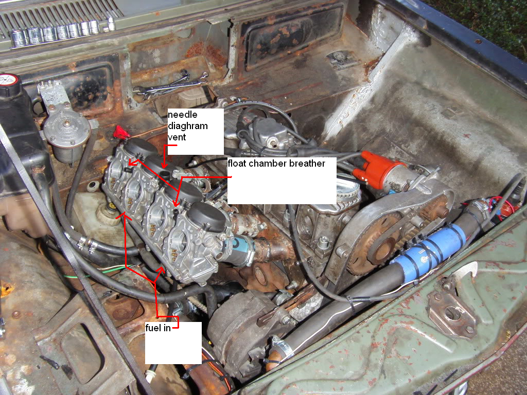

sorry for the late reply dude, the top picture are the vents for the throttle needle diagphrams, the 2nd picutre are the float bowl breathers (these might be returns if yours did come off a bike with a fuel pump) the 3rd picutre are fuel in but I have no idea on the 4th.
So the vents can just be left to vent to atmosphere? Theoretically the returns can just plumb into the k10 return?
