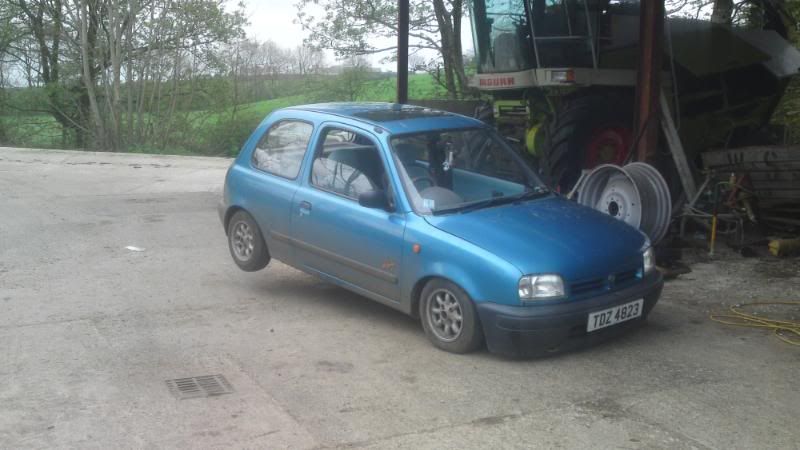

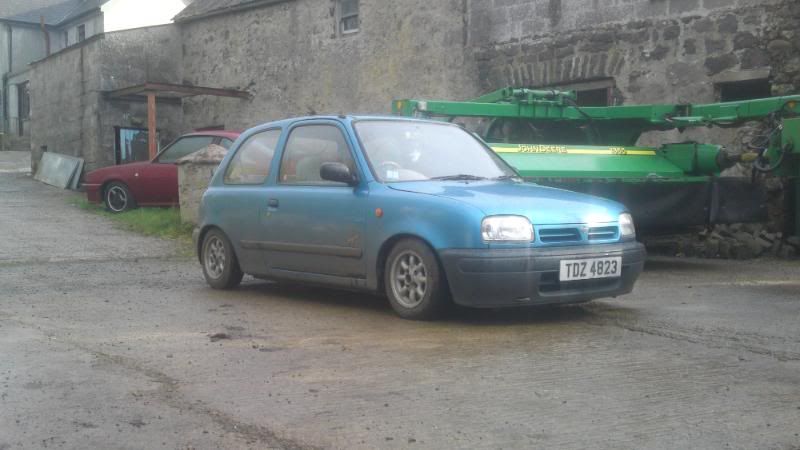

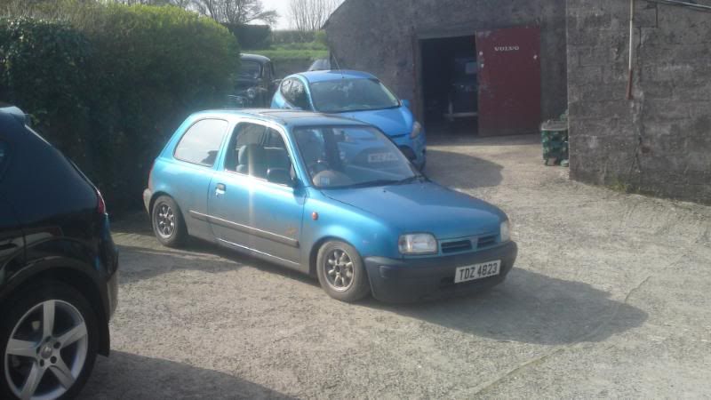

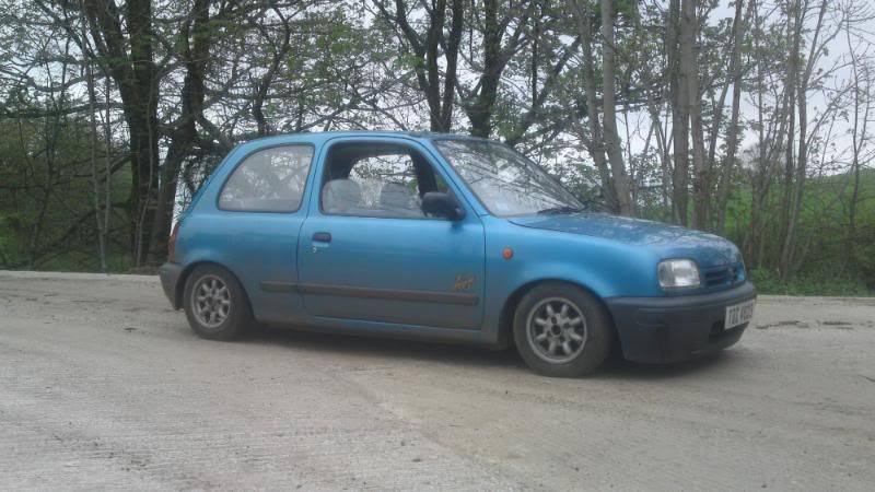

Just a we heads up on the micra, Have fitted mini coilovers into the rear now and the car is sitting level with lots of adjustment left, the coilovers are basically screwed fully up.
yea they are a straight fit, only thing i had to change was a smaller bolt (m10) for the bottom mount onto the axle as the originally bolt will not fit through the bush in the coilover. Undercarriage scrappage is a bit of a problem but as long as you keep an eye out on where you are going its ok
I used Gaz adjustable coil overs which i had for some time, will need to get new springs for them as they are coil bound and very stiff. apart from that they are a good job, considering 13s with a dish. any suggestions?
