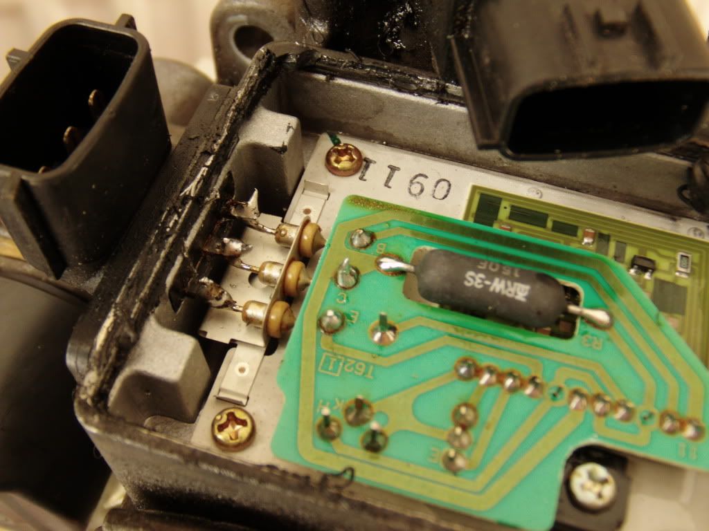

could be the common throttle body dry solder problem, much more likely to break in the cold too, so worth looking into

Back on subject the solder joints up close will have a hairline crack it will be circular and look sort of White not massively noticeable until you look really close or use magnifying glass
