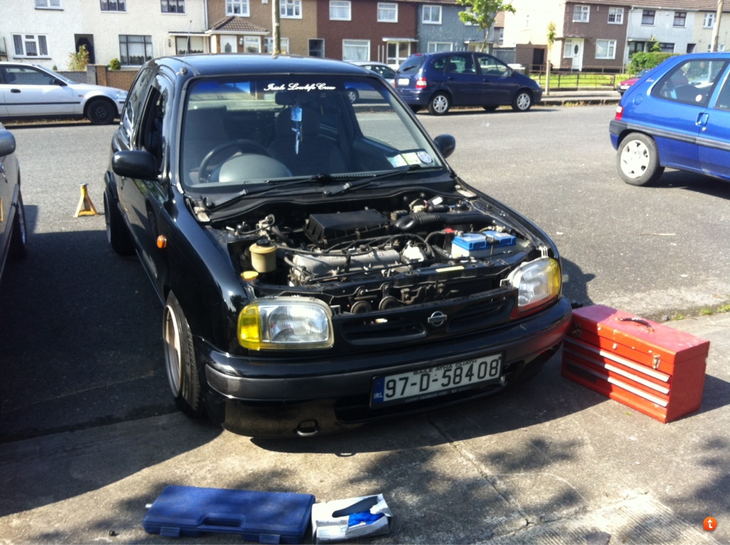

Started mine yesterday just need to finish it of today put back mount on an give it a service oil etc took this before I started stripping everything :)
Just a little bit of advice for people doing conversion, if you put a march 1.3 engine into a micra you will have to change the coolant sensors around as I ran into this problem my temp gauge just kept flying up into red but it's all fixed now, serious difference in power from the cg10 especially with 1ltr flywheel an gearbox ;)
