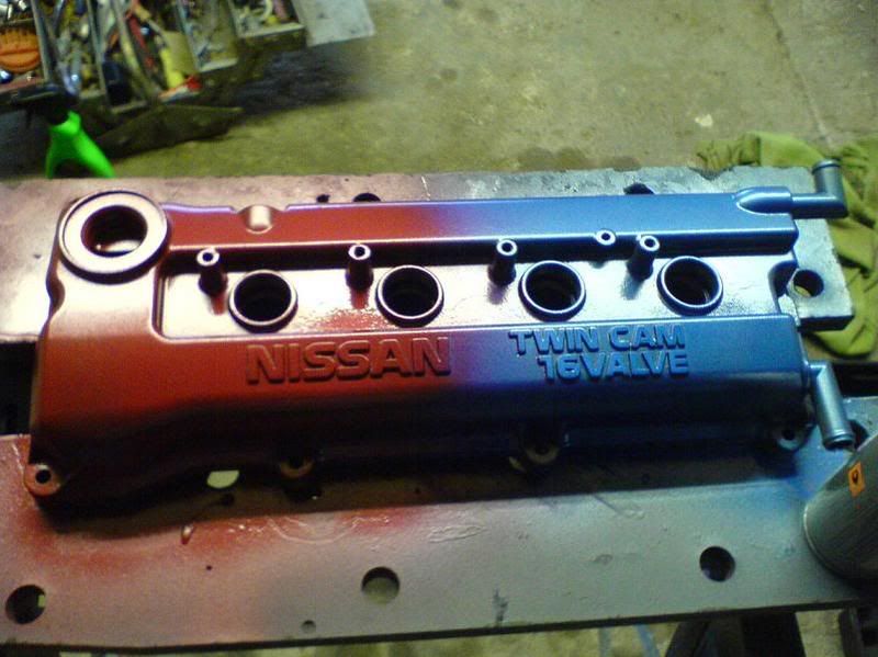

Cam cover.
Right think this the right section, been busy today but managed to get this done. What do you think shall i rub the lettering down??
yes thats a coilpack rocker cover, the parts that the coil pack bolt goes in to you want to take back to metal as the coil pack uses it for a earth if you look on the bit around the coil pack its bare metal where the bolt goes through
Thanks for the heads up, always wondered that!
